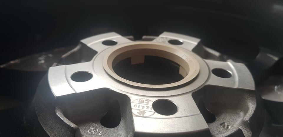

Although the rings are marked with the correct inner 56.1mm bore and the correct outer 60.1mm the issue I have is the tapered section is too tall and therefor sits proud on the face. See pic.

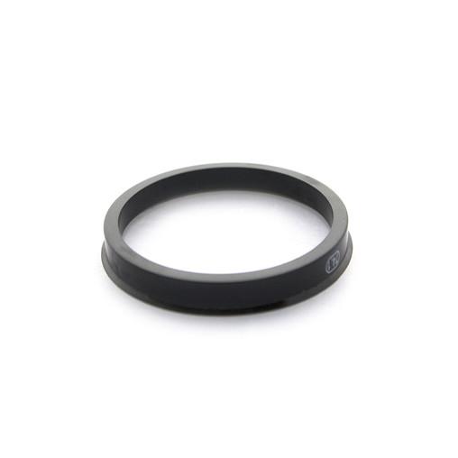

I have since rang six companies advertised on the net and they all only have the same beige rings in that size.  The only one that looks to be ideal (shorter tapered section) is the black one, (pic below) found on a French site but they have no stock!

Looking at your pictures they look like plastic spigots and they only appear to stand 1-2mm proud; do you think if you put them on as they are anyway they wouldn't compress a bit or move inward under the torquing of the wheel nuts?
