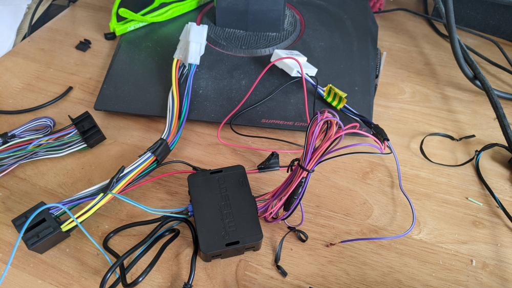

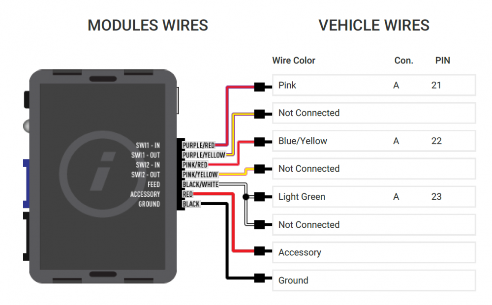

castroneves 6 Report post Posted May 25, 2021 Update incase anyone else comes up against this. I've cracked it by using a iDatalink Maestro SW, did have to ship from the US, but from amazon.com it's still quite reasonable. https://www.amazon.com/dp/B00J4W10XG Pretty straightforward to wire up. I used the Connects2 harness and just cut the plug off that would be for their SWC interface. Anyway, works like a charm and is even re-programmable, should you want volume up to map to volume down 😂 1 Feemono reacted to this Share this post Link to post Share on other sites
