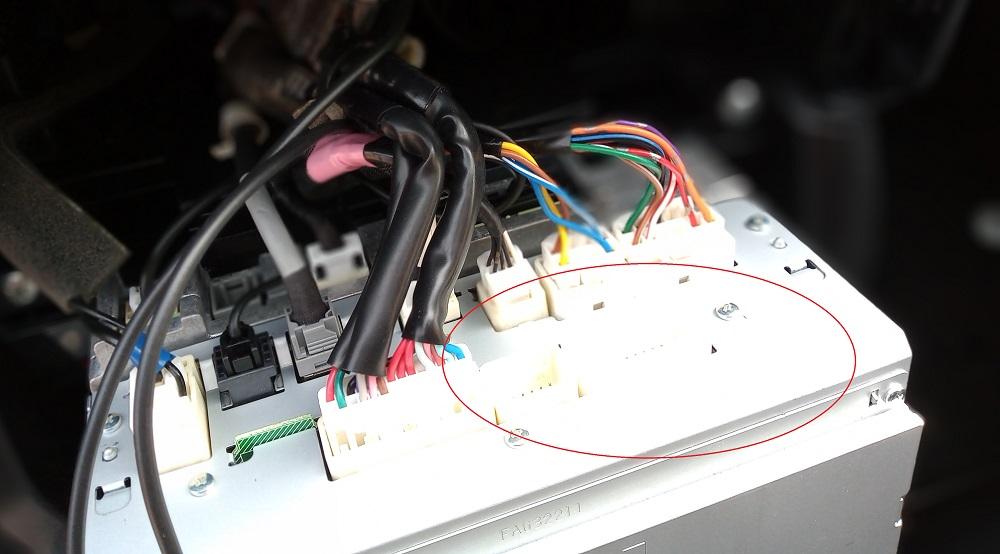

I've taken the head unit out and checked all the wires going from usb to socket to the head unit and the white socket connected to the dash at the rear of the head unit and all seems fine.
There are two empty sockets on the rear of the head unit (circled - sorry about the glare).
Should there be something plugged into them?

The 2 sockets are for the sat nav attachment. The usb connector is the grey one 3rd from the left.
