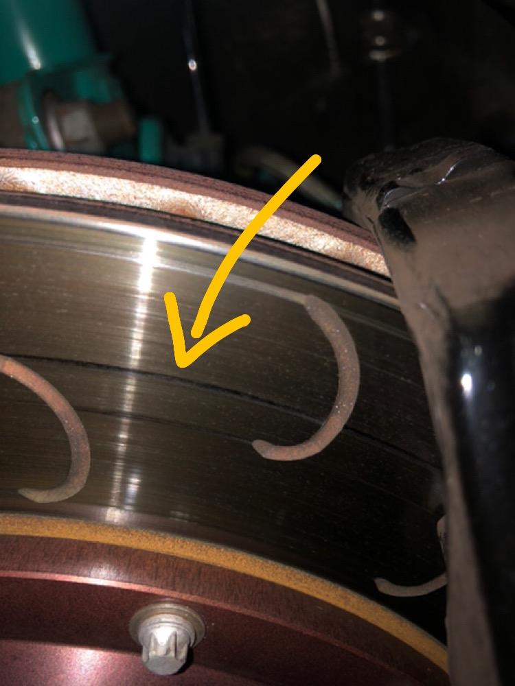

Rich196 103 Report post Posted January 8, 2021 1 hour ago, choupolo said: What problem did @3782mc have with the J hook grooves? Thanks for the list of pads, very useful. Second that? @will300 can you elaborate? I have the Reyland kit, with Reyland J hook discs, and I don't believe I have had an issues, but I would be interested to know. @Deacon does this mean Reyland do their own disc with curved veins now? While we are on the topic of discs, I went with floating. If I was to do it again I wouldn't, at low town speed they rattle, even with anti rattle shims, but hey race car right?🙄 Braided lines, I choose to fit goodridge ones I had kicking around and not the ones that came with the Reyland kit this was only down to the fact the Reyland lines had no mounting bracket that goes on to the bottom of the shock, no other reason. Overall I am very happy with the kit, simple to fit, and has resolved the issue of getting through discs and pads at a silly rate doing track days on the OEM callipers. Share this post Link to post Share on other sites
will300 810 Report post Posted January 8, 2021 Assuming @3782mc doesn't mind me sharing this, he was getting irregular wear on the discs and they were leaving noticeable groves on the rotors, ones you could feel. 1 3782mc reacted to this Share this post Link to post Share on other sites
Deacon 1357 Report post Posted January 8, 2021 30 minutes ago, Rich196 said: Second that? @will300 can you elaborate? @Deacon does this mean Reyland do their own disc with curved veins now? It does Share this post Link to post Share on other sites
Rich196 103 Report post Posted January 8, 2021 2 hours ago, choupolo said: What problem did @3782mc have with the J hook grooves? Thanks for the list of pads, very useful. Interesting! I might have seen a bit of this when not used HARD for a while but Iv never run my finger over it to feel, I assumed this was down to be running a pretty aggressive pad. Ill keep and eye out, I have only put a small grove in my discs when running my pads to low and the hangers were contacting the disc. Do we know what pad he was using, and if he tried changing the pad to resolve this, as isnt pad deposits usual due to compound and what kind of temperature window you use them in? 3 minutes ago, Deacon said: It does Ah nice! Thanks for highlighting this, I shall bare it in mine when I need new ones! 1 Deacon reacted to this Share this post Link to post Share on other sites
