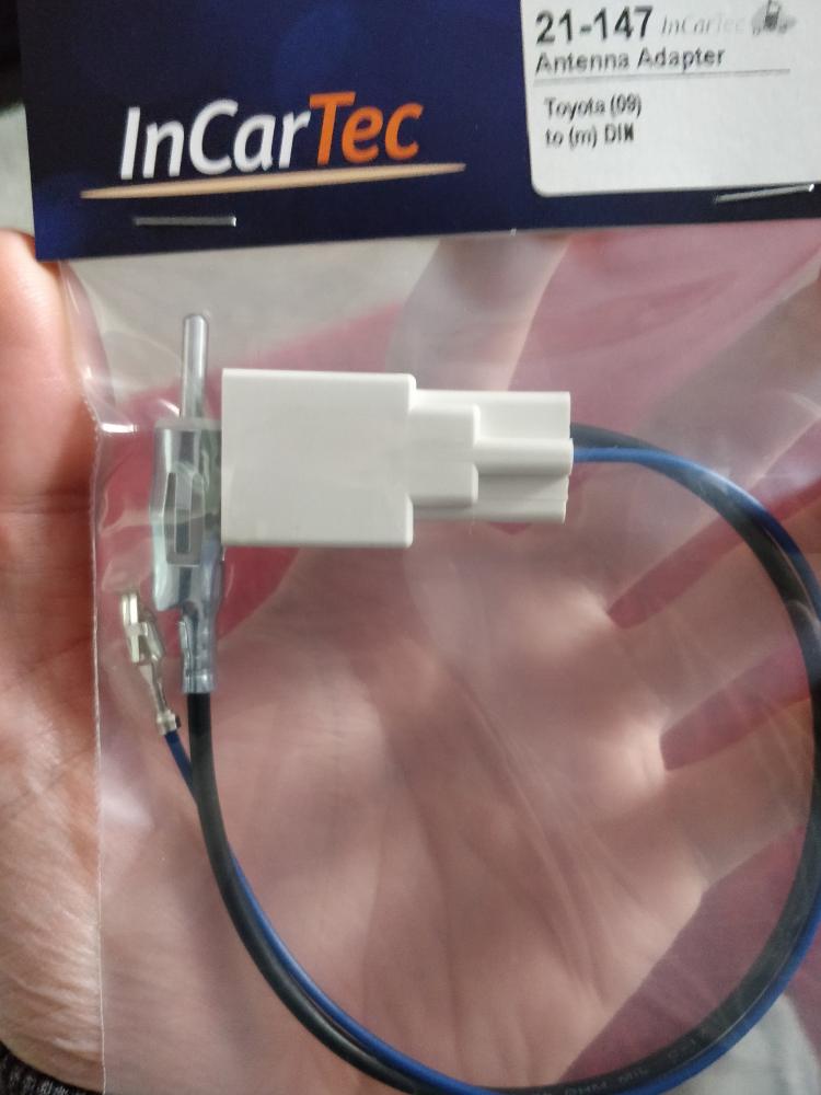

Anyway, question for you guys who've installed a stereo - what is the small flylead on the aerial adapter for? Where does that go?? Hard to find any information online, I'm guessing it's either a ground, or +12v to amplify the aerial?
