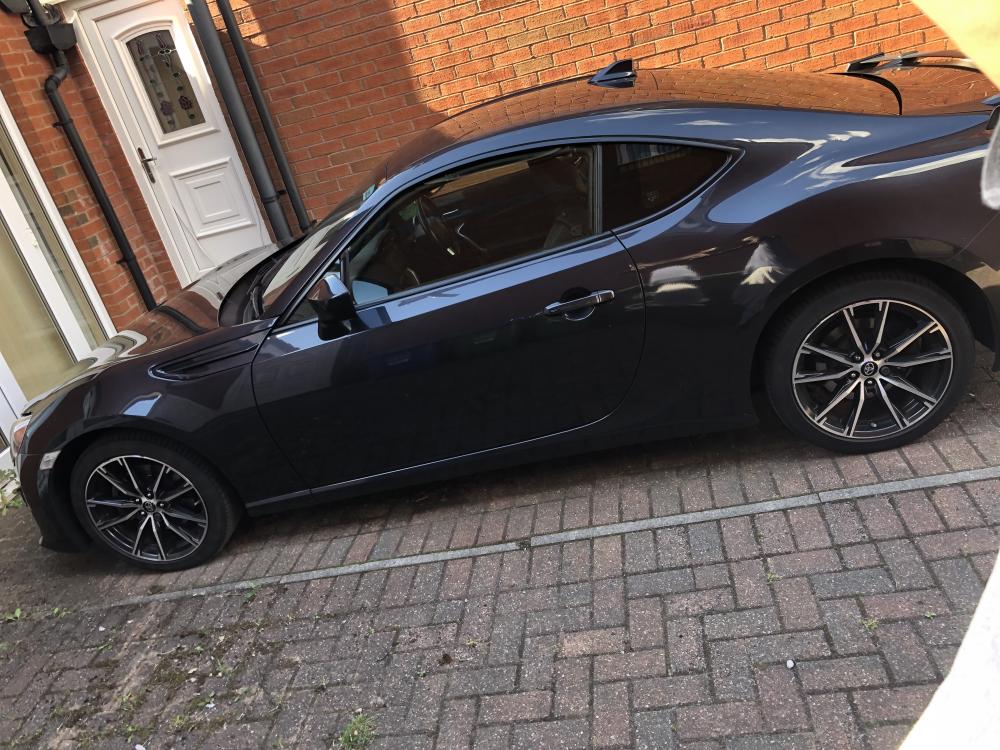

For now here’s my stock apart from EBC pads GT86.
Looking forward to meeting you guys (once lockdown is over!)

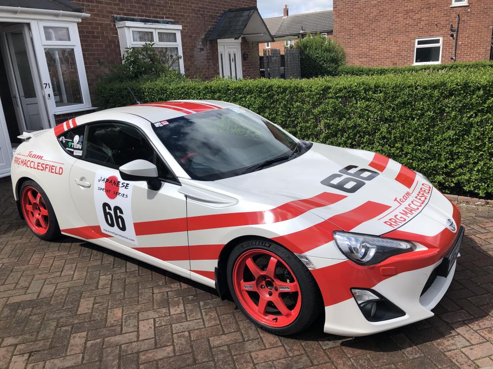

Ah nice car man. I was looking for photos of how it might look. Does not disappoint!
How does it feel to drive compared to stock?
Edited by choupolo
Mine are 18s on PS4, I find it far more responsive than it was on the Primacies, also feels like the ride quality is better. I'm not a great driver by any stretch though so it could just be placebo.

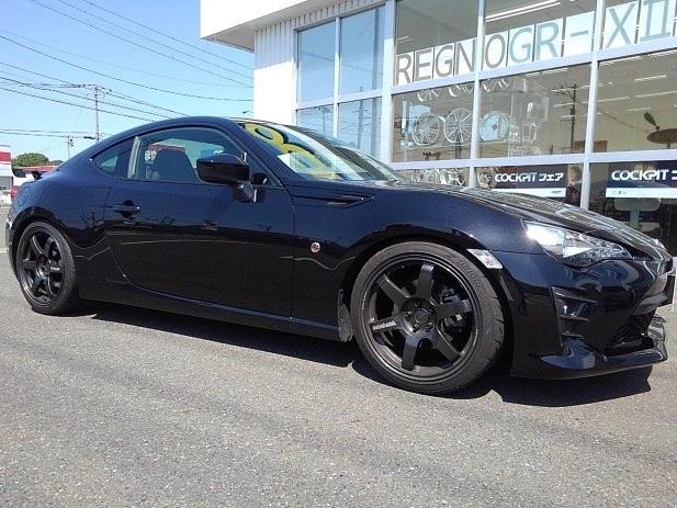

Guilty secret - I'm usually a function over form kind of person and will probably stick to the lighter TE37SL 17x8.5s, but is it bad that I really want the 18x9.5s for the concavity and wheel arch fill after drop? Some of the pictures look soo sweet! There are 17x9.5s but not with 5x100 holes and usually some crazy offset.
This for example would be just perfect! 17x9.5 et 36 5x100 but was custom made at the time I believe.

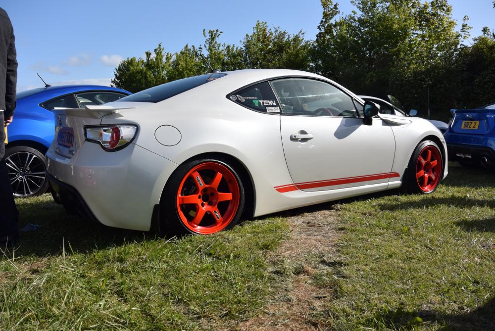

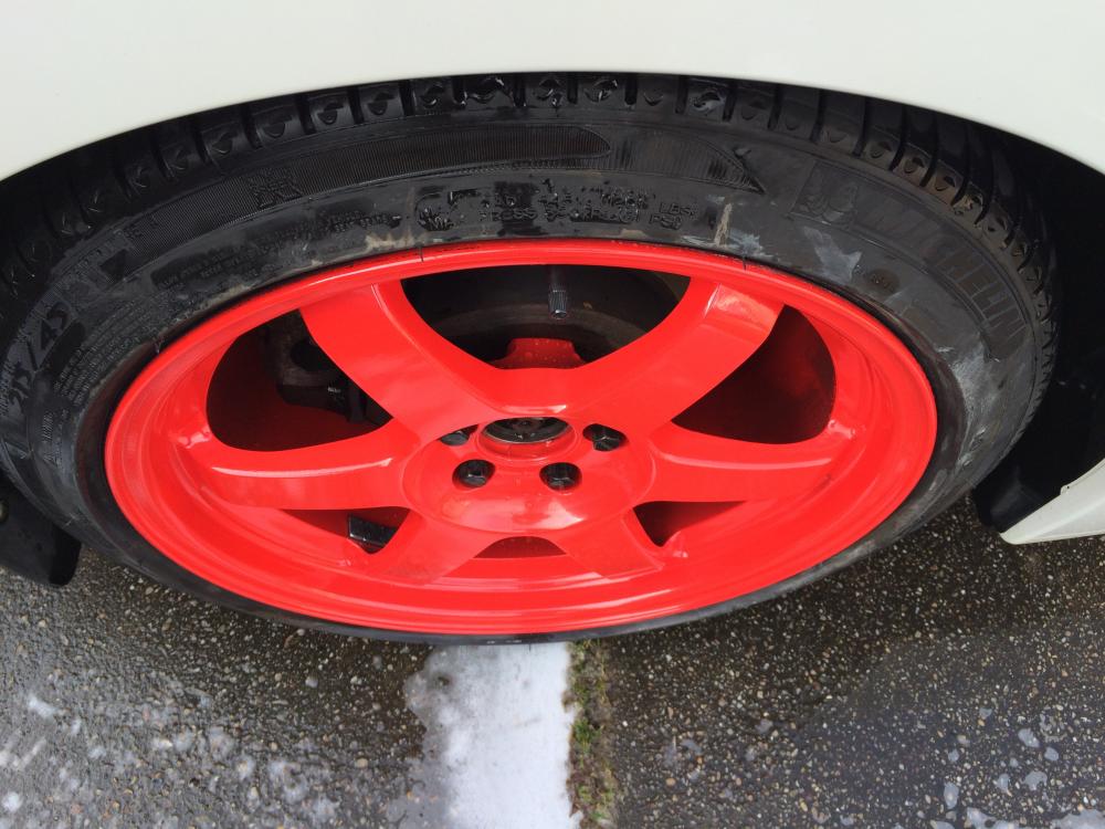

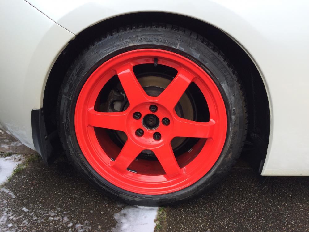

It took me a year or so to find my secondhand TE37 17x8 as you cannot buy them in that size anymore. It was a long wait, but when they came up I jumped on it. It can be done, but well worth putting the feelers out. Mine came from a friend of mine, where I first saw the wheels on his GT a year earlier. Advantage is I paid £575 for them and with £200 for a refurb, they'll always be worth what you paid for them. They are rare though!
I fancied the fatter wheel too so can fully understand that, there's a guy running them on a grey car in the US and they look perfect - this is from the ft86club.com forum:
In the end I decided to stick with function so went with the 8.5 to keep a sensible tyre size.

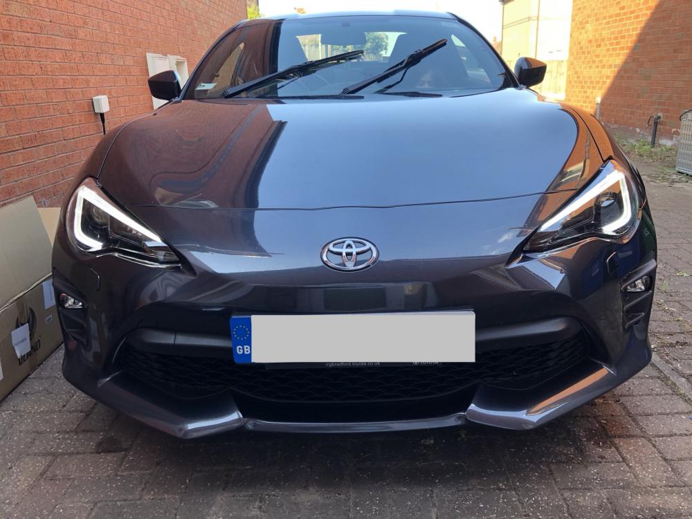

Install pictures: Lights (in progress)
VLAND fronts - easy to do, plug and play for the GT86, no splicing wires etc. Only issues were plastic rivets are annoying, bit awkward taking off side markers and headlight washers when removing bumper but easy enough, forgot to buy headlight bulbs! Also battery died after for some reason - needed a jump start and was then ok. Weird, dunno why that happened!
Unfortunately if you don’t like sequential indicators, this has them and from what I know can’t be changed back to normal. They look good though and work as expected.
After a lot of reading decided for bulbs to order this VLAND D2H type Xenon HID kit: https://www.amazon.co.uk/VLAND-Conversion-Projector-Headlights-Compatible/dp/B0824KCCB1/ref=pd_sbs_263_6/257-5133188-2434939?_encoding=UTF8&pd_rd_i=B0824KCCB1&pd_rd_r=702fc2ef-2475-4355-86ec-fbe8085fe008&pd_rd_w=4ZVsy&pd_rd_wg=H4PXC&pf_rd_p=2773aa8e-42c5-4dbe-bda8-5cdf226aa078&pf_rd_r=GZT2N5BV3Z0PTS9NRT69&psc=1&refRID=GZT2N5BV3Z0PTS9NRT69
...mainly for ease of installation. It all plugged in easily, no rewiring. Bulbs and kit could be upgraded for brightness if needed. Need some 3M sticky pads to mount the 'ballast' module that is part of the kit.
Overall impression - easy to install, looks nice, not as high build quality as the OEM headlights to be fair but I'll keep them this way for now. Not for people who don’t like sequential indicators.

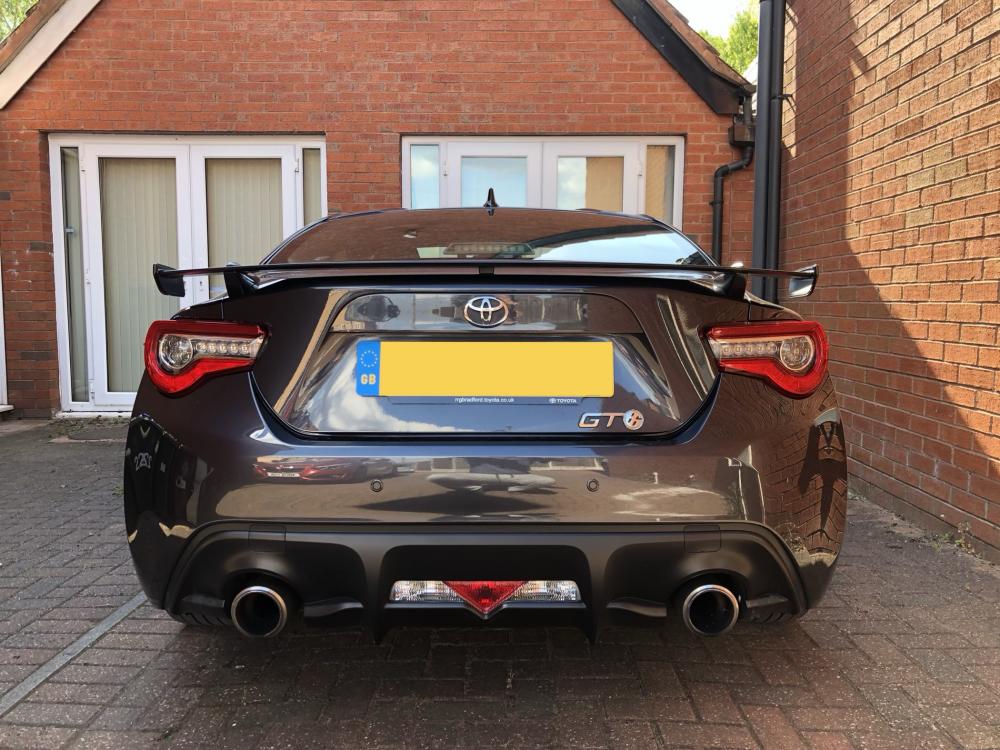

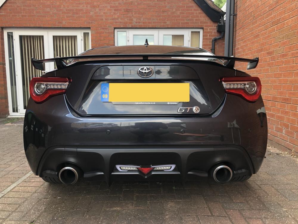

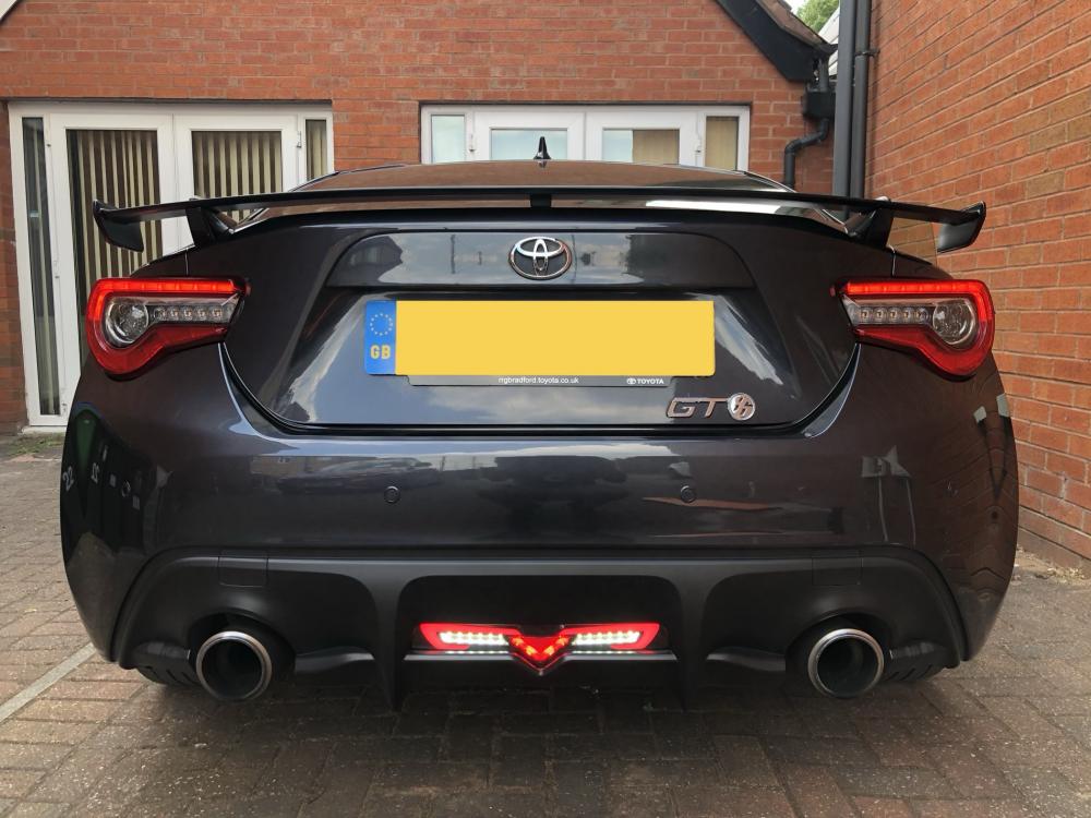

VLAND rear lower bumper fogs/reverse/DRL:
This was much easier than I thought it was going to be. There are some videos of the Valenti rear bumper lights going in and it requires some rewiring. These just plugged in to existing plugs and worked straight away. Needed to jack the rear and undo a few plastic rivets on the bumper to get access to the light. Very straightforward - although there are no specific install videos for the VLAND kit, I could do a quick guide if needed. It was easy to figure out.
Overall - looks much better than the stock light, the red of the DRL is more pinkish than the red of the tail lights. Have to see how it looks with the new ones I'm still waiting for.
With fog light (red triangle), reverse lights (white) and DRL (red boomerangs) on together.

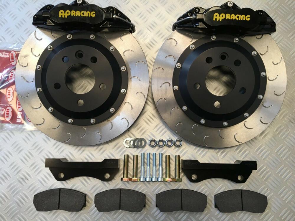

and Reyland AP 4 pot BBK
