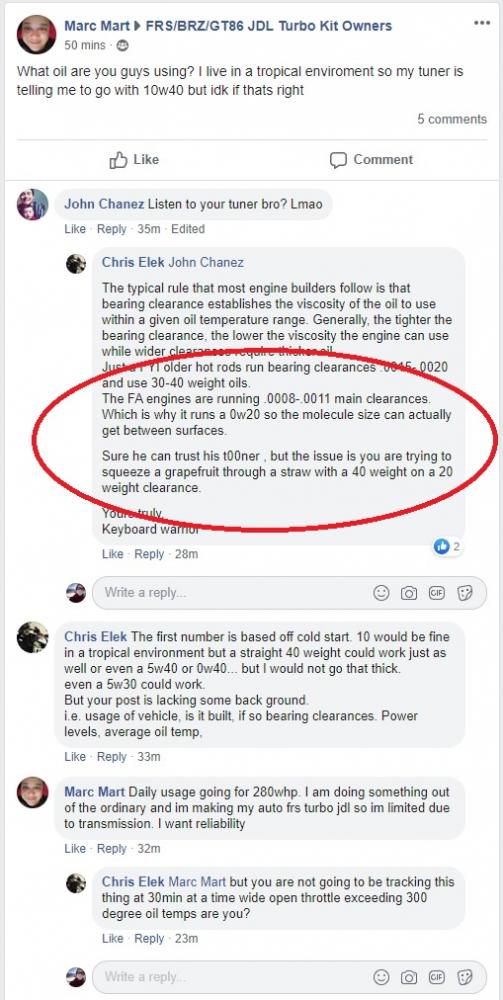

will300 812 Report post Posted April 6, 2020 This was posted on Facebook, which seems relevant (Chris Elek builds race engines, so he know's WTF he's talking about): 1 willclarke reacted to this Share this post Link to post Share on other sites
gavin_t 184 Report post Posted April 6, 2020 He may know his stuff but I am not too sure on what he is saying.... Is he basically saying as the OP gave no info on his spec and usage there is no right or wrong answer? but his oil choice is too thick and others are ok depending on the intended use.? In which case I agree if I only drove mine as a road car I would stick 0w20 in it. Share this post Link to post Share on other sites
will300 812 Report post Posted April 6, 2020 Sorry I was trying to highlight his comments on the oil weight used by Toyota/Subaru and bearing clearance. I've now circled this section. Share this post Link to post Share on other sites
willclarke 50 Report post Posted April 6, 2020 Interesting point. So if thinner oil is necessary there, but we don't want too thin to lose too much pressure with track abuse at high temps (with 0w20), would mean an oil cooler would be the best thing to do here to keep it at a certain viscosity range which would satisfy both arguments? (perhaps the 0w30 would also be a good approach to this) Sent from my Pixel 4 using Tapatalk Share this post Link to post Share on other sites
gavin_t 184 Report post Posted April 7, 2020 19 hours ago, willclarke said: Interesting point. So if thinner oil is necessary there, but we don't want too thin to lose too much pressure with track abuse at high temps (with 0w20), would mean an oil cooler would be the best thing to do here to keep it at a certain viscosity range which would satisfy both arguments? (perhaps the 0w30 would also be a good approach to this) Sent from my Pixel 4 using Tapatalk From reading that and @will300 pointer to the correct section he was referring to I read that as something with 0w is ideal for the tight clearances. But increasing the oil to 0w30 will give you higher temperature stability too so win win. And as 5w30 is in the handbook Toyota must be happy with this one too. But 10w40 as the OP put is overkill and too thick at cold to get into the tight clearances. 2 will300 and willclarke reacted to this Share this post Link to post Share on other sites
