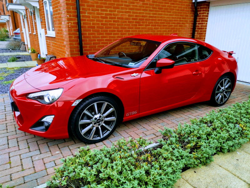

awood12345 4 Report post Posted March 16, 2020 I finally got one and I love it. I would like to add a reverse camera, videos online make it look easy but I can't find a kit for sale in the uk. Is there one? 3 Lauren, MartinT and Tweedbean reacted to this Share this post Link to post Share on other sites
mart86 9 Report post Posted March 16, 2020 Looks immaculate! There used to be kits available circa £120. But you can just buy a camera and the adapter separately and wire it yourself. Cost me £30 all in. I believe it's a 16 pin connector pre 17 reg for the stock head unit. And if I remember correctly it has to be Ntsc not pal. Otherwise its a grey grainy picture with stock head unit. If you're upgrading the head unit you won't need the adapter though. Share this post Link to post Share on other sites
awood12345 4 Report post Posted March 18, 2020 Thanks, it is in really nice condition, the tail lights fog I've noticed but the rest looks great. Is this the adaptor you used? It looks different from the ones in the videos on YouTube. https://www.ebay.co.uk/itm/Connects2-CAM-TY2-AD-For-Toyota-GT-86-12-15-Car-Reverse-Camera-Add-On-Interface/263685964134?hash=item3d64e88166:g:o7oAAOSwMm1a4ZIu Share this post Link to post Share on other sites
vanko25 70 Report post Posted March 19, 2020 That is the correct one. Bare in mind most aftermarket cameras require 12V where the output from the HU is 6v. I have used a DC-DC step up converter to boost the voltage from 6V to 12V when installing mine rather than taking 12V from somewhere and using a relay to switch the camera on when in reverse. Share this post Link to post Share on other sites
Tweedbean 151 Report post Posted March 19, 2020 Welcome, that looks very tidy 👍 Share this post Link to post Share on other sites
mart86 9 Report post Posted March 19, 2020 As stated above that is the correct one. The camera also has to be powered up before the head unit as I found out when I wired mine in with the reverse lights initially. Mine is wired from the 12v ant power behind the head unit with an in line fuse to protect the cable. Running 2 years with a cheap Chinese £10 camera with no issues. Share this post Link to post Share on other sites
Jay 37 Report post Posted March 19, 2020 Great looking car! Congrats! Share this post Link to post Share on other sites
