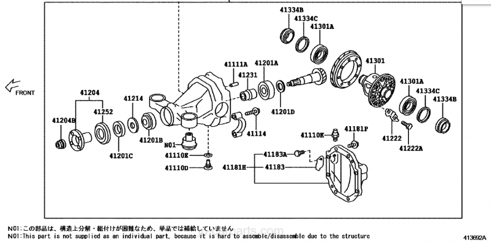

Adi 40 Report post Posted September 11, 2019 Does anyone know the part numbers or where to source the OEM differential front rubber bushes (also known as 'pinion mount' or "outrigger" bushes, not the rear ones)? I replaced mine with Superpro poly bushes and also having an MFactory4.65 final drive that whines, over time the NVH became unbearable on the road, especially at highway speeds. Now I am looking to put back the OEM rubber bushes but I can't seem to find a part number. One Toyota dealer said I would have to buy the whole diff casing, they don't sell them separately. Any ideas ? Or do you know anyone else that makes rubber soft (not poly) versions of these ? Otherwise I may have to buy a whole new diff. Cheers Share this post Link to post Share on other sites
vanko25 70 Report post Posted September 11, 2019 Adi, If there is a part number for that bush it will be on this graph. https://jp-carparts.com/toyota/partlist.php?maker=toyota&type=264110&cartype=20&fig=4101 Edit: Look at the bottom of the image. There is a comment that the front bush is not coming separately. At least not from the OEM. 1 Adi reacted to this Share this post Link to post Share on other sites
Adi 40 Report post Posted September 11, 2019 Thanks @vanko25 N01: This part is not supplied as an individual part because it is hard to assemble/disassemble due to structure. Any ideas? Share this post Link to post Share on other sites
