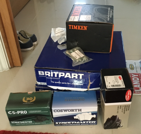

This lot turned up yesterday.  Gonna be a busy weekend.  My Son is helping so should be a good learning curve for both of us.
Fitted the pads with my 15 year old Son today, let him do most of it. Went well given neither of us had done a pad change before. No more sqeaking brakes! Thanks all for the tips and guidance. Gonna be a bit more adventurous tomorrow if I have time, I have new front discs/pads and offside front wheel bearing to fit on my other car.
