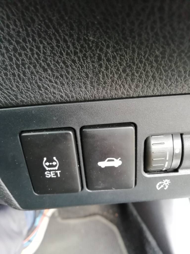

BRZ-123 174 Report post Posted April 7, 2019 The easiest way to find out is, move your valves from side to side. If they are flexible, no TPMS, if they are metallic and have no flex, they have TPMS in them. Like Kinghtyrider mentioned, MY2015 cars have it. Simple way of knowing that is also shark fin body coloured antennae instead of the black one, IIRC.@lauren As much as TPMS causes grief, it helped me once with a slow puncture on one of my tyres, where the pressure had gone down to 24. Because my dash lit up, I went into the next petrol station and checked all pressures and discovered the issue. Sent from my FIG-LX1 using Tapatalk Share this post Link to post Share on other sites
vanko25 70 Report post Posted April 7, 2019 The easiest way to find out if a car has TPMS is by looking for a button next to the boot open button. 1 Lauren reacted to this Share this post Link to post Share on other sites
Lauren 2259 Report post Posted April 7, 2019 38 minutes ago, vanko25 said: The easiest way to find out if a car has TPMS is by looking for a button next to the boot open button. Exactly! Share this post Link to post Share on other sites
BRZ-123 174 Report post Posted April 7, 2019 Like this. Sent from my FIG-LX1 using Tapatalk 1 Benjie_2 reacted to this Share this post Link to post Share on other sites
