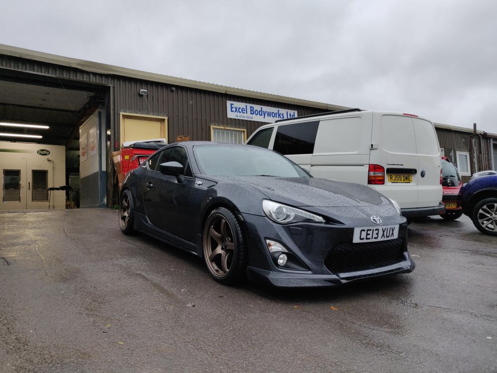

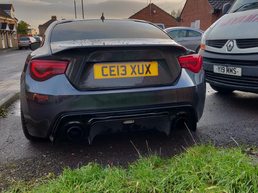

James18 50 Report post Posted October 26, 2019 Just collected the car from Excel Bodyworks in Radstock. Rocket Bunny V2 Diffuser fitted along with GReddy Gracer front lip also from Torqen and TRD side skirts from Fensport. Front lip and skirts have been painted with gloss black on the lower lips and in body colour on the upper parts. Works nicely imo - 2 spikyone and Deacon reacted to this Share this post Link to post Share on other sites
Deacon 1357 Report post Posted October 26, 2019 4 minutes ago, James18 said: Just collected the car from Excel Bodyworks in Radstock. Rocket Bunny V2 Diffuser fitted along with GReddy Gracer front lip also from Torqen and TRD side skirts from Fensport. Front lip and skirts have been painted with gloss black on the lower lips and in body colour on the upper parts. Works nicely imo - Looks fantastic James 1 1 James18 and Quball reacted to this Share this post Link to post Share on other sites

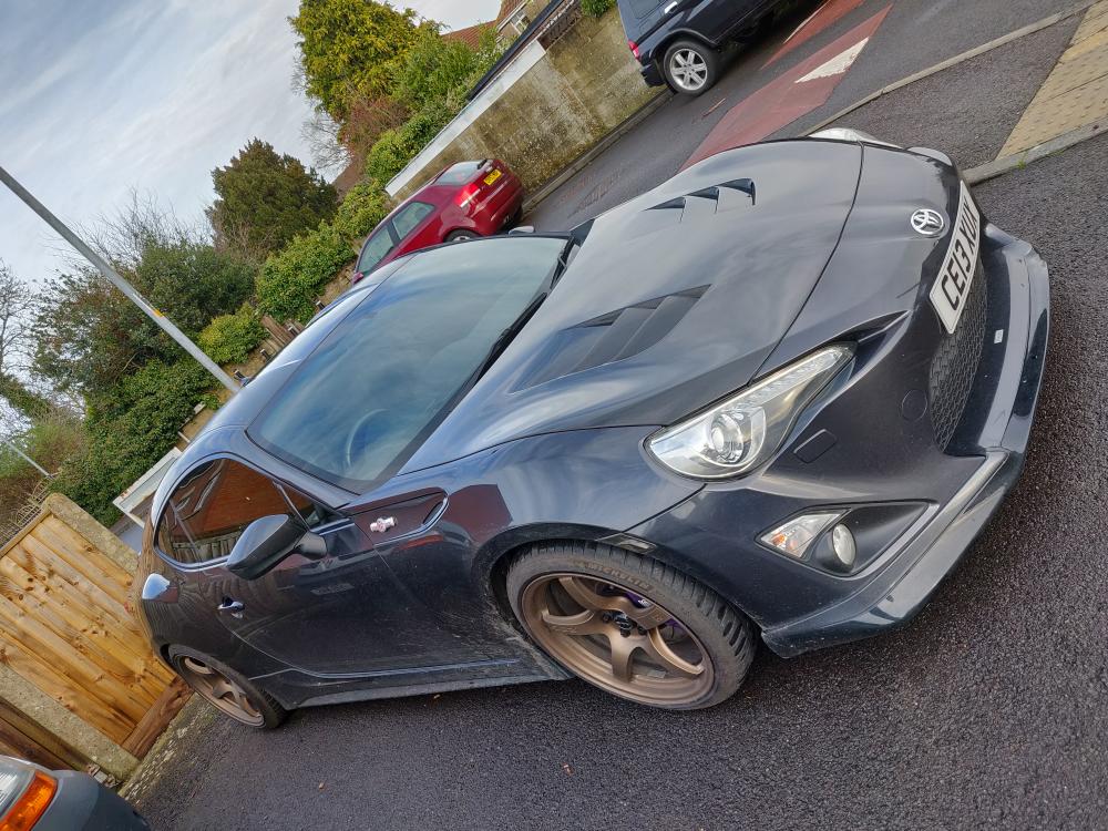

James18 50 Report post Posted December 21, 2019 Seibon CSL Style boot and Seibon TS Style bonnet fitted; 2 Deacon and spikyone reacted to this Share this post Link to post Share on other sites
spikyone 139 Report post Posted December 21, 2019 Looks great, I really like the CSL bootlid. Hard to tell from the photos - is it carbon or body colour? Share this post Link to post Share on other sites
James18 50 Report post Posted December 21, 2019 30 minutes ago, spikyone said: Looks great, I really like the CSL bootlid. Hard to tell from the photos - is it carbon or body colour? Thank you! It's carbon! Same as the bonnet. I am debating getting them body coloured, maybe if the clear coat fades at some point in the future... 1 spikyone reacted to this Share this post Link to post Share on other sites

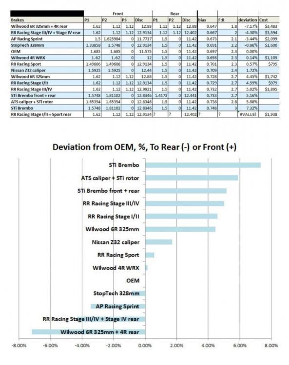

Notaricer 12 Report post Posted January 3, 2020 Does brake bias matter that much, surely if you’ve got a larger surface area in the front than the rear that’s perfectly fine? Thanks for the sources/links. Very helpful.Sent from my iPhone using Tapatalk Share this post Link to post Share on other sites
James18 50 Report post Posted January 3, 2020 15 minutes ago, Notaricer said: Does brake bias matter that much, surely if you’ve got a larger surface area in the front than the rear that’s perfectly fine? Thanks for the sources/links. Very helpful. Sent from my iPhone using Tapatalk On the second page of the link I attached there's a graph provided by @Deacon which shows you the percentages of brake bias effect from different, common brake upgrade options. I'll attach it below. As you can see, just the front STI swap is the worst. Whether it matters that much is personal opinion - I don't think until you get close to the top level of competing it's worth worrying about. Track days are just for fun after all - though you will always get track day heros. There's some great cars & drivers still running stock calipers around the world. Share this post Link to post Share on other sites

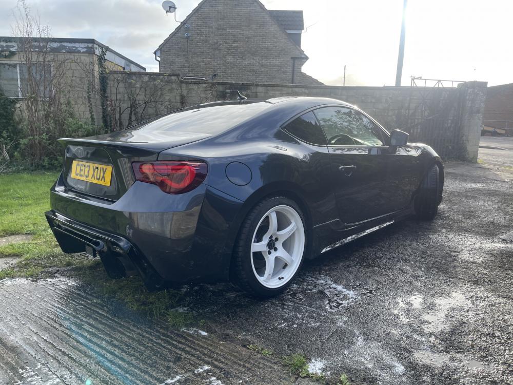

James18 50 Report post Posted December 21, 2021 I never got round to finishing my posts for this build and the car kind of fell behind some other projects. But as I’m now considering selling up for an upgrade there’s a final update on this post from me - potentially a big part out coming soon! Since the last post, after a trip to Autosport before Covid shut everything down, I ordered a Corbeau RRB seat with custom TRD coloured stitching which I am still to this day extremely pleased with. Daily comfort has not been sacrificed and the seat holds me in place just how I wanted. It also looks great. Schroth Rally 3 ASM harnesses in all black to go with if I ever got round to doing a track day (will be gutted if the car goes without ever seeing a track!) MOT time came around so I needed a fog light for the Rocket Bunny diffuser, I went with the FIA style light from Tegiwa and wired that in neatly, looks OK and cost next to nothing I also decided it was time for a colour change of my Rays, and went with the white. I was initially planning on going with the red spoke stickers like the Rays article on Speedhunters as that’s what convinced me to buy the wheels in the first place. But I loved the white with contrasting purple brake callipers so left it in the end. Finally, my HKS coilovers decided to piss the oil out of them after the car came out of hibernation post lockdown. Just what I wanted. So I went with a set of the tried and tested Tein Flex A’s from Partbox. I’ve loved every minute of owning this car, and will be sad to see it go when it eventually does, but I can’t help but feel I’m at the end of the road for mods without sinking even deeper and starting an engine build, and I’d rather put the money towards a new car. Thanks to all for your help on my 86 journey, it’s been an absolute pleasure 1 Deacon reacted to this Share this post Link to post Share on other sites
