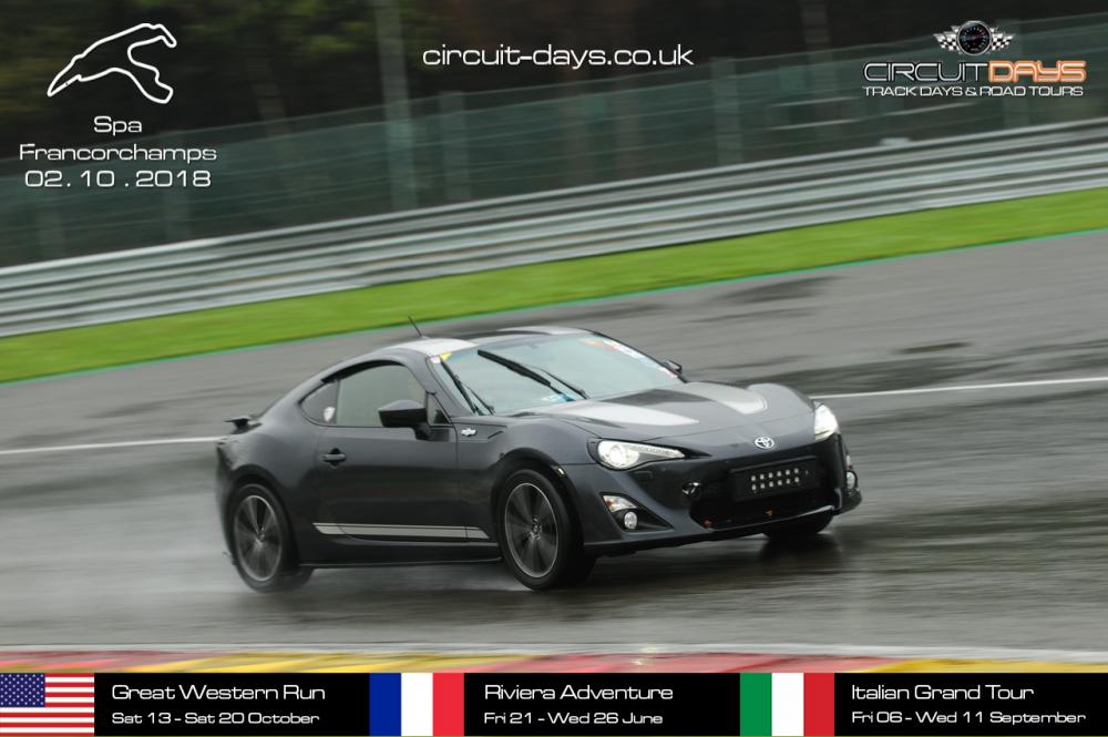

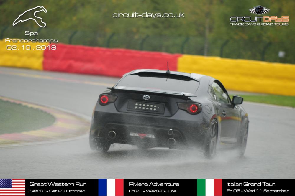

A couple of photo's taken at Spa last Tuesday..........
