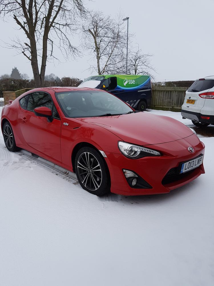

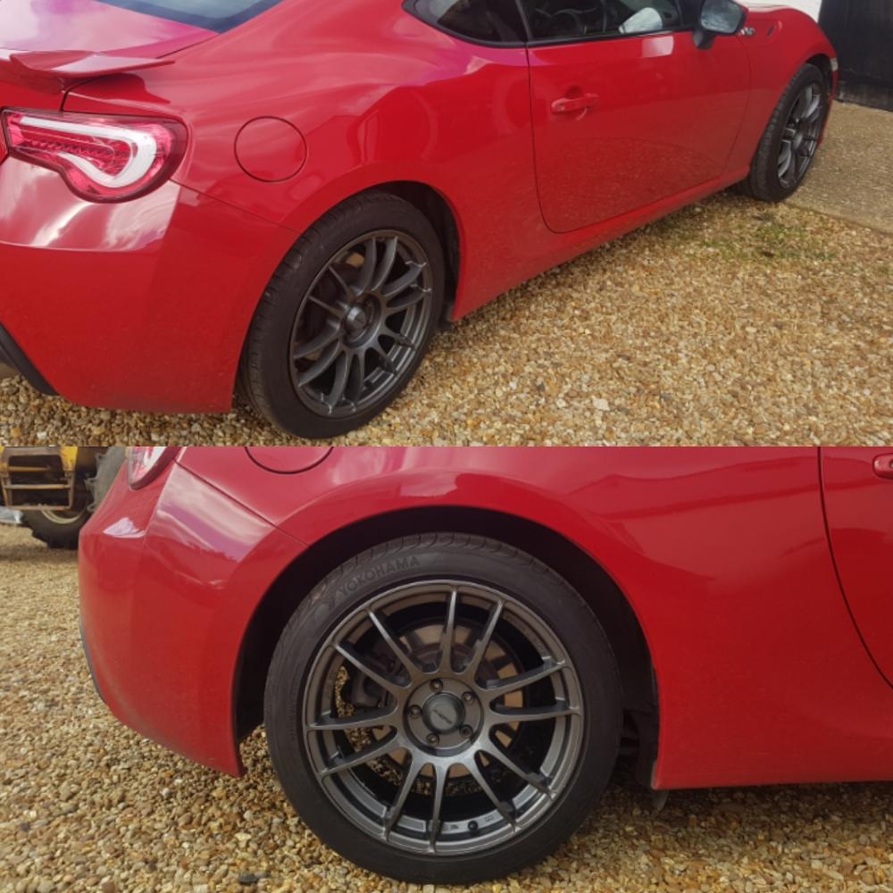

lewism1 8 Report post Posted September 22, 2018 Had my 86 for around 5 months now. Bought it at 49k miles for a good price. Spent a few weeks lurking on this forum working out what it is I wanted to do to the car and the list ended up totalling around £10k, so forget that. I decided to try do the things I wanted on a very small budget. First off was getting rid of the plates and adding jap style ones got them for £27. I also wanted to get a better sound from the car but didn't want to fork out hundreds on a new system. Got my hands on a miltek cat back non resonated for £120. Next plan was wheels but my clutch release bearing was making odd noises. Took it to fensport and they fitted a new clutch for £420. Not money I planned on spending but a new clutch made me realise just how bad the previous one was. Next up was the lights. I am now part of the 90% and have the valenti taillights. Got them from a forum member for £170. Probably could have got the same price or cheaper from overseas but didn't want to wait months and risk them not turning up. I also sprayed my badge black but not so sure if I like it now. Yesterday I took delivery of some Calibra Suzuka wheels. They're 7.5 with a 37 offset I believe, they're used and came with tyres with around 4mm tred on. Got them for £300. Now this is where I get a little stuck. I want to go lower but I live in fens and the roads are awful, so I really want to avoid going with springs. They'd suit my budget but I feel as if it's an area I shouldn't cheap out on. I've never lowered a car before but its something I've been reading up on, so I'm aware that coilovers would be the best option. Had a chat with the guys and fensport yesterday (they're 5 mins from my house!) and they recommended the Tein Flex Z. Coilovers are something I certainly can't fit myself, so I'll need to take around 6 hours of labour into consideration. Also, not sure if they're something I should buy used or not? Would appreciate some guidance on if so, and what to look for when buying. Finally, I do plan on going with the N/A package with tuning developments. I can get something similar from fensport but I'd like the dyno test and they are around 3 hours away and I promised the other half a weekend away soon so seems like an option haha! Ooh and, being a red car and the previous owner having bricks for hands - the swirls on my paint are horrendous. I have a friend who owns a detailing business who has offered to do me a paint correction at a discount but its still around £400. If anyone has any recommend methods to doing it myself without spending a fortune on equipment, please give me a shout. Share this post Link to post Share on other sites
MartinT 514 Report post Posted September 22, 2018 Very decent wheels and tyres for that price. Don't discount going for springs, they're cheaper but not lower quality if you know what you want. It just entails keeping the stock dampers which works for me as it's my daily and I need decent ride quality. If you're not going to track (I don't) then consider them as money is tight. I have H&R Super Sports. Share this post Link to post Share on other sites

Deacon 1357 Report post Posted September 22, 2018 For the coilover 6 hours labour seems excessive. The 86 suspension is pretty easy to change - somewhere that knows what they're doing should have it done in 2-3 hours. You'd then just need an alignment on top. 1 Mark-in-Stoke reacted to this Share this post Link to post Share on other sites
Varelco 211 Report post Posted September 22, 2018 You might want to do a bit more research on lowering springs. There are options out there that retain the stock comfort, there is no need for coilovers. Especially if it's just for aesthetics. Share this post Link to post Share on other sites

Lauren 2259 Report post Posted September 22, 2018 TEIN Flex Z is a good choice, Flex A is better though for the hyrdopneumatic bumpstops. I've been in a lot of GT's. I've yet to find one with lowering springs that feels right, though I haven't tried them all. The trouble is if you put lowering springs on it doesn't match the damping and the stock dampers are not that great. Spring rates on the TEINS are 6/6kg or you can go 5/6kg which is my spring rate. TD NA package is a no brainer and they have a discount on ex display stock at the moment. It's a bit of a bargain. 1 Angelina reacted to this Share this post Link to post Share on other sites

gavin_t 184 Report post Posted September 24, 2018 Looks good. I would take a look at some Ebaich springs. They give a modest drop and retain the oem comfort. Love mine. Drives nice on road and track and I have done things like the north coast 500 route round Scotland on some rough roads and found no issues I fitted them on my drive in 2 hours so a pro will have no problems in this time frame. Just got back from warrington with the other half. I got the NA package and she got a day out shopping in warrington and a nice lunch. Stayed in the ibis which was nice too and only £48 with all you can eat breakfast 2 Angelina and lewism1 reacted to this Share this post Link to post Share on other sites
