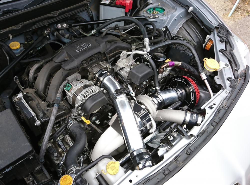

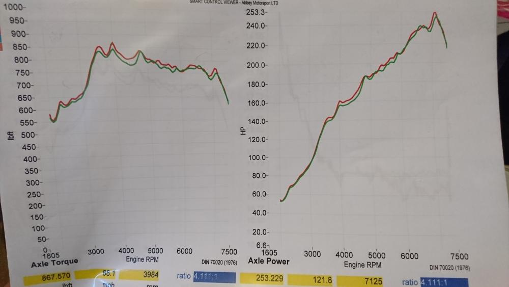

Alex P 16 Report post Posted August 22, 2018 Hi Everyone! I've been a member here (not been active at all...) and on GT86 owners club but after going to a few Japfests and Reading meets, I need to be more active! I started my build project on GT86 owners about 2 years ago which started with the standard mods for NA tune. the 86 was running the following: Tuning Developments EL manifold, JDL Ultra Quiet high flow cat, Ark Performance Grip, Apexi intake and Mishimoto intake hose with Abbey Motorsport remap. This got me to 187whp which I was happy with for a long time but I've always loved the idea of going boosted with this car. And now after 4 years of ownership it finally is! I think my car could possibly be the first in the UK to run the HKS turbo kit! The 86 is now producing 253whp which should be 300bhp at the fly and 205lbft at the wheels. My engine is completely standard and doesn't have any uprated injectors so Mark at Abbey Motorsport made sure the turbo came in as linear as possible for reliability. You do get a bit of turbo lag from below 3000rpm but when the turbo kicks in, the power delivery is incredible! It's so smooth and continues to pull strong all the way through to the redline. The noise of the turbo is brilliant, especially as you come of throttle and get a proper "choo choo" flutter. Mark, Scott and the team at Abbey did an incredible installation and mapping of the turbo which I can't thank them enough for! Only issue now is I need to clean up the other half of the engine bay... Here are my mods so far: HKS Turbo Kit with Zircotec coated manifold HKS Oil Cooler ARK Performance Grip JDL Ultra Quiet high flow cat Tein Flex A Coilovers Project MU brake pads (B Force-front & NS400-rear) Team Dynamics Pro Race 3 17x7 Valenti FT86 Speed Factory spec Tail Lights I've attached just a few pictures but first time uploading with this website so bear with me if it's not right Thanks for reading! 5 surrey86, Lauren, Lucas and 2 others reacted to this Share this post Link to post Share on other sites

Alex P 16 Report post Posted August 23, 2018 22 hours ago, Rob_86 said: How does it run with the hks turbo, very tempted with the hks kit, wanting to see how it runs and if there's any future issues. Will definetly be keeping an eye on this It drives beautifully! I use mine as a daily driver and the only thing I think is different is that you need to give it just a really tiny bit more to move from a standstill but that could be a placebo. It's really easy to drive and no problem in stop start traffic. Hitting boost with the turbo is very very addictive. You can instantly feel the extra power as soon as the turbo starts spooling up. 10 hours ago, dom2497 said: Looks a great bit of kit, would be interesting to see what it would make on a built engine Sent from my SM-G950F using Tapatalk Like Lucas said, it will need pistons to push higher. I believe the HKS demo car is 450bhp at the fly! Share this post Link to post Share on other sites

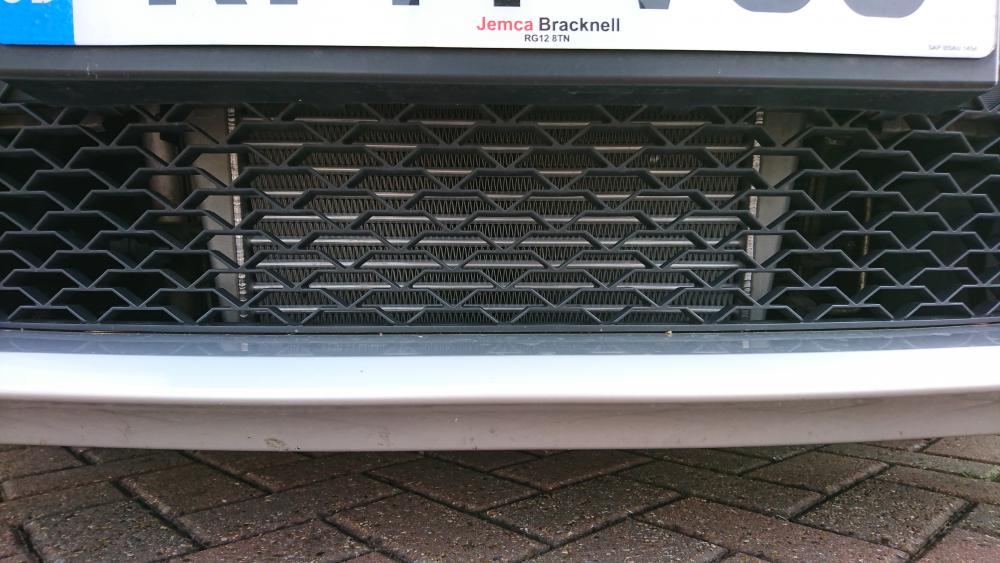

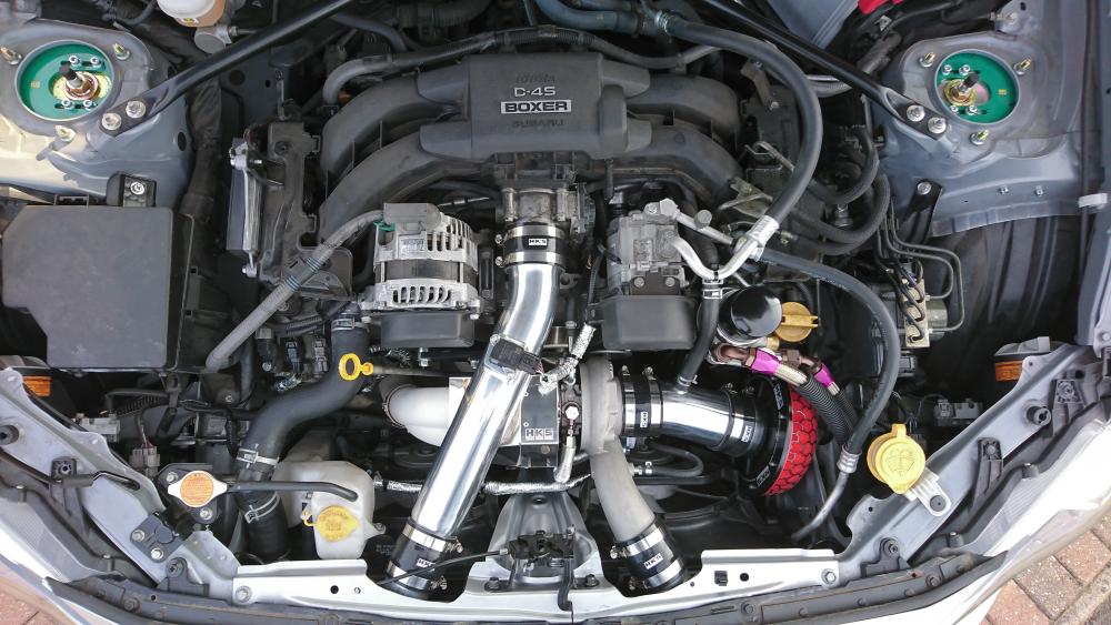

Alex P 16 Report post Posted August 23, 2018 6 hours ago, Paul said: More pics please! Here's a few more! 1 dom2497 reacted to this Share this post Link to post Share on other sites

nerdstrike 186 Report post Posted September 21, 2018 Ah, I love me some turbo pigeons. You can have a lot of fun with 200 lbf torque in a light car. The plumbing looks rather convoluted, but it's shiny and has some symmetry to it. Share this post Link to post Share on other sites

Luke 193 Report post Posted September 24, 2018 Looks like a very good package installed by the Abbey wizards. Great car made a little bit more fun. Do you track the car? Just wondering how reliable it will be after 20mins of constant redline. Where does the oil line plumb into the block? Share this post Link to post Share on other sites

sentinal187 3 Report post Posted July 12, 2019 Have you got any power graphs, I am curious to see the torque versus a supercharged car as I expect it's a good bump up Edit : read first post lol Sent from my SM-G950F using Tapatalk Share this post Link to post Share on other sites
