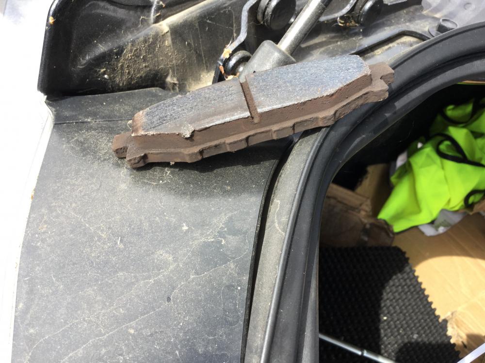

Hello all,
 I was driving along briskly and applied the brakes quite firmly then there was a bang from the nearside rear and the brake pedal went to the floor. I re-applied the brakes and got a lot of ABS Judder and managed to bring the car to a stop.  The nearside rear outer brake pad had fallen out. I found a pad in the road and there is still a good 6 mm of material left on it.  The disks are not that old.  Has this happened to anybody else and does anyone have any idea how it’s done it?

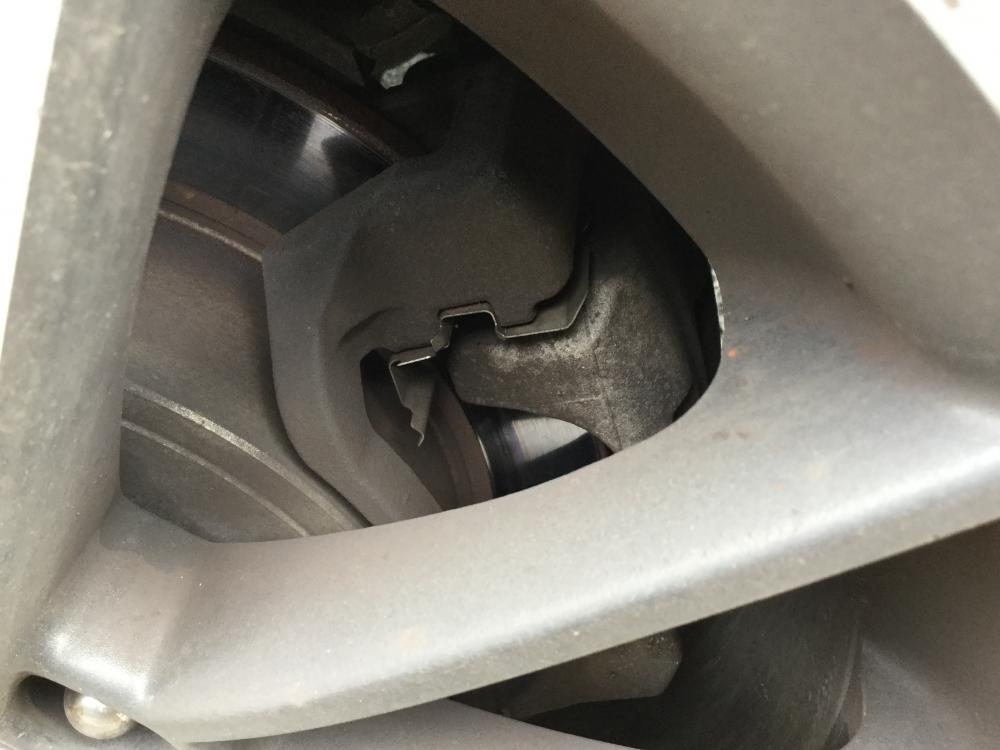

The pad holder looks out of position considering the carrier and shims next to it.

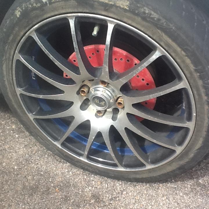

It’s hard to tell from pictures whether they are vented but they do look quite old ?
He said:
On 10/08/2018 at 3:12 PM, Julesbeav said:
Seems to be solid discs with calipers for vented one
I reckon you can just about make that out from the photo.
