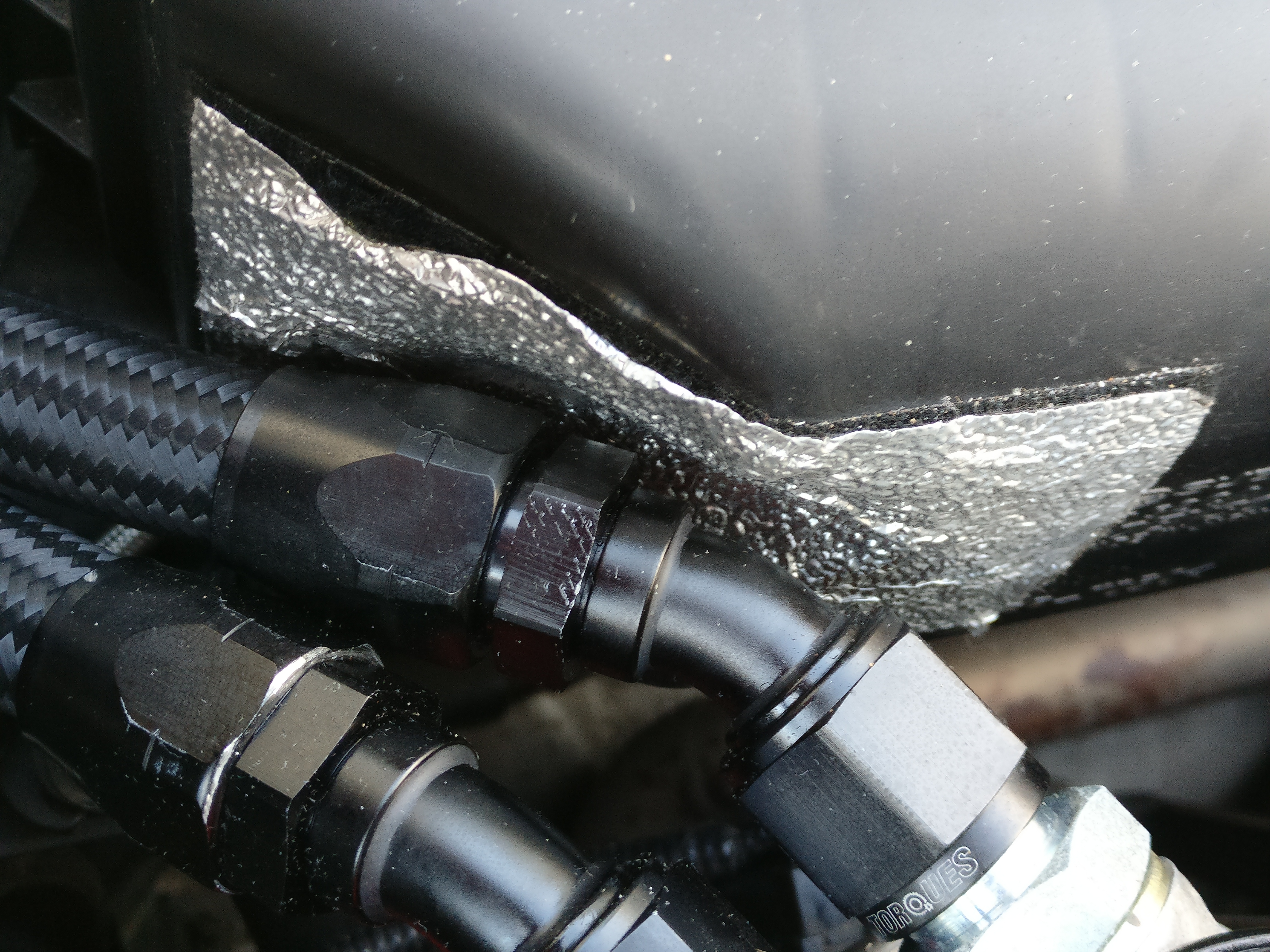

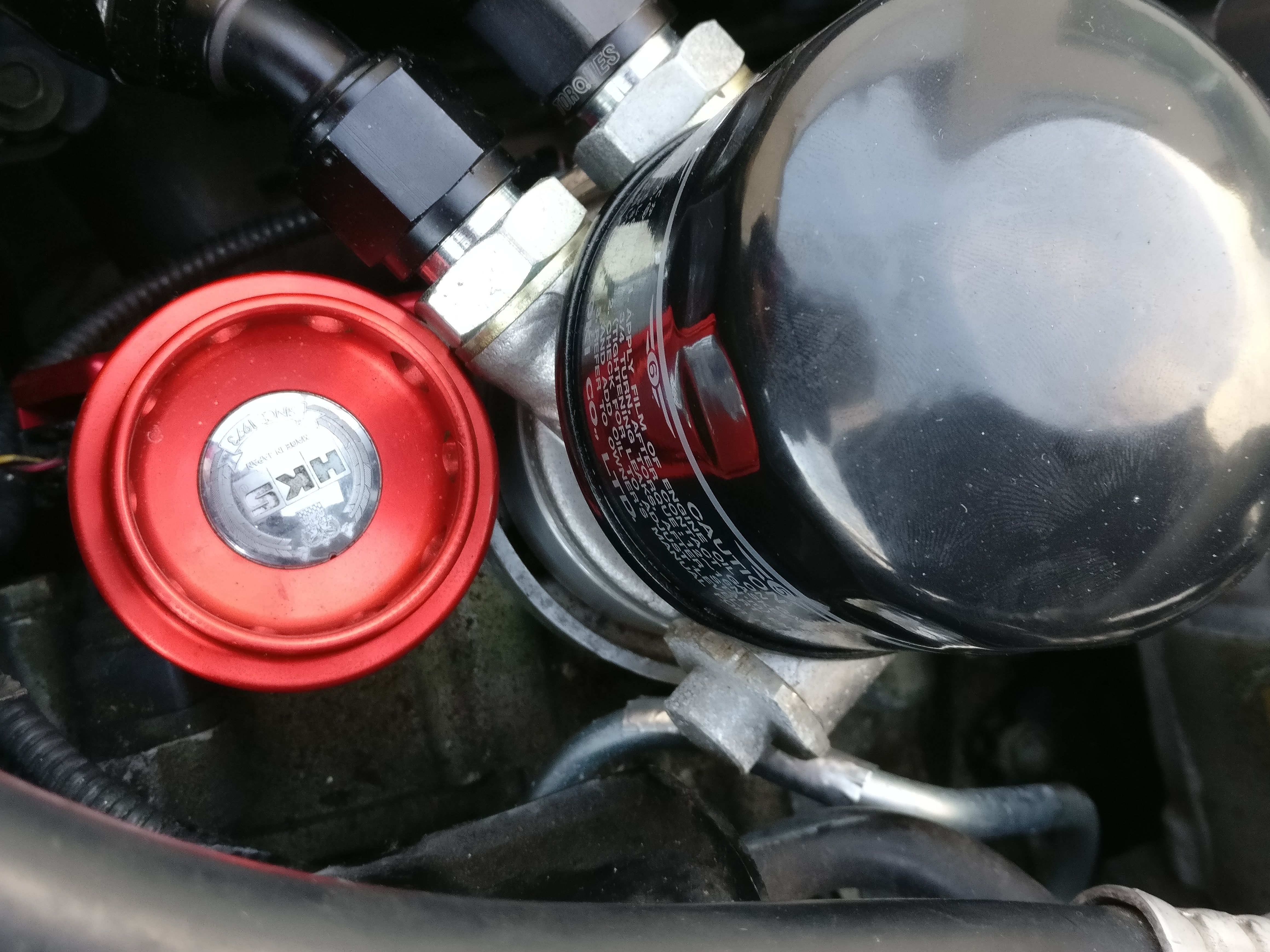

Deacon 1357 Report post Posted January 24, 2018 2 hours ago, sam534 said: Can it be mounted the other way round? Sent from my STF-L09 using Tapatalk Sadly not. Here's a picture of the problem. Oil cooler pipes need the stock airbox manipulating to clear:- There's no room to mount the sandwich plate the other way due to the hard lines. You may be able to get more 'angled' pieces going into the sandwich plate (I'm not sure on this) or HKS/Greddy etc do a sandwich plate where the fixings go straight up vertically rather than horizontally which would also give the necessary clearance. I'm swapping to an induction kit which will get rid of the problem (the hks oil cap on mine also makes it slightly worse than the plastic oem cap). I had a gauge fitted giving me oil temps and pressure. The oil temp is tapped into the sump and pressure is read from the block. Before fitting the cooler I was seeing temps getting into the mid 120's within three flying laps at Bedford so having to do a cool down lap and give it a 20 min break before going back out again. Post cooler temps didn't get much above about 115 and my sessions were only curtailed by my knackeredness! As Knightyrider said the killer is the pressure drop at higher temps. I'm currently running 0w30 and even just driving home with a temp of about 83 the pressure drops to low teens at idle. If you're tracking a bit I'd definitely get an oil cooler sorted. Seeing the pressure drops (plummet) was enough to convince me! 2 sam534 and Mike reacted to this Share this post Link to post Share on other sites
sam534 62 Report post Posted January 24, 2018 Sadly not. Here's a picture of the problem. Oil cooler pipes need the stock airbox manipulating to clear:- There's no room to mount the sandwich plate the other way due to the hard lines. You may be able to get more 'angled' pieces going into the sandwich plate (I'm not sure on this) or HKS/Greddy etc do a sandwich plate where the fixings go straight up vertically rather than horizontally which would also give the necessary clearance. I'm swapping to an induction kit which will get rid of the problem (the hks oil cap on mine also makes it slightly worse than the plastic oem cap). I had a gauge fitted giving me oil temps and pressure. The oil temp is tapped into the sump and pressure is read from the block. Before fitting the cooler I was seeing temps getting into the mid 120's within three flying laps at Bedford so having to do a cool down lap and give it a 20 min break before going back out again. Post cooler temps didn't get much above about 115 and my sessions were only curtailed by my knackeredness! As Knightyrider said the killer is the pressure drop at higher temps. I'm currently running 0w30 and even just driving home with a temp of about 83 the pressure drops to low teens at idle. If you're tracking a bit I'd definitely get an oil cooler sorted. Seeing the pressure drops (plummet) was enough to convince me! Thanks deacon, I was curious to your problem, a number of things adding up by the looks of it. Looks like different fittings may work.... Bit of a bad design to be honest! Sent from my STF-L09 using Tapatalk Share this post Link to post Share on other sites
Deacon 1357 Report post Posted January 24, 2018 4 minutes ago, sam534 said: Thanks deacon, I was curious to your problem, a number of things adding up by the looks of it. Looks like different fittings may work.... Bit of a bad design to be honest! Sent from my STF-L09 using Tapatalk The individual parts in the Hel kit are very good. The package they put together is shite! They clearly hadn't tried it properly on a car before its release and when I looked last they don't list it anymore. Shame because as I said the parts are good (mocal, setrab, etc) Share this post Link to post Share on other sites
