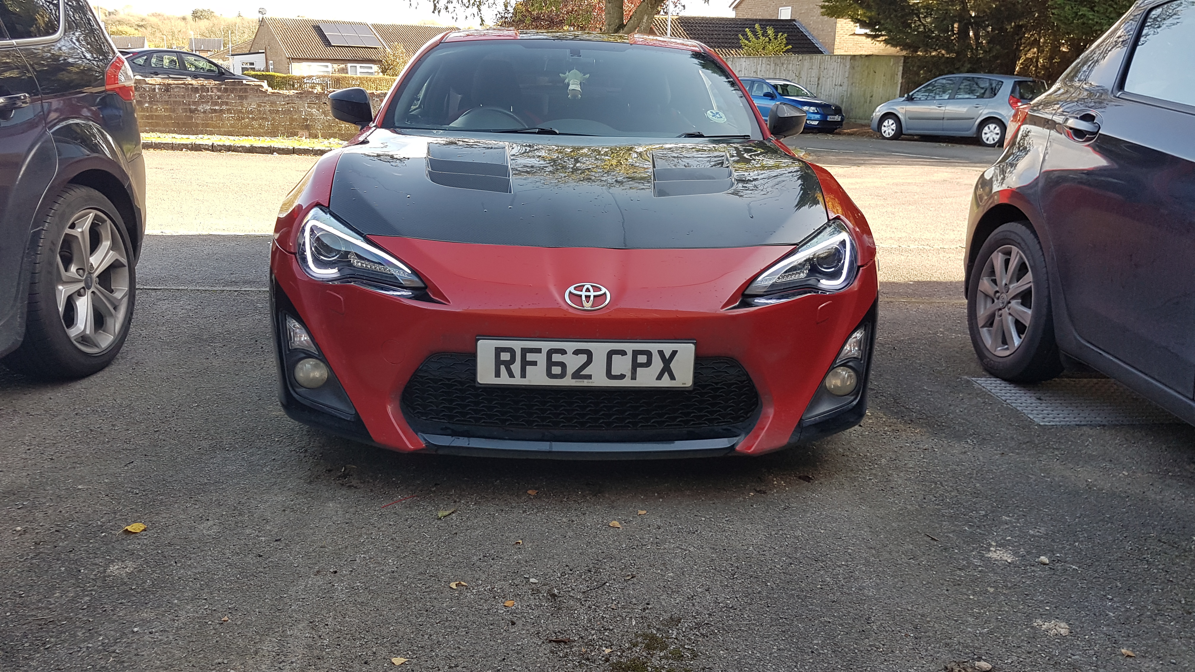

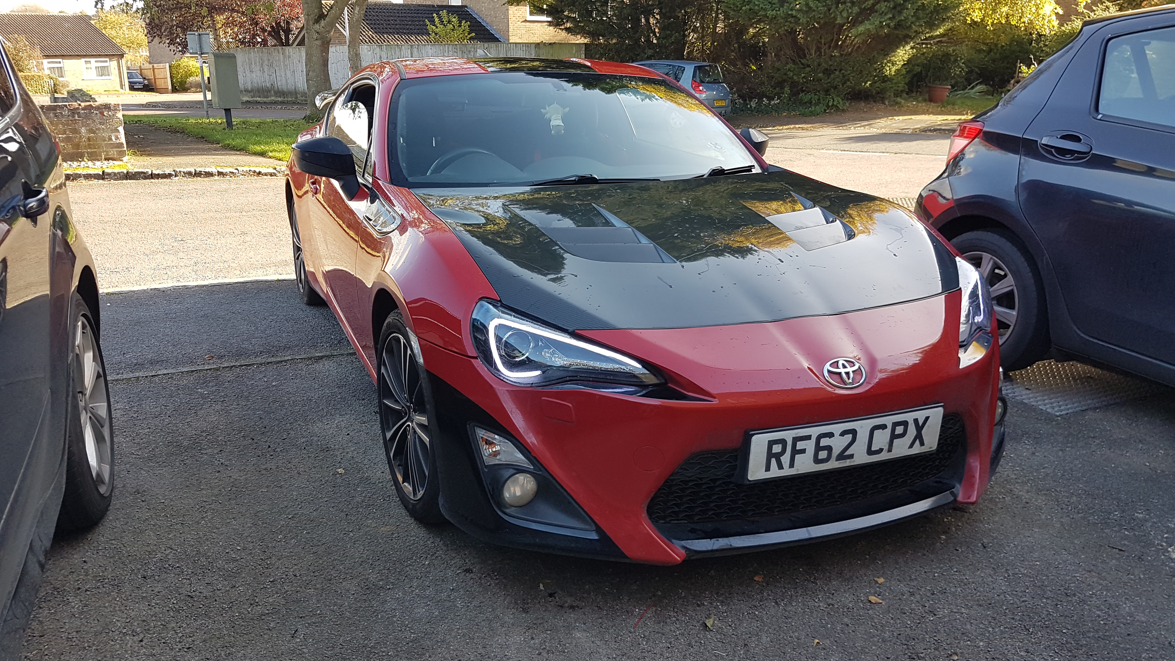

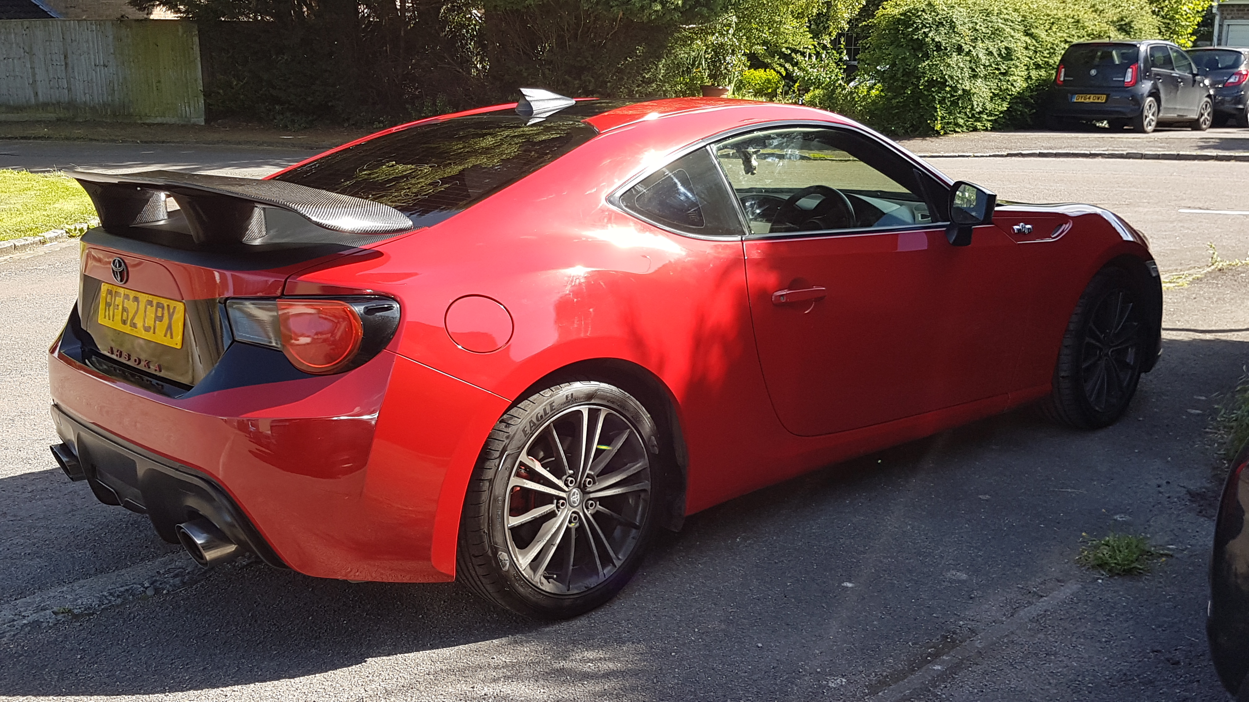

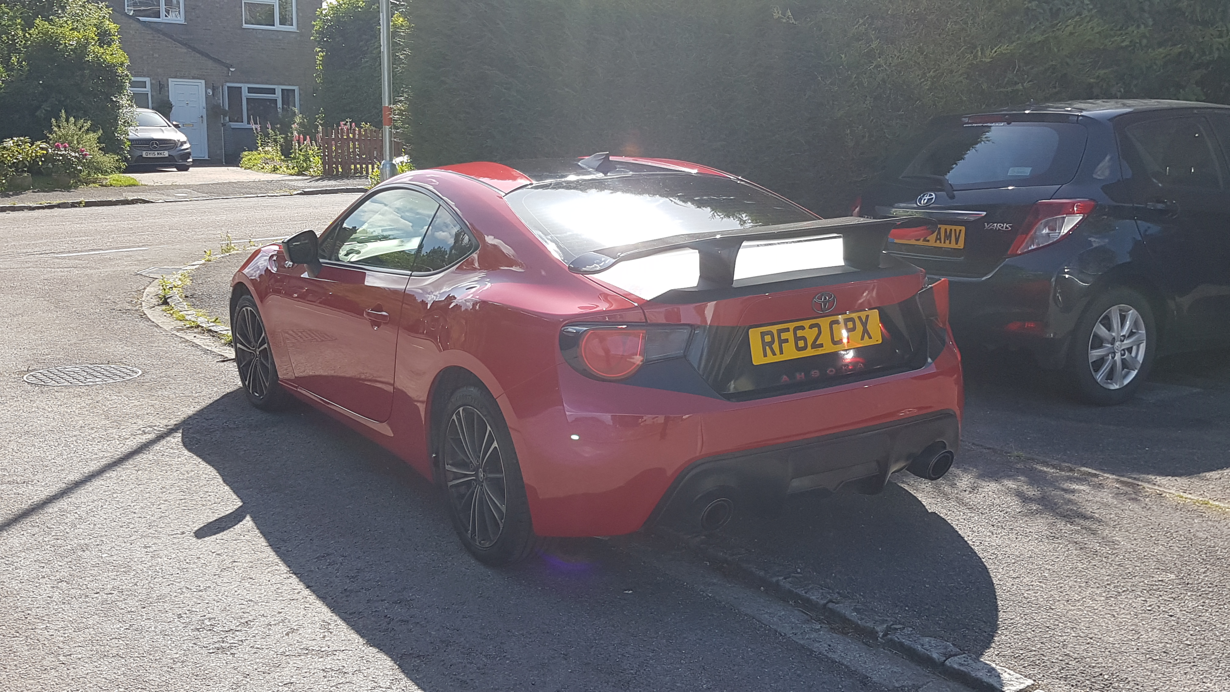

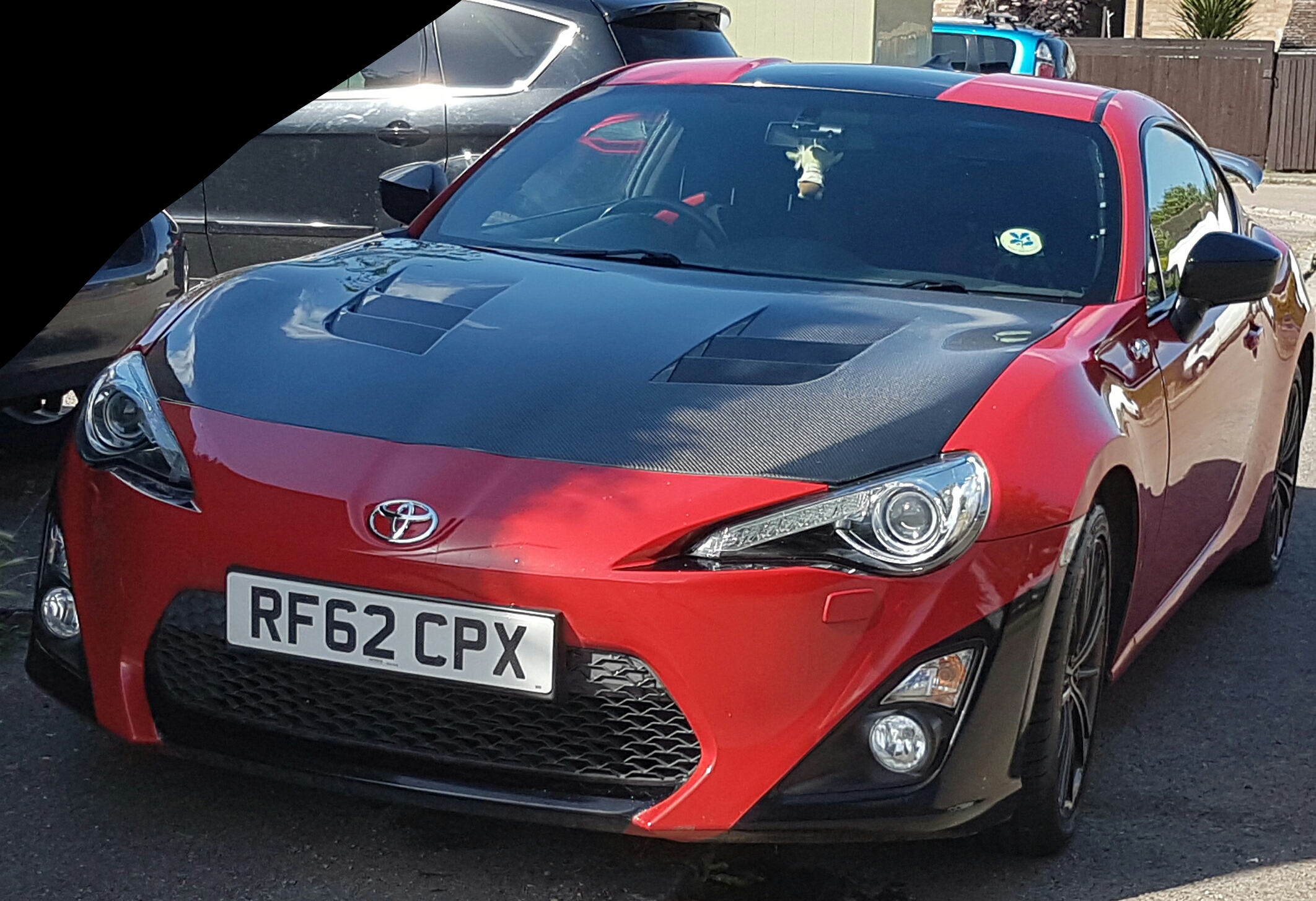

Well I figure, I've been extremely slack in both this forum and the other one that shall not be named.
So some of you know me, most probably dont xD that's how pro I've been at staying out of the loop.
Anyway mods done thus far, sound pipe delete, induction pipe, replacement air filters lols.
Vinyl wrapped some of the inside panels debating colours atm. Sound deadened doors, some of the dash, replaced door speakers and dash tweeters. Will be possibly dual subbing it soon and delete the rear speakers.
As for external partially vinyl wrapped, heavily tinted with limo shade, Seibon cf bonnet, Seibon cf rear wing, beatsonic v2 aerial wrapped carbon.
I am debating headlights soon, redening or black spraying the tail lights (spare set), full vinyl wrapping.
Oh yeah and I have a Quicksilver Cat back exhaust system installed.. Hear that from a long way away.
Anyway I named my car after a jedi 'Ahsoka' so here is my build thus far. Yeah ignore the lettering I'll get it done alot more subtly soon :P
I'm only showing my build now as I see GT86's and BRZs quite alot now, most the time I'm overtaking them all!
Seeya around :P

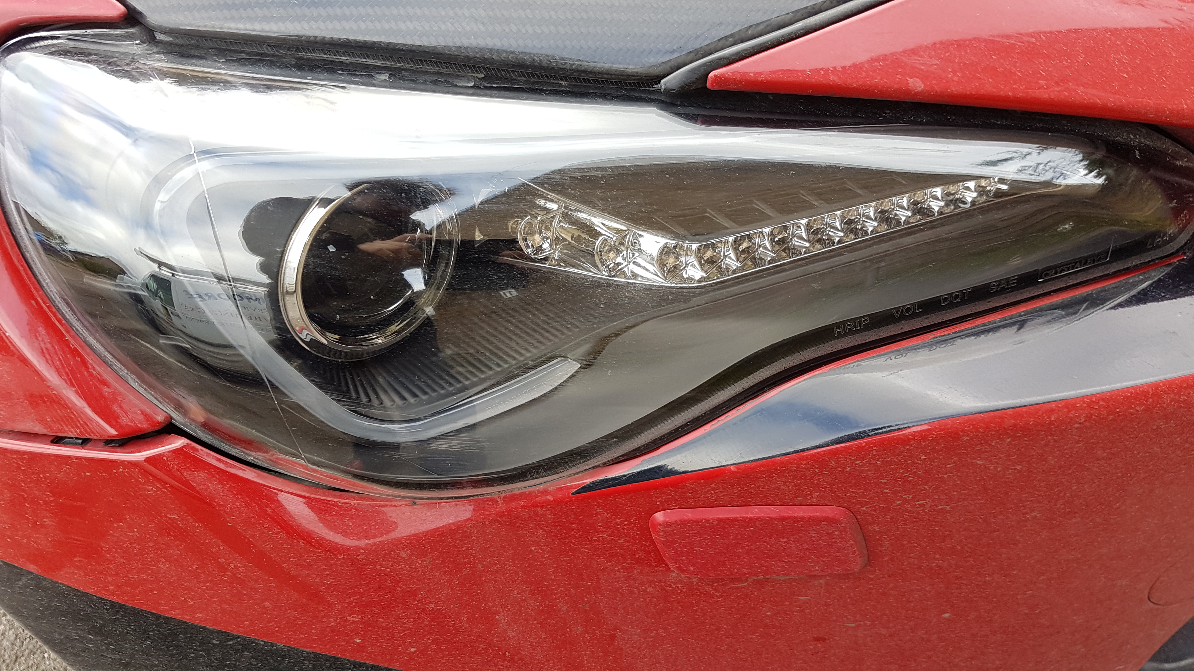

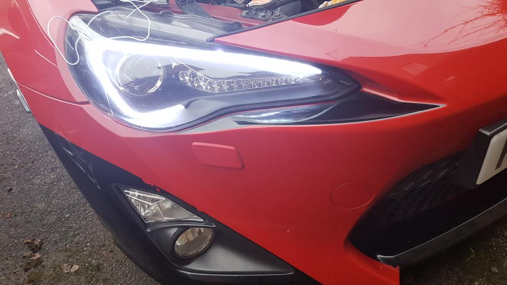

I've been looking at getting a set of these, do you have a link where you got them from?
Also were they a straight forward swap? I've heard that they can be a bit of a pig?
I like seeing them in UK.. i Love D-Spec headlights, but they have different connectors don't they? 6 pin for US cars and 8 pin for UK/Euro cars, so it does need re-wiring. Was this the case?
Ello,
Sorry for the delay, these were Crystaleye Black LED JDM headlights, they were 8 pin and were plug and play, they themselves were easy swap out move the ballast over and replug all back together, however the front bumper is an absolute pig to remove and to also put back on.. mines sagging and i'm looking into resolving it soon.
The only downside but again I'm looking at a solution involving a small pre-made wiring harness and adaptors from a  company in the US is these crystaleyes do not run the LED strip as DRLS, however they do as Side lights, so I'll be getting a harness to ensure they stay on when the car starts and always on. Saves me splicing wires anyway.
They do not use motors to adjust so its a bit of a pain to set up the beam, but hell at least one less thing to fail *looks at my stock lights where the motors failed angrily*
From my research prior to buying these, The Spec D headlights you have to do full wiring, cutting, soldering and then manual beam adjustment too, as they are 6 pin only and built for the US market only, they can be modified to suit, but if i'm / you are willing to spend this money on your headlights then you shouldn't have to do a shit load of rewiring and cutting in to the primary car lighting harness.... that was my reasons anyway.
I won't beat about the bush, you may call me crazy, but the costs of these were cheaper than me replacing the stock headlights... considering the motors had both failed.
These were £453 for the part, then ~£50 premium insurance (optional), then ~£160 P&P, then a further £140 or so for import and duties and the parcelforce charge. so in total i think it worked out as £780 all in.
If your still interested, or just to look at the nice shinies on their website, I purchased these through Nengun in Japan. awesome customer service, took about a month to get to the UK due to being built to suit UK consumption..
https://www.nengun.com/crystaleye/led-headlights
Next modification gets to the UK in 2 weeks and will be the Buddyclub JDM LED taillights, figure, sequential taillights to go with sequential headlights. :P

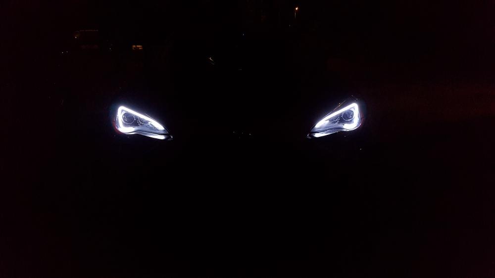

Hello all,
Right rather than me bringing up a long deceased post on another part of the forum, I recently took the risk to buy a harness loom from Diode Dynamics for my Crystaleye V3 Headlights with the aim to use a plug and play kit to run the sidelight boomerang as a DRL.
Diode Dynamics had absolutely no idea if it would work, being about £100 for this little venture, I was a bit reluctant to spend that and find it didn't work...
Anyway, I can confirm it does indeed work, granted the long white cable that came on the harness is not plugged in as its for something else, I have the 2 main plugs installed:
  • Car off - Headlights OFF / DRL's OFF
  • Car on - Headlights OFF / Handbrake Engaged/DRL's OFF
  • Car on - Headlights OFF / Car in Neutral or in Gear and Handbrake released/ DRL's ON
Then they just stay on when the headlights fire on with the Automatic lights on sensor etc.
So all works 100%. The routing of the cable/conduit, I've literally just preliminary routed it above the radiator dual fans and under the air filter box, and then wrapped up that long ass loose white aforementioned wire and plug around the left side headlight harness and pushed it into one of the many holes in the engine bay.
I took a few photos as I know a couple of people have been asking me about this for sometime now :P
