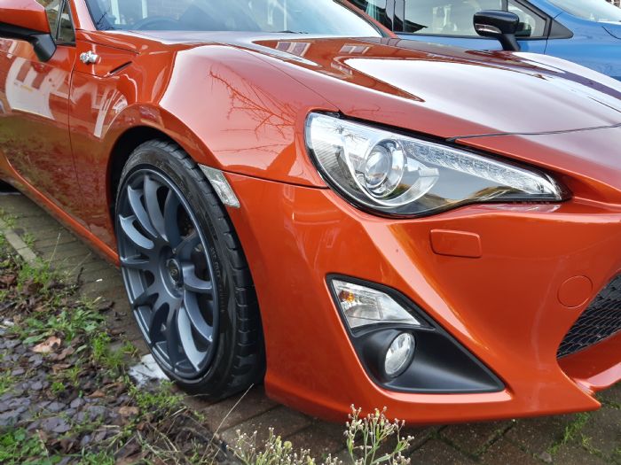

gavin_t 184 Report post Posted December 21, 2017 Running 225/40 18 on mine lowered on the same springs as you and find the fitment and drive spot on compared to the stock wheel size. PS mine are 8.5inch wide so have a little stretch. Fitment would be perfect on 8inch and nice and square Share this post Link to post Share on other sites
