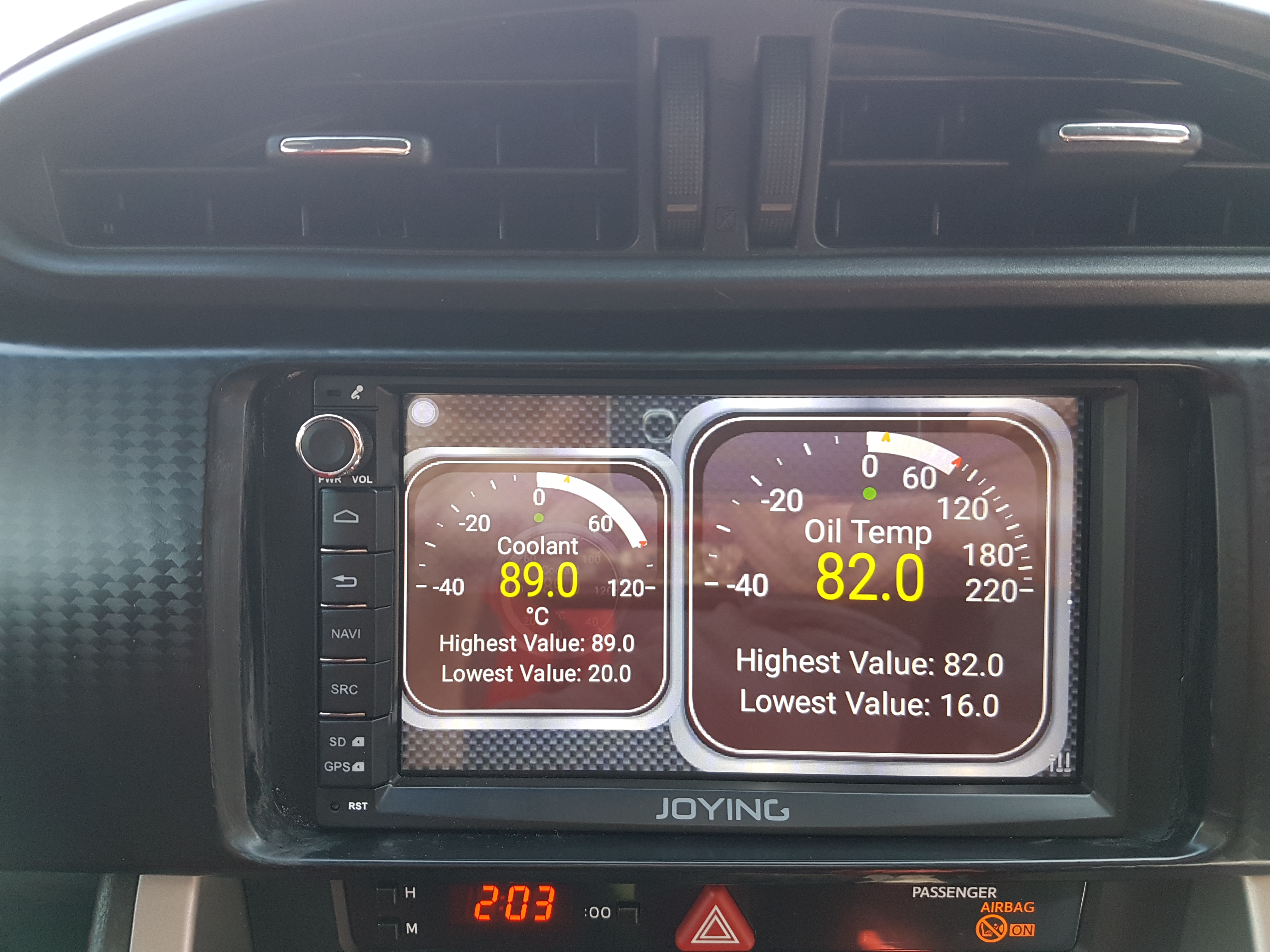

Adam9 37 Report post Posted March 16, 2017 This is probably the most established direct replacement : Joying Toyota Universal Headunit It has a decent processor, 2GB of memory and Joying are quite active with updates and development. It doesn't require any adaptors although it will be easier to install if you also order Joyings Toyota Hilux wiring Harness. Share this post Link to post Share on other sites

Adam9 37 Report post Posted March 23, 2017 On a fresh boot it takes about the same time as the Toyota unit , maybe a couple of seconds longer. If you haven't left it alone for several days though it's instant on as it sleeps in a low power state rather than shutting down. Honestly i'm really impressed with it so far, it feels a bit too light compared to the Toyota unit when you first pick it up but now it's installed it all looks and more importantly sounds great. 1 ThatGuyThere reacted to this Share this post Link to post Share on other sites

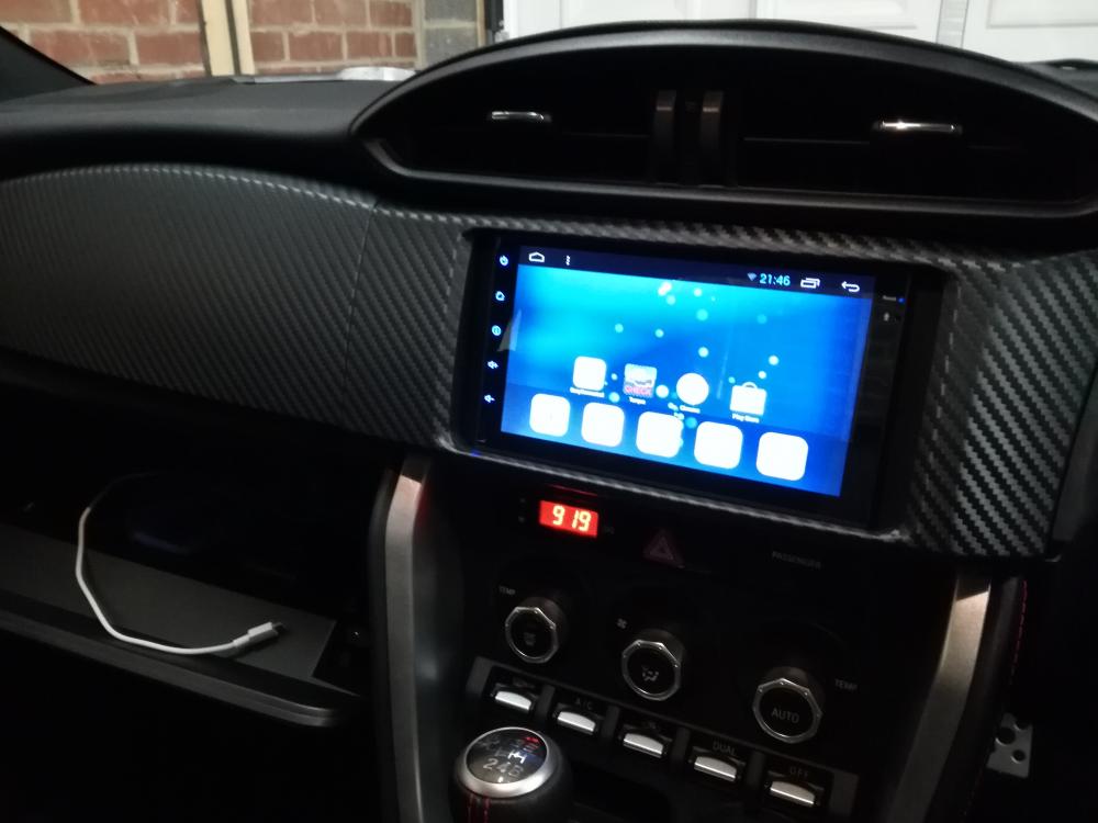

八六車 24 Report post Posted April 3, 2017 Eincar unit installed, usb splitter cable used to add an extra connection in the glove box and keep the standard one functional for charging. No complaints with the unit itself so far after a couple off trial runs out (still getting it set up to my liking). Biggest issue was the mounting brackets where miles off and needed some work to make them fit (nothing a bit of cutting and drilling wouldn't fix) Share this post Link to post Share on other sites
