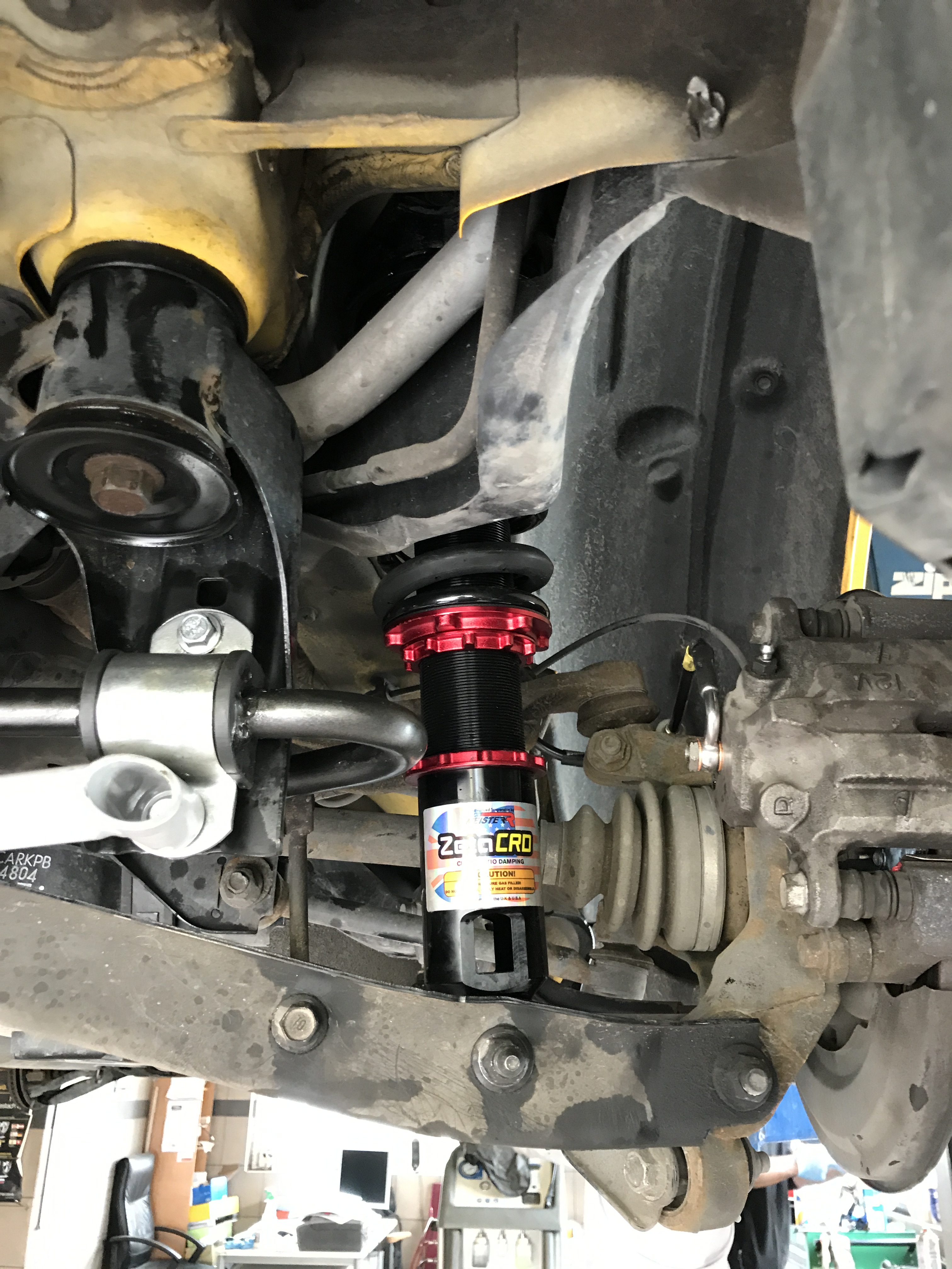

4. MeisterR Coilovers Model: ZETA CRD+

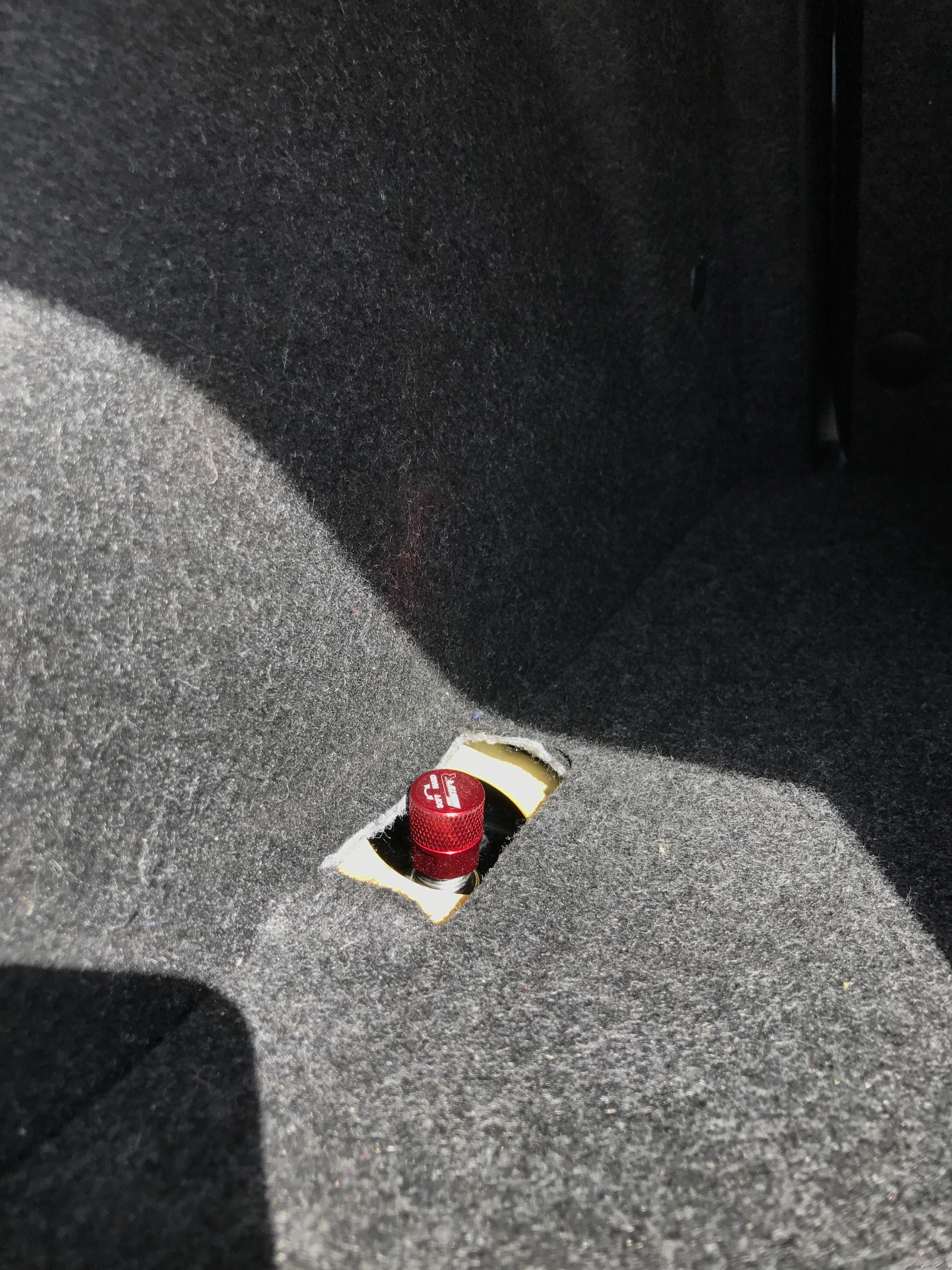

Great suspension in this price rage. No problem on my daily road (DD setup, 20 clicks from full hard front , 2,4 bar front pressure , 22 clicks  from full hard rear pressure 2.1 bar, No problem on bumpy roads. Less harash than stock suspension, great stability on high speed turns and highway speeds, no additional cabin noise - for me it is great for DD and 2/3 track sessions per month.

SECOND VISIT ON TEST TRACK - MEISTERR ZETA CRD+, ST sway bars Hard settings front and rear, custom geo, enkei RPF1 17x7 et42, FEDERAL 595 RSR 215/45. After damping setting (5 from full hard front, 7 from full hard rear) My best lap time was 1:0053 - so almost 3 second better. Car feels great well balanced and stable , on narrow corners almost no body roll - big improvment compering to stock, no additional sounds from suspension even on bumpy roads
Drop right now is 20mm  front and rear
