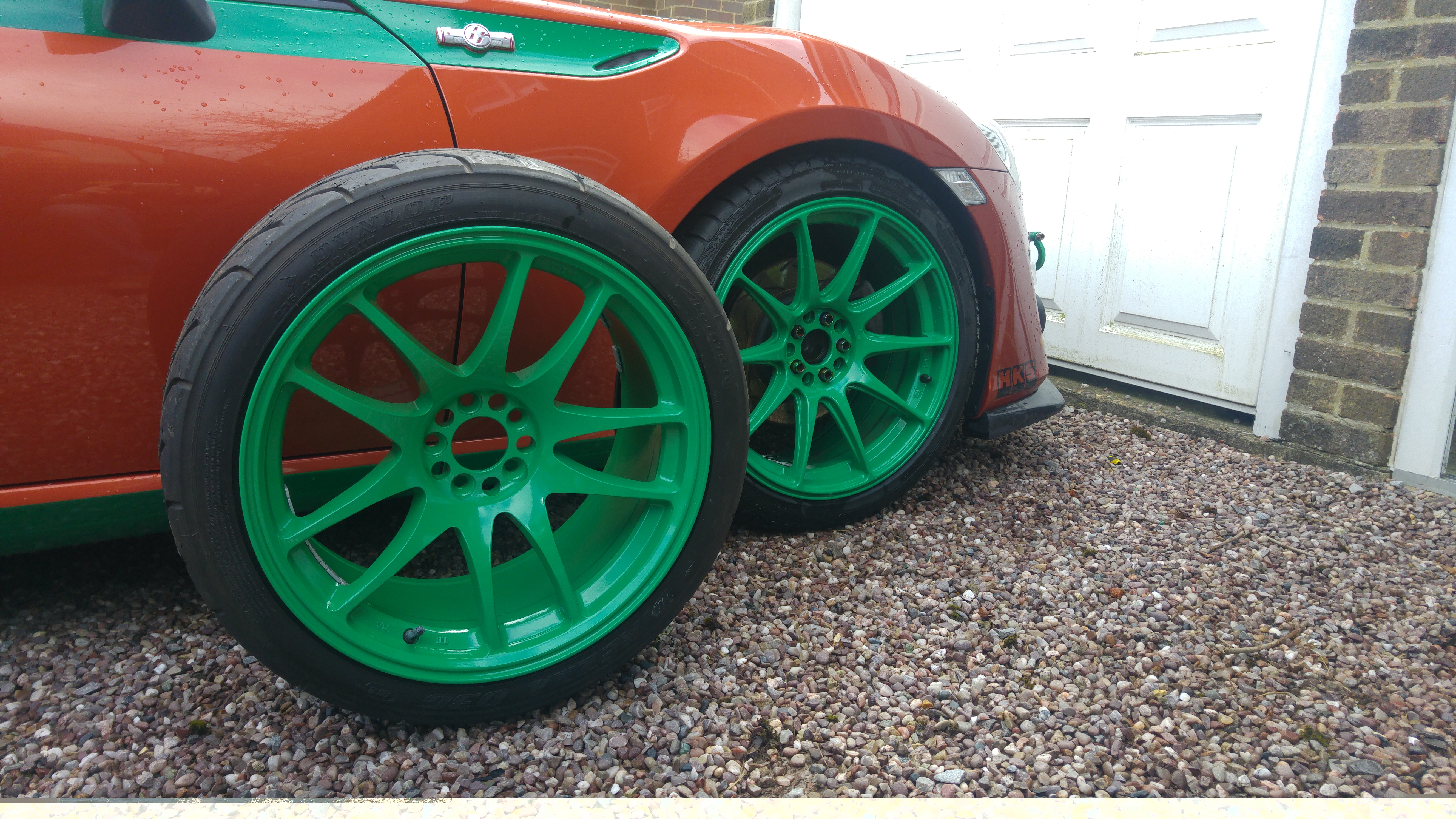

KevinA 695 Report post Posted June 25, 2016 Different Sizes and offset, but they look vey similar. 1 Kirsty80 reacted to this Share this post Link to post Share on other sites

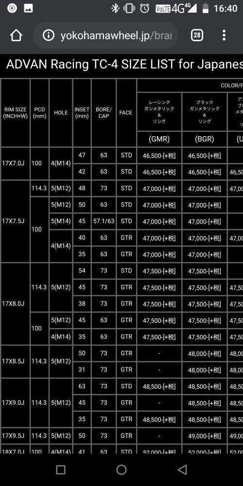

Darth Raknoor 1 Report post Posted July 13, 2020 Hello everyone, I'm new here and will be getting my 2020 gt86 soon. I'm looking to get some Advan TC-4s in 17x7.5 and wanted to know if they'd fit. Which from this list of 17x7.5 would fit best? Share this post Link to post Share on other sites
