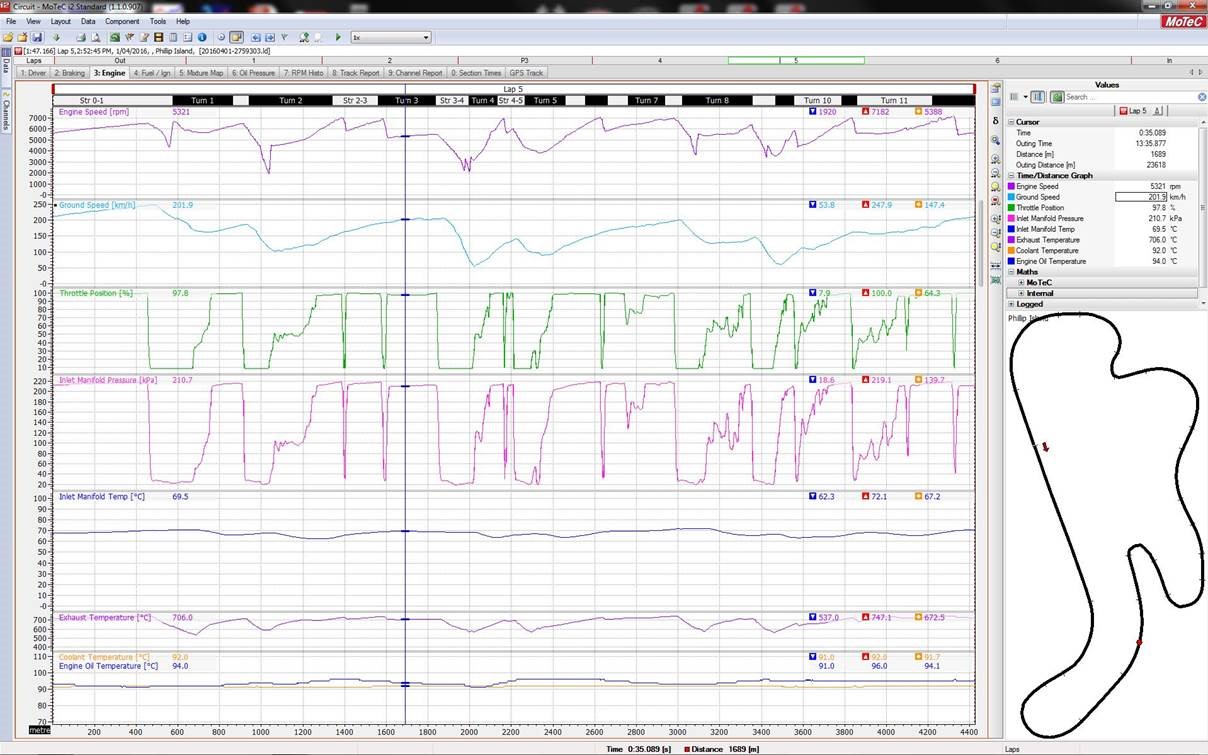

Ade 517 Report post Posted April 12, 2016 1 minute ago, knightryder said: It's a smaller blower, there is more headroom with the bigger blowers.... He didn't say the Cossie couldn't make more power, but there was less headroom The Cosworth is capable of 380hp which is enough to break the gearbox. Sure the blower is a little smaller, but the heat exchangers are much bigger. I would argue both the Edlebrock and Harrop do not have big enough cooling for any more power than stock. +30C for the Edlebrock and +40C for the Harrop over ambient when hooning around the track is already going to lose you some power. Share this post Link to post Share on other sites
rob275 1817 Report post Posted April 12, 2016 Surely these are all just here say figures though seeing as nobody has any data available? Share this post Link to post Share on other sites
Ade 517 Report post Posted April 12, 2016 7 minutes ago, rob275 said: Surely these are all just here say figures though seeing as nobody has any data available? Nope. Plenty of datalogs stateside from all three kits. Harrop have just released some data. They were running ~70C IAT in 28C ambient. Edlebrock was running 56C in 21C ambient Mine was about 26C is 10C ambient at Bedford. Share this post Link to post Share on other sites
