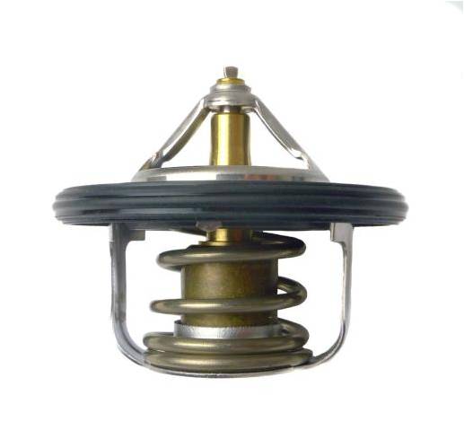

2 hours ago, knightryder said:
Save yourself £20 and get the Mishimoto thermostat. I'd wager its the same thing in a different box.
I don't think it is the same if you compare the images. I might be wrong though. I'd go Cosworth as its a trie and tested part and well #becausefanboy
Mishimoto:
subaru-brz-racing-thermostat-2013-113.jp
Cosworth:
1 hour ago, daidaiiro said:
I'm interested to know what effect the thermostat may have though? Scrub that, found the info on website - which also makes a deal of their induction hose; 5 BHP gain; credible?
According to Matt (Cosworth Engineer - you might know him as 350matt in the TVR world) the thermostat, which drops engine temp by about 10C, gives more knock headroom and when the timing is mapped accordingly, you net about 3hp. #everylittlecounts
The stock air box is good for 350hp. Any induction offering make power by tricking the ECU into thinking less air is going into the engine than actually is by messing with the airflow around the MAF, and thus makes it run a bit leaner. A re calibration of the MAF sensor and all those gain are lost on an N/A car.
@Ade the operating temps are the same. I bet that those photos are probably just generic ones anyway..... a thermostat is a thermostat. Do you think that Cosworth actually manufacture their own? If they both operate the same, I would rather not spend £20 more for a Cosworth box to sit in my cupboard/recycling bin....
A thermostat is not just a thermostat!
Transient response one important part. You don't want the thing over cooling or worse oscillating trying to find an equilibrium point.
As I said they might be the same, but I wouldn't take the risk for a sake of £20.
The Mishimoto stuff seems good quality though. The sandwich plate I have is very well machined.
