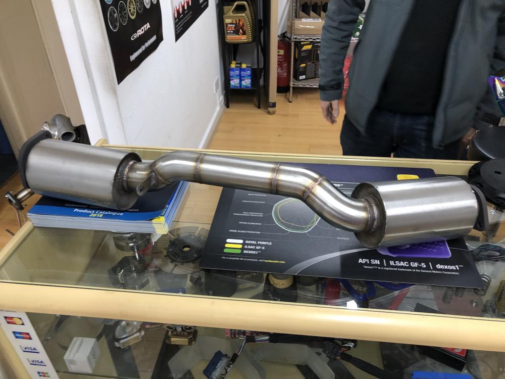

Lauren 2259 Report post Posted March 16, 2019 Bit of a lapse since the last update! Oops! Not a lot to report but I had my 120K service a couple of months ago. I've been umming and aahing about whether to do something about my exhaust. With having no cats and a a resonated TD system it felt like the raspy sound you get under load between 3-4K rpm was getting a bit irritating and seemed to be getting a bit louder. I had a word with Mike at TD and asked him to have a look at it for me. He found a possible slight blow and took the decat pipe out and resealed it. This didn't quiten it some and took it back to where it was. However, whilst the raspy sound is fine when you're in the mood and very good at scaring cyclists (if that's your thing), it was still annoying me as I found I was driving around a lot of the time trying to keep the revs under 3000 just to avoid the raspiness. Mike said he had a reasonated decat pipe I could try as a silencer at the front end of the system is what makes the difference. After a bit of thinking I decided to go ahead with it. I had it fitted today and as you can see from the pic, it has two small silencers. This drastically quietens the exhaust down and totally loses the raspiness. When I drove it home, it was almost like I couldn't hear it! This is of course all relative and reminded me of how loud it was before. I can actually hear some induction noise again and I haven't heard that since I had a stock manifold and Milltek on! There's a part of me that wonders if it's too quiet, but I think I'll get used to it and appreciate that it's pretty well non-intrusive when you're cruising around, but you can still hear it when you hoof it of course. Maybe I'm just getting old! 🤣 A huge thanks for Mike for a speedy and efficient service as always. I did ask if he wanted to be in the pic but he declined. 😂 Share this post Link to post Share on other sites
matrixprotein 33 Report post Posted March 16, 2019 How long have you had the resonated TD exhaust on for Lauren? Shopping around ATM, thinking about this or the cobra!Sent from my CLT-L09 using Tapatalk Share this post Link to post Share on other sites
Lauren 2259 Report post Posted March 16, 2019 Had it on for 25K miles and about 18 months. Share this post Link to post Share on other sites

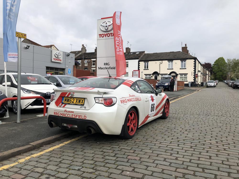

Luke 193 Report post Posted May 10, 2019 Saw it at japfest and thought the new vinyl design looks great. A take on the old ae86 btcc touring car isn't it? Share this post Link to post Share on other sites
Lauren 2259 Report post Posted May 11, 2019 18 hours ago, Luke said: Saw it at japfest and thought the new vinyl design looks great. A take on the old ae86 btcc touring car isn't it? Thanks. Yes it is a take on Chris Hodgett's winning AE86 BTCC car. It's Toyota GB's livery that they used on the Britcar GT86 which itself is a copy of Chris's works AE86. We just changed Toyota GB to RRG Macclesfield. Share this post Link to post Share on other sites
