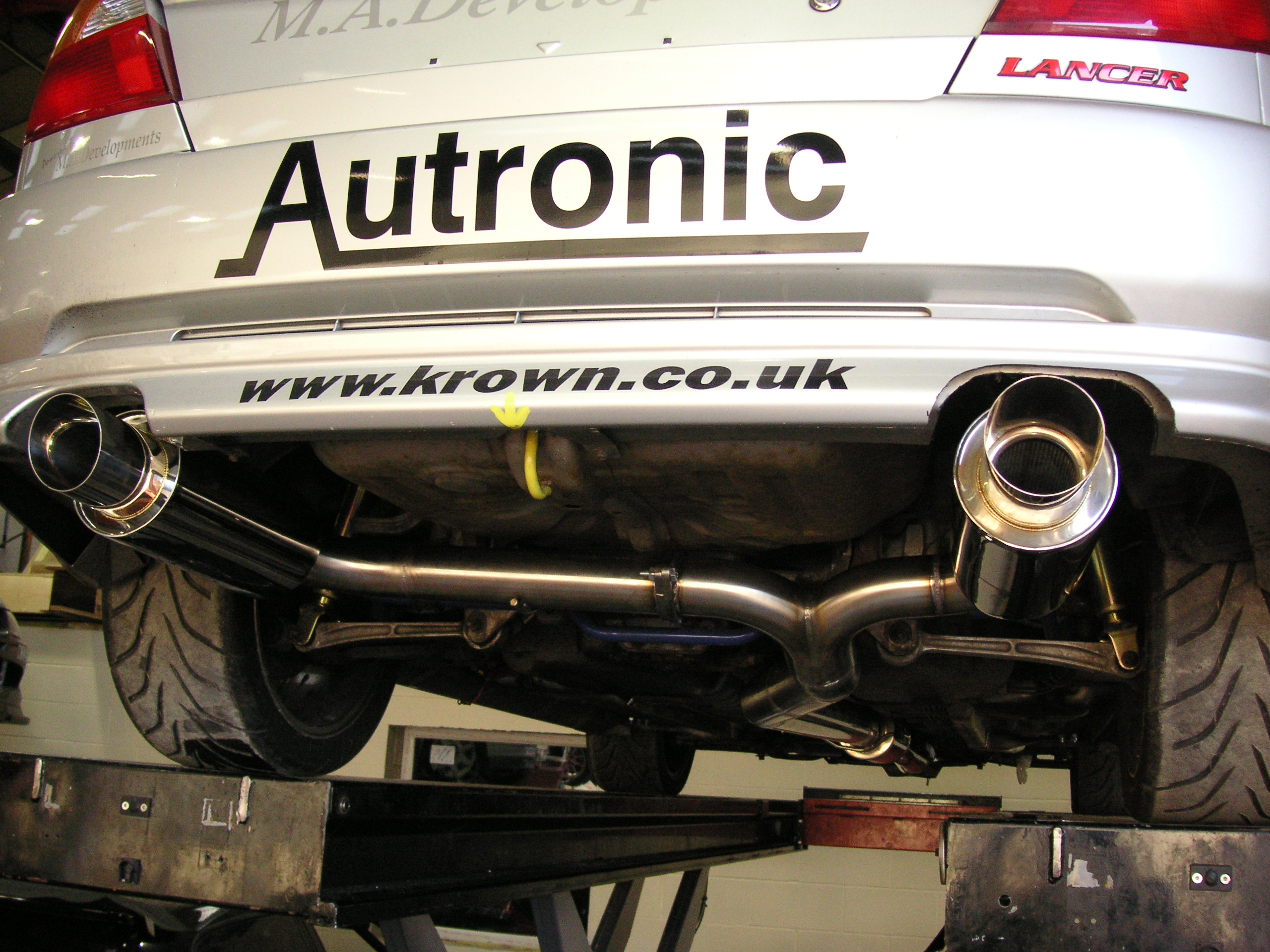

KevinA 695 Report post Posted September 30, 2015 This is what we had done on the EVO Share this post Link to post Share on other sites
smudge 1020 Report post Posted September 30, 2015 Looks nice Kev, who did that for you? Full turbo back? Share this post Link to post Share on other sites
KevinA 695 Report post Posted September 30, 2015 Yep 3" from Turbo, the guys near me that do stuff on the ginger fabricate all sorts including intercoolers. Share this post Link to post Share on other sites
