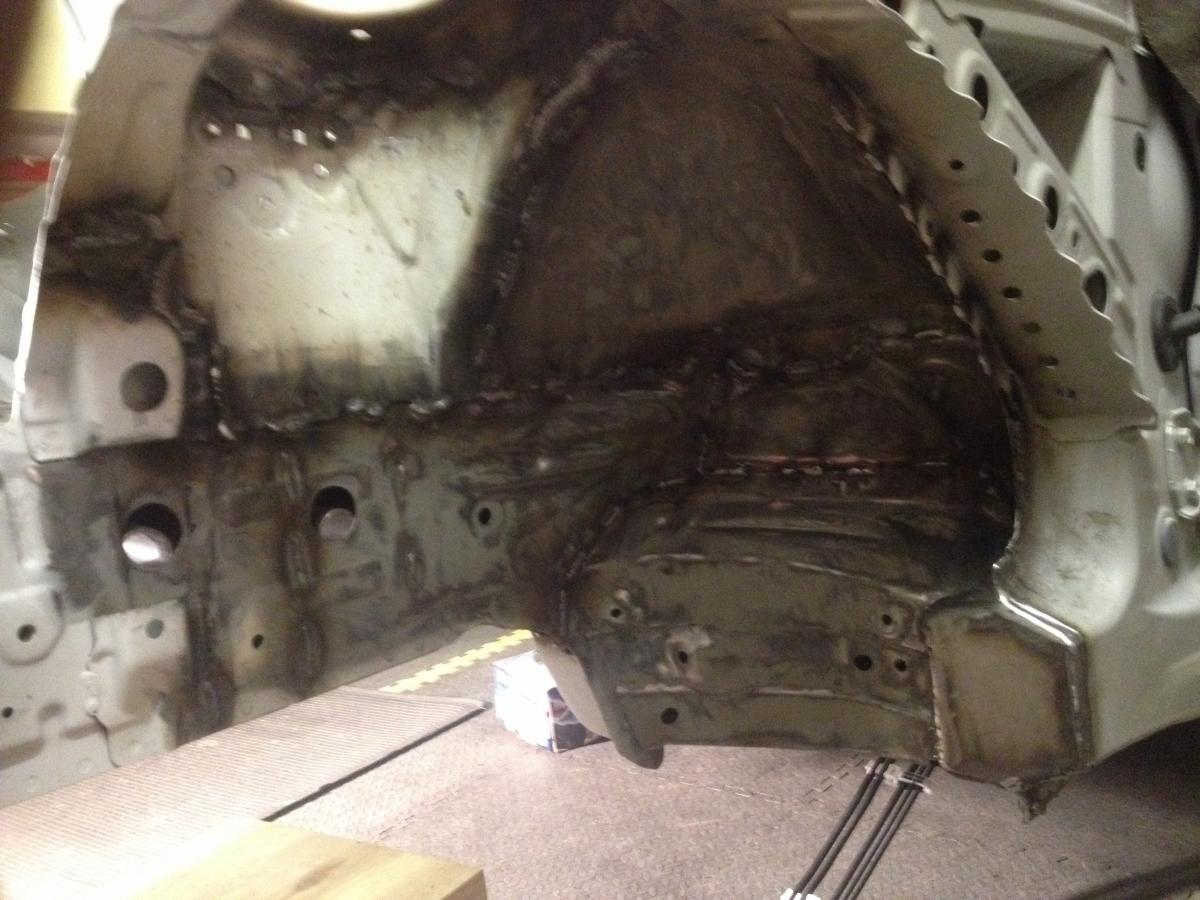

Toyota(Subaru) apply a thick black sticky underseal to the inner wheelarches and all over the suspension components. It is like the thickblack aftermarket underseal you can buy in tins. Why??? This stuff hasn't been used on production cars since the eighties???
Any way, it had to go. There's no way I'm working on a car and getting this shitty crap on my hands and everything I touch!! So, now we have this... a clean repainted wheel arch.
I really don't know why they put the tar all over the arches, it's not as if they don't already have the thick rubberised sealant everywhere, just like all the other manufacturers use???
