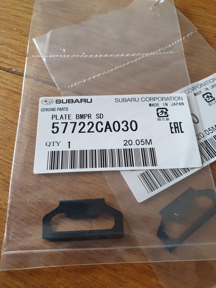

Conscript 45 Report post Posted June 8, 2020 On 6/13/2019 at 9:16 AM, Conscript said: Thread bump! My bumper is sagging a little. Thought I'd phone the Subaru dealer, see how much those clips were in the service bulletin...looks like something I could fix myself in about 20 minutes. £15.82 each and no stock in the UK. Three week wait from Japan. Probably easier and cheaper to get hold of some scrap metal and make something yourself. As far as I can see, it's just a metal shim to reinforce the plastic and stop it from rounding. EDIT: In fact, thinking about it, there's can of Carslberg that's been sitting in my fridge since it was brought to my house for a barbecue about 4 years ago. Can't bear to drink it, but now I won't feel bad pouring it down the sink so I can recycle the can and make something myself Almost a year on from this post and I never got around to fixing it myself. But last month I was looking into the problem again and found that they sell these little clips on Japan Parts, and they aren't charging 15 quid each. Instead, I was able to get 2 of them for 17 quid, delivered. Overnight parts from Japan, yo! Although not overnight. I ordered on the 19th May and they turned up this morning. That's a little job to attend to in my time off this week 3 1 scbrz, Joolz, ThatGuyThere and 1 other reacted to this Share this post Link to post Share on other sites
Conscript 45 Report post Posted June 9, 2020 Just tried this and I'm not sure it's made a huge difference tbh. My gap was nowhere near as bad as some other examples I've seen though, so maybe it's just diminishing returns. On the plus side, I didn't have to remove the bumper...just undoing the side indicator and taking a clip out from there I was able to pull the bumper forward enough to fit this clip. Very fiddly (the clips are tiny), but managed it. Im not going to do the drivers side...it wasn't as bad, and now they look roughly even. It just looks like "bad panel gaps", rather than "bumper falling off". Stupidly, I forgot to take a 'before' picture, too. 1 Joolz reacted to this Share this post Link to post Share on other sites

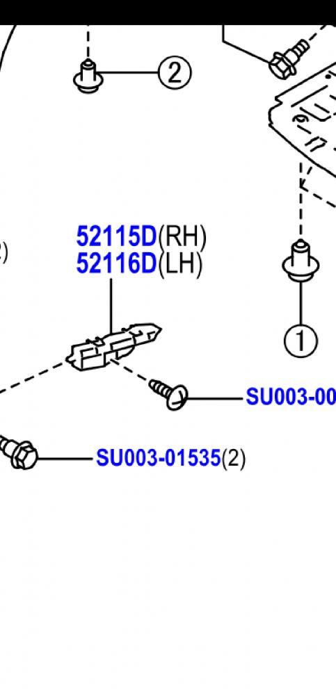

Steve Bodalenko 0 Report post Posted October 1, 2021 Can someone just clarify how many of these ‘clips’ are needed? The diagram shows, I think, three clips on the bumper but only the nearest to the headlight seems to be mentioned and two are mentioned as being needed, not six being the complete set for the bumper side. Most issues relating to the sag seems to relate to the removal of the bumper and damaging the clips by ripping the bumper sides off with great vigour. I remember accidentally finding a YouTube video showing the correct way of removing the bumper without damaging the clips. Of course now when needed I can’t find the video. Has anyone else seen this video or know the correct way of releasing the clips? I think it involved pushing against the side of the bumper with your knee, unlocking the clips/tabs as you gently pull the it away from the fender, Share this post Link to post Share on other sites

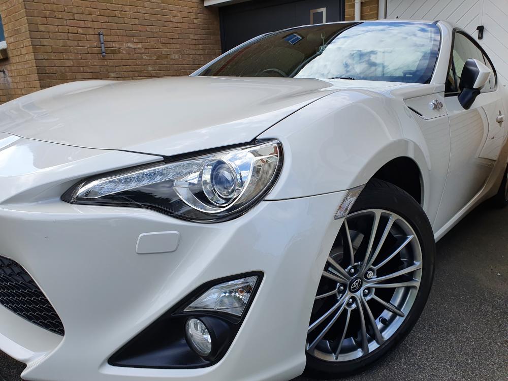

Joolz 6 Report post Posted April 19, 2022 @kodename47 thanks for the installion details and @Conscript thanks for instructions on not having to remove bumper. I ordered some Japanese clips but got my local Toyota on case first, to see if clip issues or something else. My 2017 model, had new bumper fitted and clip on front driver side light seems to have a gap now, and sagging at sides of both a tiny bit. Share this post Link to post Share on other sites

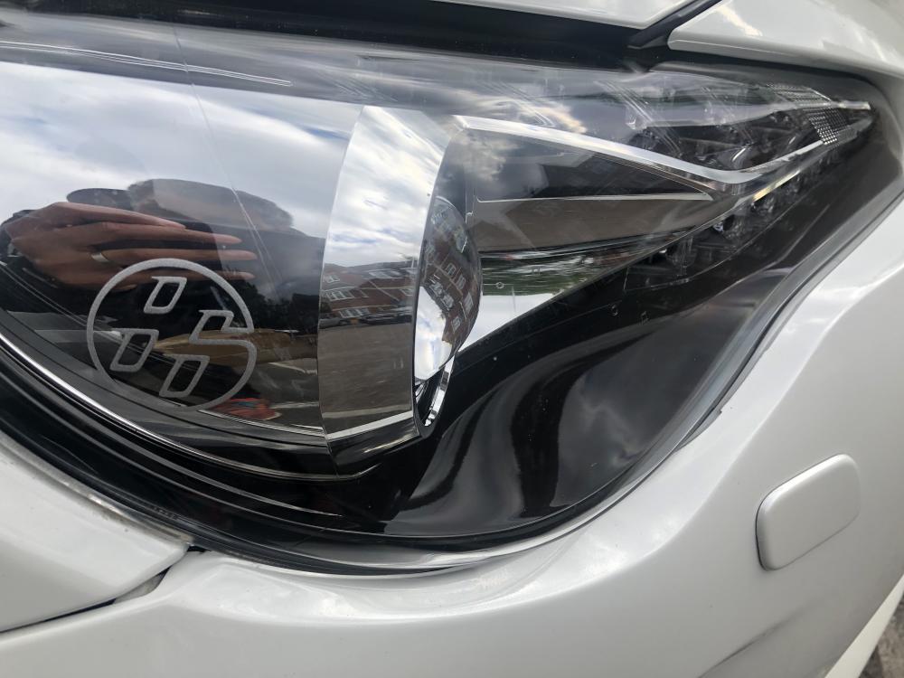

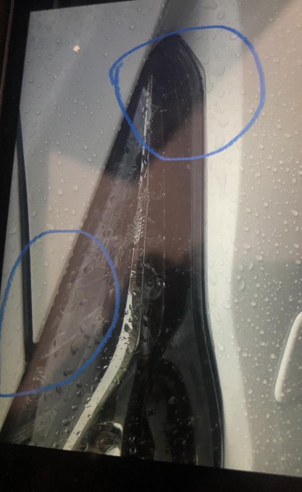

Joolz 6 Report post Posted April 29, 2022 https://www.japanparts.com/parts/detail/49087 My new clips arrived from Tokyo Japan very fast cost £30/£40, not sure how to fit these though as V2 (not sure if that is correct part number as crossed out it seems) so thanks for link above (V1 above looked easier to fit). Toyota declined to fix bumper gap on headlight I have as not under Warranty told me go back to body shop who re fitted new bumper, which is fair enough. I asked for price but none given to re fit by Toyota. My current gap above before and V2 clips. Gonna take clips to body shop. I had a look myself at clips Subaru were not joking, they might as well of made them from play dough they are so soft like all Subaru bumpers/paint it seems. Will post body shop results if they can fix gap on side and headlight/need to heat polyurethane bumper to mould it etc. P.S I saw another red 2017 which also had small gap close to inside of headlight, but bumper seemed fitted underneath headlight unlike mine at moment. Share this post Link to post Share on other sites

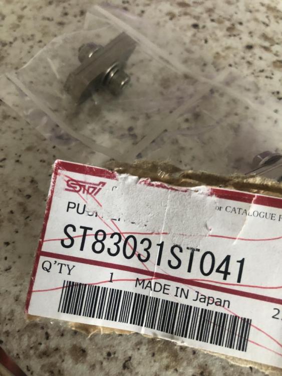

Mike 458 Report post Posted May 1, 2022 You can get the originals from https://www.japanparts.com/parts/detail/?id=59148 - I've got 4 somewhere... 1 Joolz reacted to this Share this post Link to post Share on other sites
Lmc 27 Report post Posted May 2, 2022 Will these repair broken tabs or are they just for reinforcing? Share this post Link to post Share on other sites
Mike 458 Report post Posted May 2, 2022 If there's enough left to stick them to, they'll be fine. Just get some decent glue 2 Lmc and Joolz reacted to this Share this post Link to post Share on other sites
