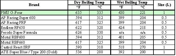

Church 209 Report post Posted December 5, 2018 rbf600 imho is a bit on weak side for one going to track. Better then stock of course, but not that hard to boil it too, doesn't last too long. If one goes to track days, imho worth paying for even better brake fluids (but not pay more, due need to change/drain less). Previous two drains i went with rbf660 but am thinking to switching to endless rf650 or project mu gfour-355, or even to top, - castrol srf. .. but of course for daily driving only, even rbf600 is more then up to job. Share this post Link to post Share on other sites
George 13 Report post Posted December 5, 2018 Oh rite. Funny you say that. Iv had rbf600 in my track civic for a while now and not given me any trouble. Never had them fade or overheat. Although it does have huge brakes and the car doesn't weigh much so this probably helps. Perhaps I'll try something different in the 86 as it's 300 kg heavier. Share this post Link to post Share on other sites
surrey86 352 Report post Posted December 5, 2018 RBF600 is fine and good value, but absorbs water quite quickly. I found it felt a bit off within 9 months or so. It won't be the weak point if you've got OEM brakes. Share this post Link to post Share on other sites
Church 209 Report post Posted December 5, 2018 Well, all good track-worthy brake fluids absorb water at higher rates. So even if never overheated, probably would replace minimum every two years. Then again, for better fluids not just dry but also wet boiling temps are higher. And wet temps .. see, why i mentioned castrol srf despite it's mad price :). For project mu's i like also how it turns from green to clear if absorbs too much moisture, or brown, if gets too hot. Share this post Link to post Share on other sites
surrey86 352 Report post Posted December 5, 2018 No Church, some aren't as bad as others. Replacing fluid every 2 years is very basic minimal level dealer servicing. Btw saying RBF600 isn't good enough for track work is without any basis. The OEM calipers will have fried themselves long before the fluid has boiled. Share this post Link to post Share on other sites
