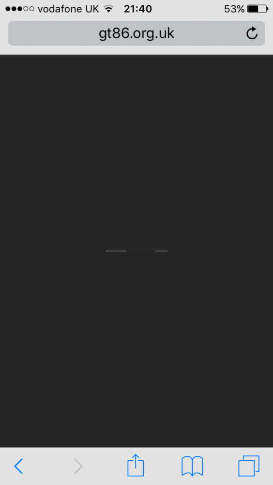

Thanks for the reply and links. I'm sure its related to the drop links too, but I couldn't remove the lower nut on them to test on the jack. I've converted the clip to mp4 which should play on phones. you can see at the bottom it looks like the paint has worn away from movement?
