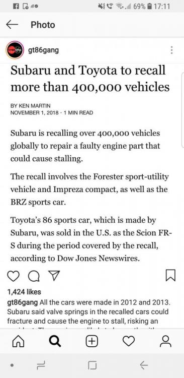

Subota Boy 402 Report post Posted November 4, 2018 So I ask myself, have there been a lot of failures on our cars that led to identification of this problem? I have not noticed stalling highlighted as a problem on forums. Do the failures occur as mileage increases? I notice that Toyota itself has had at least two recalls on its engines for valve spring fracture going back to 2008, on V6 and V8 engines, I believe. So this problem seems to affect more than just the flat four engines of Subaru. Share this post Link to post Share on other sites
TommyC 33 Report post Posted November 4, 2018 52 minutes ago, Subota Boy said: So I ask myself, have there been a lot of failures on cars that led to identification of this problem? I have not noticed stalling highlighted as a problem. Do the failures occur as mileage increases? If the valve spring fractures, what damage is done internally to the engine? Having asked myself, and got no intelligent answers, I am now asking someone with technical know-how to explain to me please. In my limited understanding and own thoughts regarding this, a failure could vary from little impact to quite catasrophic! (I've had some training in early failure detection and oil debris monitoring for Gas Turbine lubrication systems, but only training). Firstly I imagine there have been some impurities in the metal, or problems with heat treatment, which would instigate a crack and eventual failure. (Ever seen a broken suspension spring? You can normally see where the failure originated when you look at the jagged surfaces of the failure point). Depending on where the crack/failure is in the spring may mean it just stops holding the valve closed meaning no compression and no push on the piston. This could also lead to valve-piston collision (if the engine is an interference type). If it's just a small part of the spring (half a coil maybe) then this could break free and float around, get jammed in othe moving parts causing significant damage (wedged in other vale springs and mashed, getting jammed under the cam lobes, interfering with variable valve timing/lift parts and jamming those, floating round in the oil system and jamming other moving components). It's really not a good situation however I think about it 😵 If Toyota/Subaru are going to replace them FOC then I say don't hesitate!! Sorry to be alarmist, but I feel it's not something I'd be putting off! I'd say it's more likely to occur with higher mileage due to the strain (stress over time) of repeated compression-extension cycles. It quite a complex thing to analyse/predict, which is why I think the recall covers so many vehicles... 1 Subota Boy reacted to this Share this post Link to post Share on other sites
Kodename47 446 Report post Posted November 4, 2018 19 minutes ago, TommyC said: This could also lead to valve-piston collision (if the engine is an interference type). It is an interference engine. 1 hour ago, Subota Boy said: So I ask myself, have there been a lot of failures on our cars that led to identification of this problem? I have not noticed stalling highlighted as a problem on forums. Do the failures occur as mileage increases? I think I've read it's 96 stated failures on the range of vehicles/engines stated as being at risk. "Stalling" is a very blanket way of saying failure. As TommyC said, if a valve spring fails it's likely to cause terminal failure of the engine. There have been a number of reports of the rockers failing on early engines in the states, that tends to blow a hole in head. It could well be that a valve spring failure is the cause. 1 Subota Boy reacted to this Share this post Link to post Share on other sites
