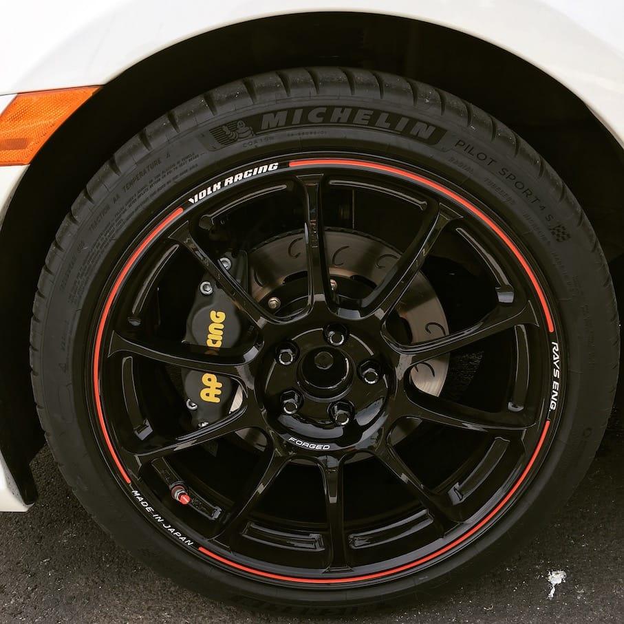

Lauren 2259 Report post Posted July 31, 2018 Welcome aboard. I can see you've been busy with modifying. Interesting on the BBK , as I run a similar setup with the same calipers, but run 330mm discs which still fit under my 17's. Your discs look like they are stock sizes. Those pads seem noisy! I also run DS2500's, though mine are pretty quiet. Any plans for an exhaust or exhaust manifold? The manifold reaps the biggest gains along with a remap. Also I'm guessing suspension is on the list, that makes a big difference also. Also you could shorten the final drive on the auto to bring it closer to the manual which will aid acceleration. 1 Tristor reacted to this Share this post Link to post Share on other sites

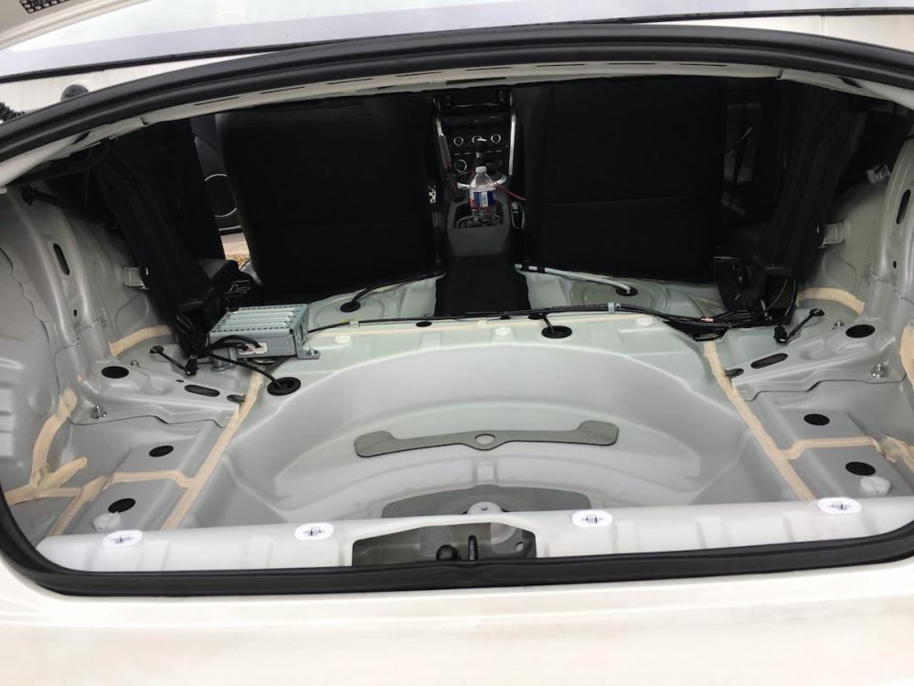

Andrew Smith 156 Report post Posted July 31, 2018 loving the attention to weight saving, what did you have in the boot that was 43.6lbs? 1 Tristor reacted to this Share this post Link to post Share on other sites
Tristor 17 Report post Posted July 31, 2018 1 hour ago, Lauren said: Welcome aboard. I can see you've been busy with modifying. Interesting on the BBK , as I run a similar setup with the same calipers, but run 330mm discs which still fit under my 17's. Your discs look like they are stock sizes. Those pads seem noisy! I also run DS2500's, though mine are pretty quiet. Any plans for an exhaust or exhaust manifold? The manifold reaps the biggest gains along with a remap. Also I'm guessing suspension is on the list, that makes a big difference also. Also you could shorten the final drive on the auto to bring it closer to the manual which will aid acceleration. Howdy Lauren, Yep I've been keeping an eye on your build as well. I'm going to do two more track days with instruction and then see where the next step is. My goal right now is primarily to focus on things that allow for weight reduction, but a little extra power wouldn't hurt, so I'm thinking a full exhaust and tune might be a next step. That should let me cut some weight, get 20-30hp in gains, and why not. For the suspension I'm still split and haven't yet made a decision, there's three different coilover systems I'm considering and I currently have some active correspondence to try to understand what is the right choice for my use case. Right now is seems very likely I'll end up with RCE Tarmac 2s, which are improved KW Clubsports. In either case, when I do the suspension I'm going to replace all components in the suspension at once with lightweight components that enable full adjustability. Then have my alignment tuned at my local performance alignment shop. I'll of course also add the appropriate bushings and bracing to stiffen things up on the chassis otherwise. I hadn't yet considered modifying the final drive, but that's a good idea. I haven't touched the diff yet, but depending on how temps play out over the next couple of months I may be adding an oversized diff cover to allow it to hold more fluid and cool itself better, in the process it wouldn't be too terrible to swap the FD gear. Not sure I want to take that on yet though. Meanwhile, I'm doing as much driver mod as I can. I've lost 28 pounds (2 stone), and I've been to multiple tracks and sought instruction at each now. It's pretty likely suspension will be next up on my list, but I may go ahead and do the exhaust (or hell, both at the same time). In either case there probably won't be any more part mods until into next year when I get my next tax refund 1 Lauren reacted to this Share this post Link to post Share on other sites
Tristor 17 Report post Posted July 31, 2018 19 minutes ago, Andrew Smith said: loving the attention to weight saving, what did you have in the boot that was 43.6lbs? Yep, I figured at the end of the day it's all about power to weight ratio and reducing unsprung mass as much as possible. The rear seat bases weight 6.2 pounds each, the 1-piece rear seat back weighs 15.0 pounds, the rear plastic panels weigh 3.0 pounds each, each rear floor mat weighs 0.4 pounds, the c pillar covers weigh 0.5 pounds each, all of the hardware for the rear seats and seatbelts together weighs 11.25 pounds. The Shrader Performance Rear Seat Delete weighs a shade over 19 pounds when installed (most is the center steel bracket), so I figure around 27 pounds cut by doing the rear seat delete. In reality it's more because when I go on track I take out the rear panel and both seat well covers, but just cruising down the street it helps NVH especially since my trunk is bare. The carpeted trunk liner weighs 2.4 pounds, and I also had the all-weather rubber mat over it which weighed 3.8 pounds. Underneath is the spare tire, spare tire mounting hardware, and two foam inserts which hold tools. The spare tire with its foam liner and hardware weighs 25.8 pounds, the tools and foam together weigh 5.8 pounds. The plastic trim together in the trunk weighs around 5.9 pounds, which comes up with the rest. This photo showed what my trunk looked like during my initial stripping to install the rear seat delete and rear strut bar. I don't have a better photo right now, but basically it's the same except that you can't see into the cabin because the rear seat delete has a carpeted chloroplast panel that goes where the seat back would have gone and clips into the rear deck and there's a rear strut bar installed. I also put the plastic lip and trunk latch hardware back into place, which is why it's not counted in my weight reduction figures. Obviously I need to be able to close my trunk I zip-tied the inside trunk button thing onto a convenient hole in the sheet metal so it wouldn't flop around. Share this post Link to post Share on other sites

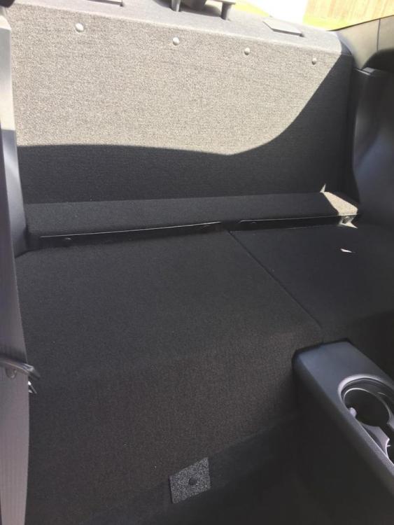

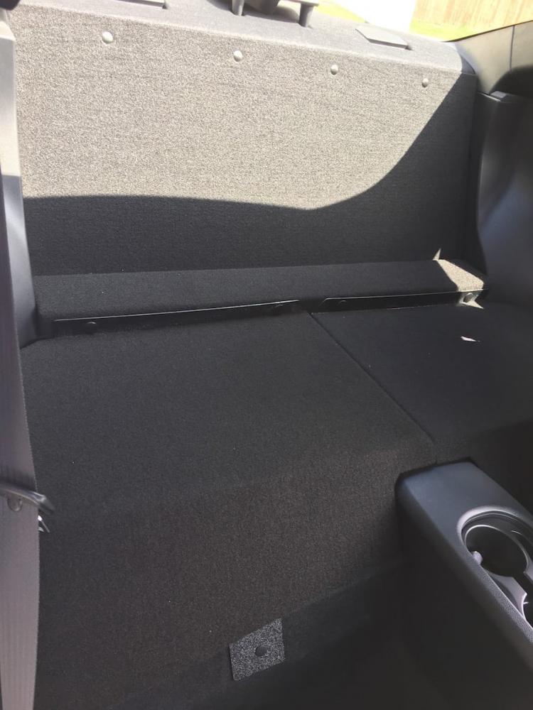

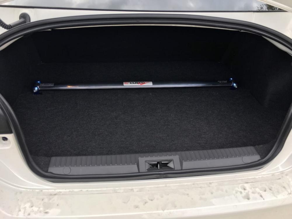

Tristor 17 Report post Posted July 31, 2018 Here's some old photos. Originally with the rear seat delete installed I had reinstalled the side panels and C pillar covers, but I got tired of taking them back out and just left them out. Most of the NVH in the car comes from underneath anyway. Here you can see I carefully put everything back into the trunk when installing the strut bar and cut the carpeted mat to fit snugly. Anyway, same story. I got tired of taking it all out to go to the track. Very specifically because of how I cut the carpeted mat it requires me to unbolt the rear strut bar to completely remove the carpeted mat and with the strut bar bases in place, it is difficult to remove the side plastic trim. In the end I got lazy and just left it out to keep the weight reduction all the time. Share this post Link to post Share on other sites

will300 812 Report post Posted July 31, 2018 Welcome @Tristor, looks like you've got a really good setup there. 7 hours ago, Lauren said: Interesting on the BBK , as I run a similar setup with the same calipers, but run 330mm discs which still fit under my 17's. Your discs look like they are stock sizes. Lauren, the AP Sprint kit that Tristor is running a completely different type of caliper to ours. 1 Lauren reacted to this Share this post Link to post Share on other sites

Paul 442 Report post Posted July 31, 2018 I am digging that rear seat delete. 1 Tristor reacted to this Share this post Link to post Share on other sites

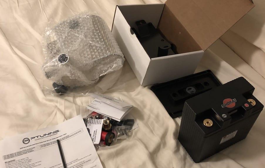

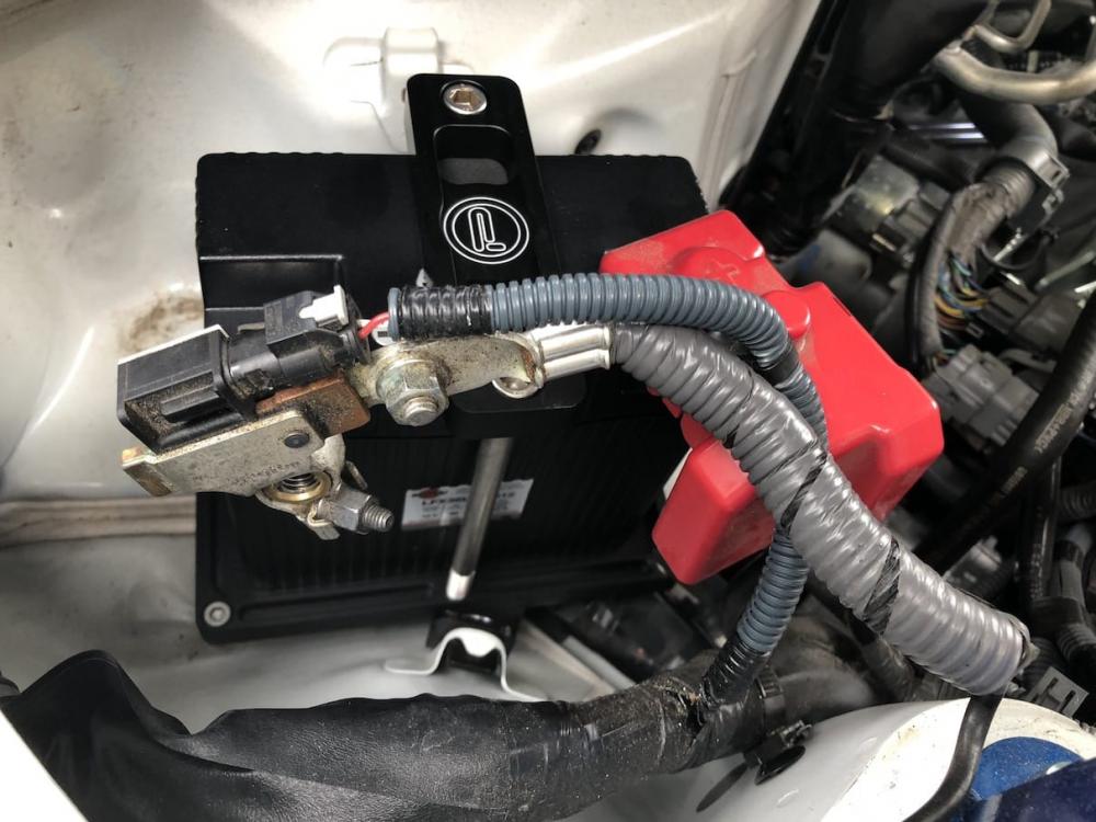

Tristor 17 Report post Posted September 22, 2018 Quick update here, I installed the PTuning lightweight battery tray and a Shorai LFX36L3-BS12 4.8lb battery today. Looks like I'm still not going to be able to make it to the track this weekend, but I am eager to get some more seat time in and also to wear out this set of tires so I can get some AD08Rs or some other 200tw tire. The lightweight battery setup cut about 27lbs off the front and should help offset the extra weight from the engine oil cooler and transmission fluid cooler I installed. I've also got a windshield washer reservoir to install which will help cut weight and make space for brake ducts in the future. I've updated the first post in this thread and here's some photos. Share this post Link to post Share on other sites
