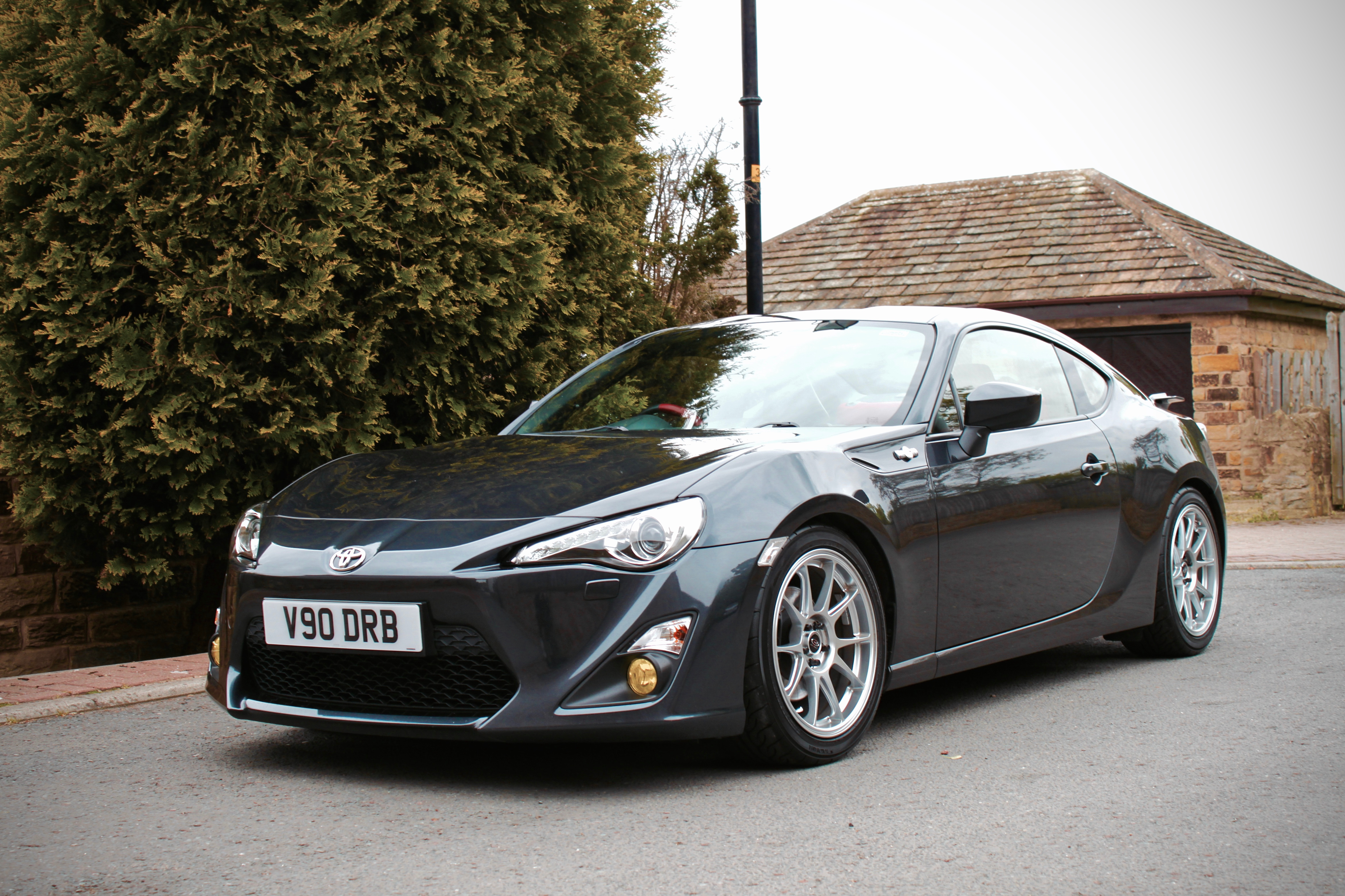

Don’t know if the pic came through but I think I’m already sat at an 1” drop with the tein springs..
always been told no more than 1” on stock suspension when buying lowering springs

Yeah I have the tein springs on atm... but there’s still to much arch gap for me 😂😂 I cant fault the springs I’ve got on not crashy it anything at all just need that bittt more I’m want the 1 finger rule not 2 finger rule lol

I have recently put the BC BR (cheapest) coilovers on my car and in the softest setting they're much more comfortable for daily use compared to the stock suspension and even the Mrs noticed the difference straight away!
I'm yet to have a fiddle with settings as it currently ticks all the boxes for the driving I'm doing at the moment - primarily bumpy Yorkshire A/B roads :D
Doing a track day at Anglesey in August so plan on having a fiddle with them whilst there B)
There seems to be a good range of height adjustment too. The rears will go about 10-15mm lower and the fronts about an inch lower compared to pic below.
