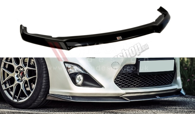

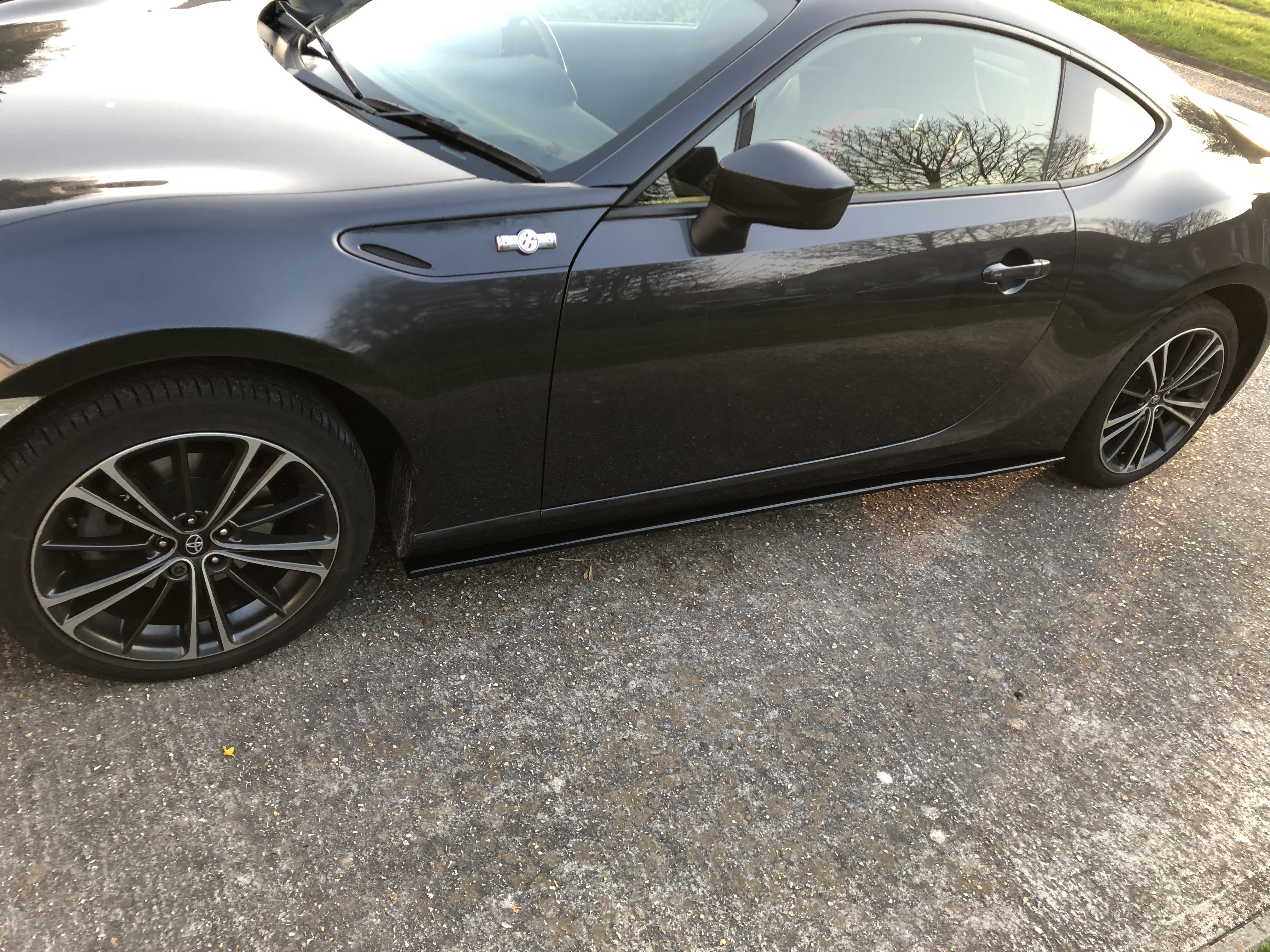

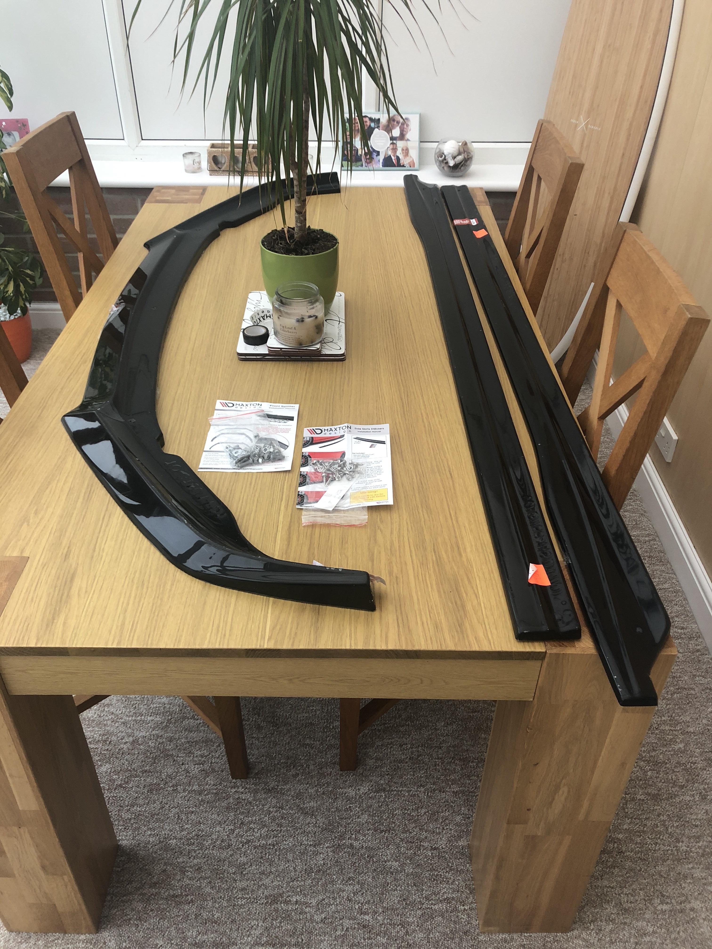

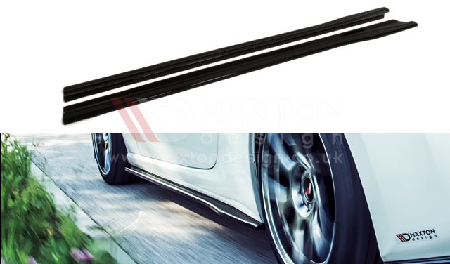

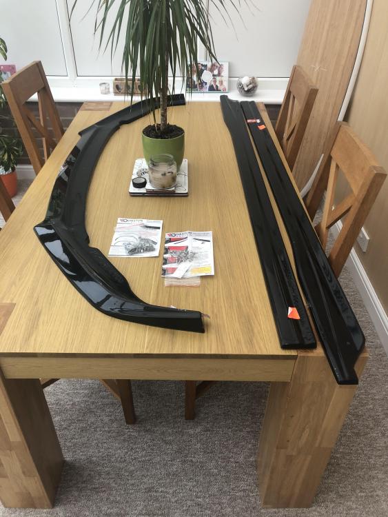

Not really, I looked at both and I think Maxton side skirts look a tad better in my opinion. I’m pretty evens on the look of the front splitter. Either way, I’m looking forward to getting them fitted.

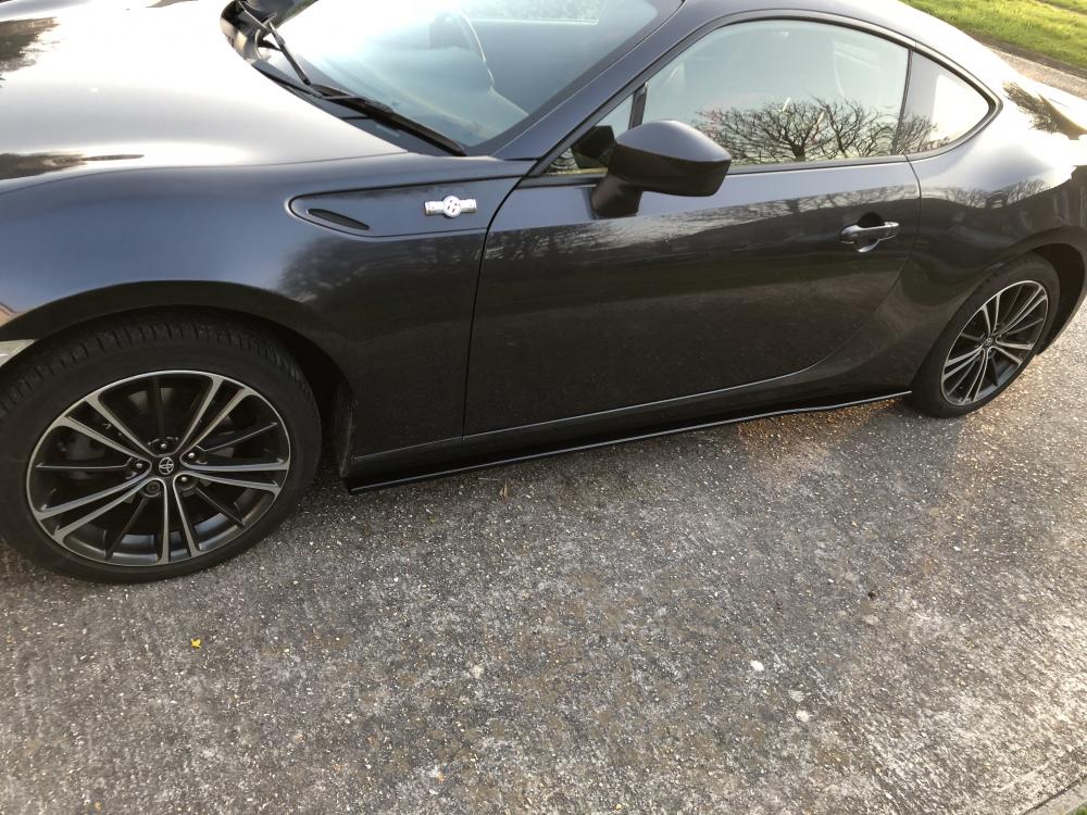

Car still looks smart with just the Side Skirts and Rear Side Splats.

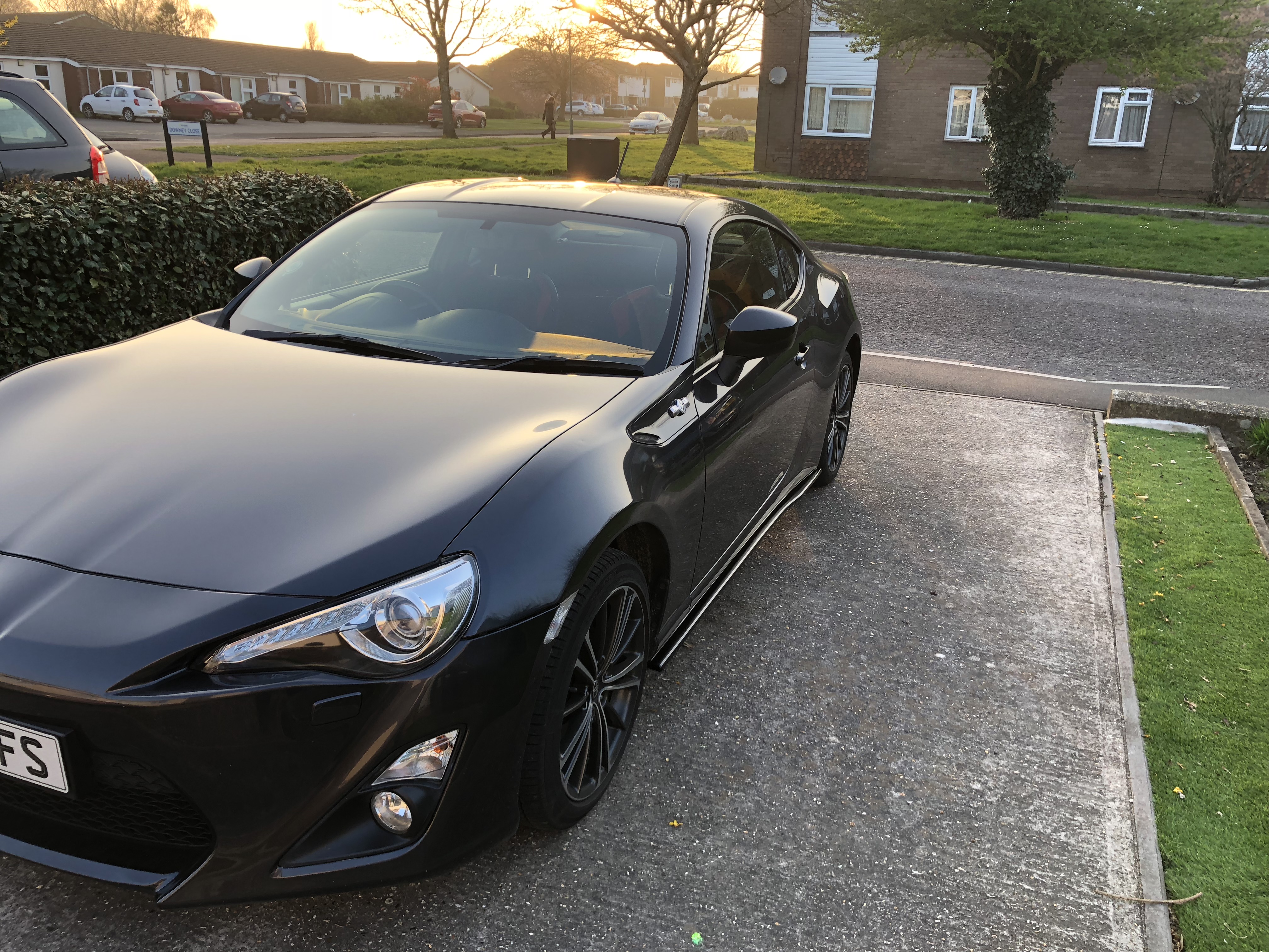

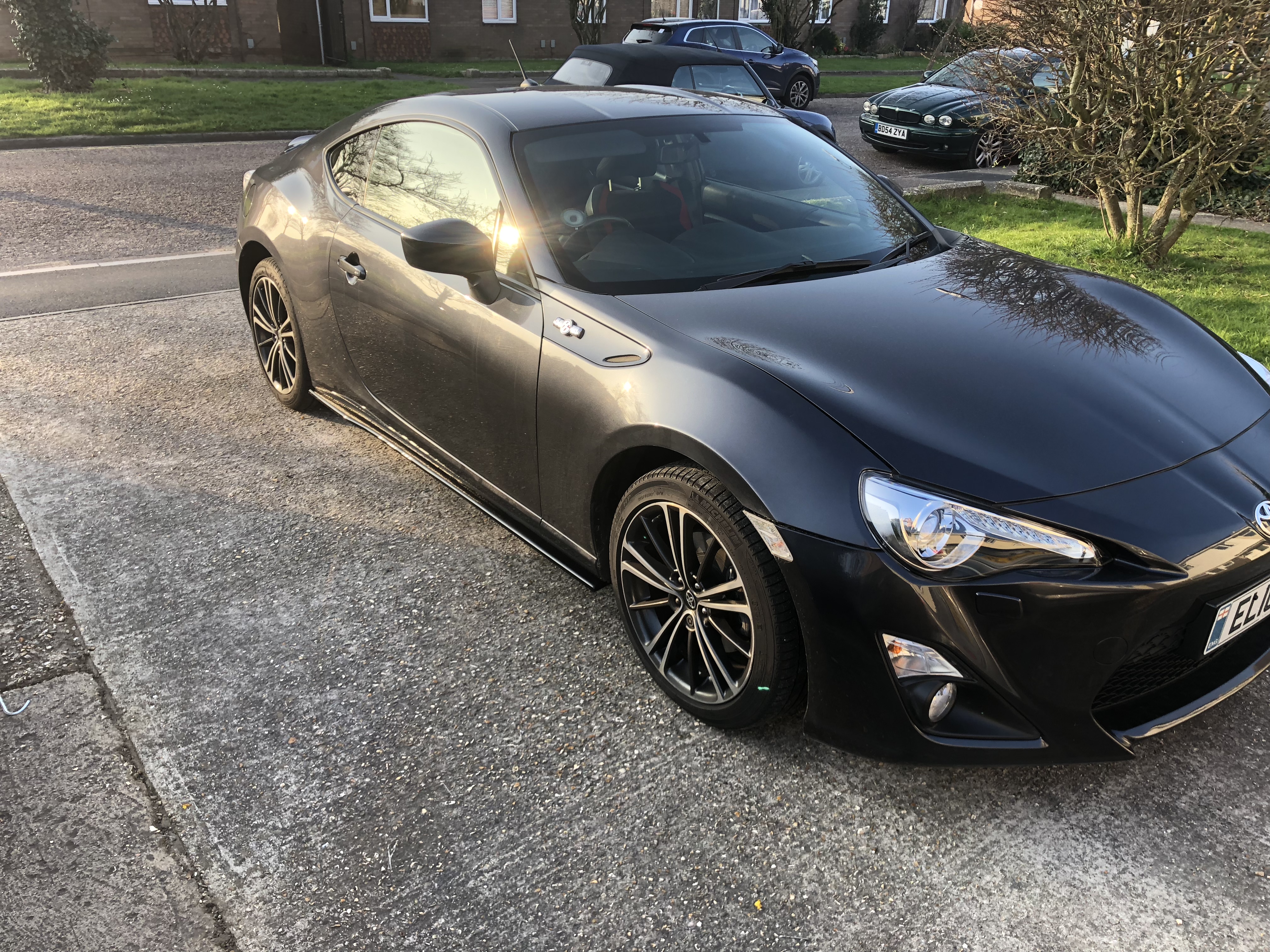

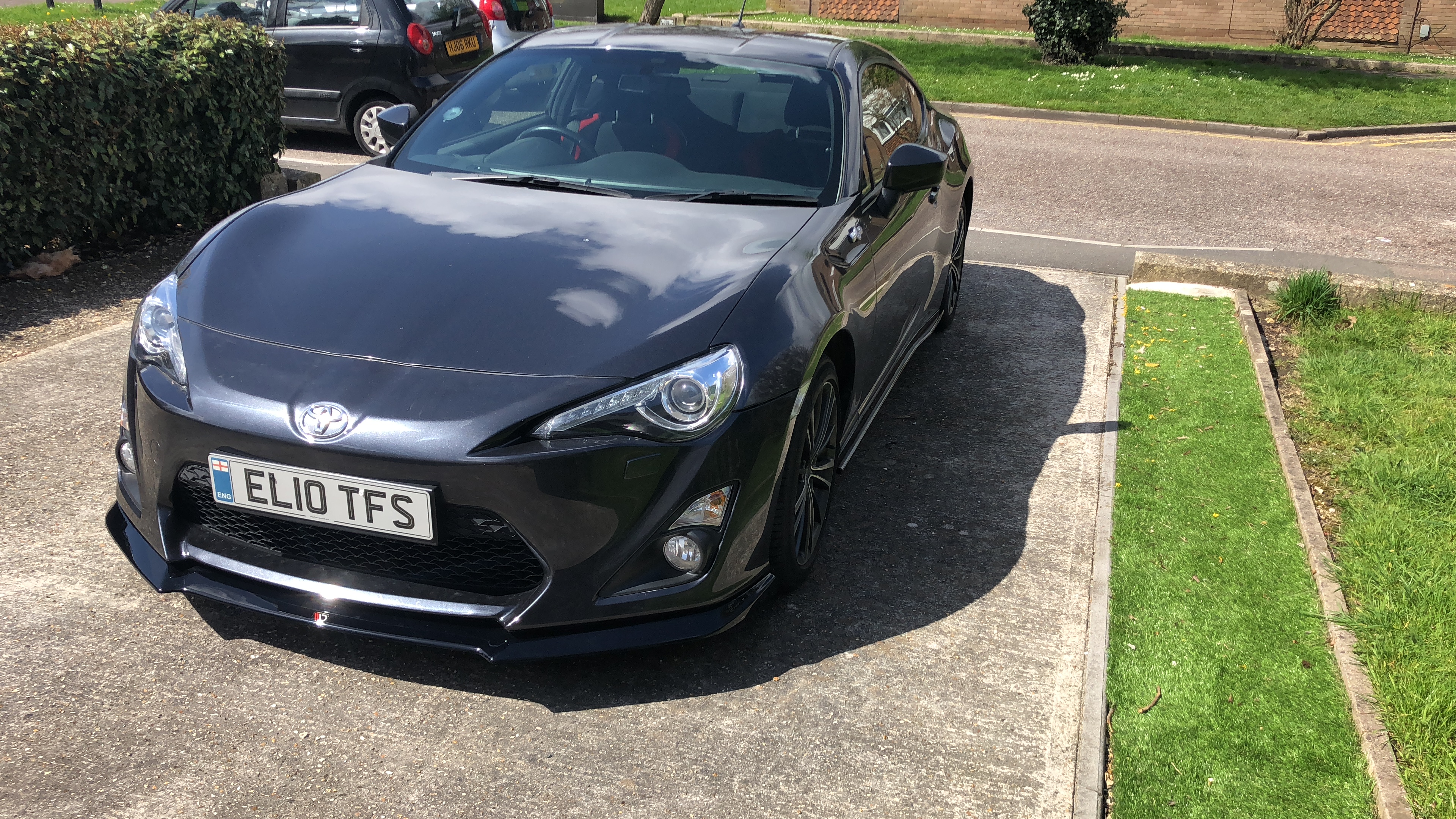

Happy with the splitter, looks great & I can get on & off the drive. Ready for some sunny days now.
Looks really good!
What is the ground clearance from the bottom of the splitter? I'd like to get one but i'm 25mm lowered so I'm a bit vary.

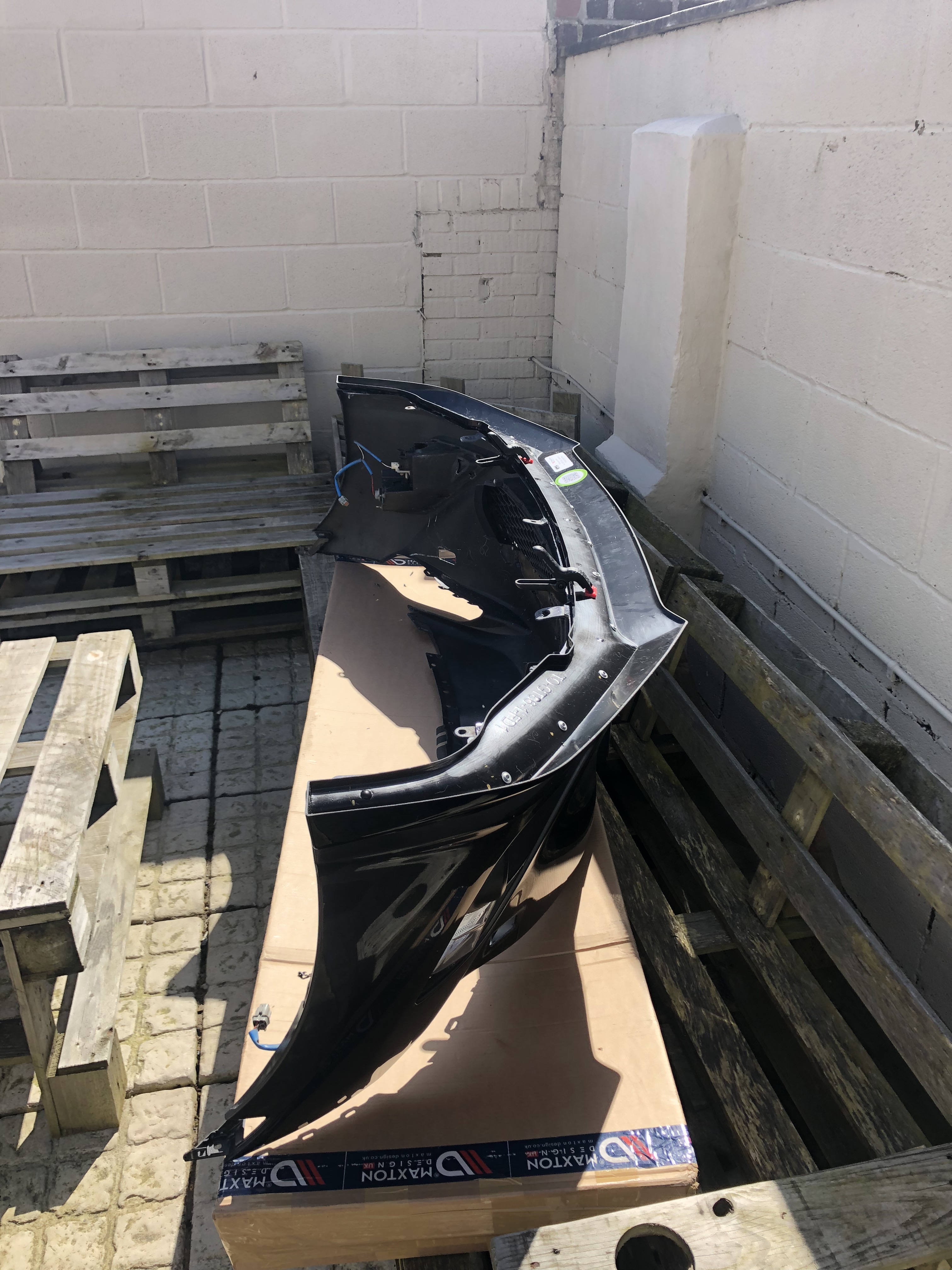

Any drilling required or do they utilise existing holes?
You have to drill x14 holes and bolt it on, I took the bumper off as it is a world easier. You also need some sealant/adhesive to go on, I used a silicone based one so if it ever needs replacing it won't be to horrendous to get off.
left my Maxton front splitter at Croft after a TSS sprint, on the straight the downforce ripped it clean off :( so make sure it is bolted on well.
I’ve put silicone sealant/adhesive across all of it and used 14 bolts with penny washers. Fingers crossed should be ok. How many fixings did you have on yours?

Just over 130mm, I’d be getting worried if it was lowered. I need the clearance as it’s my day to day car.
