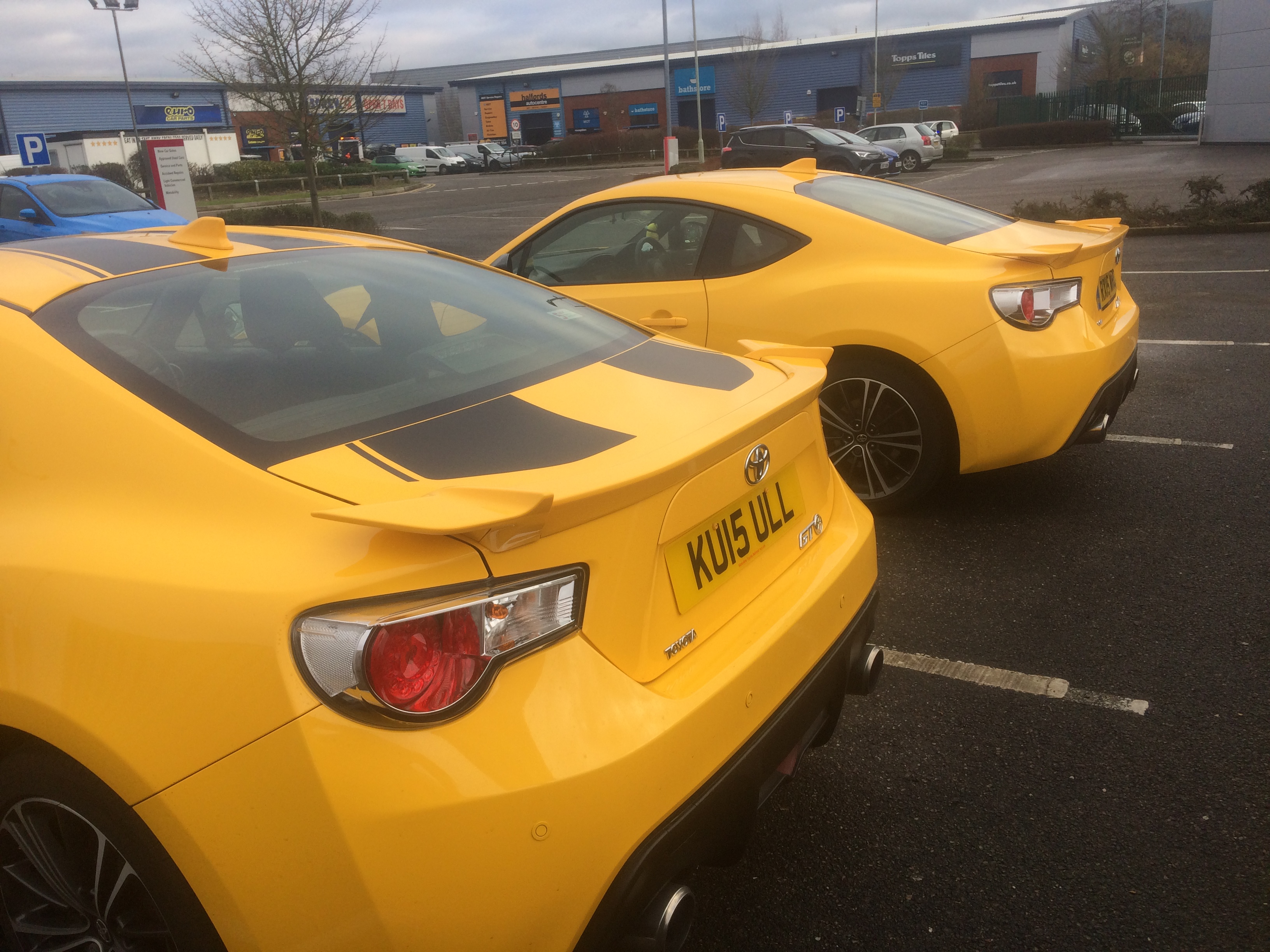

So I picked up my Giallo 86 yesterday evening and have been getting used to the car.
Generally I’m over the moon with the car, it drives superbly.
I picked up on a couple of things that I’m not sure about. It could be that I’m not used to the car or they could be faults:
2nd gear seems like hard work. Some times it slips in fine, other times (particularly down shifting) it is hard work. Should I be taking it back to Toyota to get this rectified or is it just the character of this model?
Cruise control - I can’t get it to work at all. It sets the speed and the light comes on but the cruise doesn’t seem to engage. I checked the manual and I appear to be doing it right but maybe I’m missing something obvious. Otherwise it is not working.
Tailgate needs a proper hard slam to shut, is this normal.
I need to change the head unit as the volume knob is tiny and so smooth it is almost unusable.
Everything else is absolutely amazing!
My company car is an S3 which is quick but a bit sterile, I dont feel disappointed in the engine performance on the 86. Quite the opposite, I was pleasantly surprised after many reviews led me to believe it is underpowered .
When there is a break in the weather I’ll post some proper pics! 5bb520cd6a3e6db893fc8d31ecf1937e.jpg
