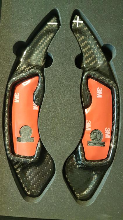

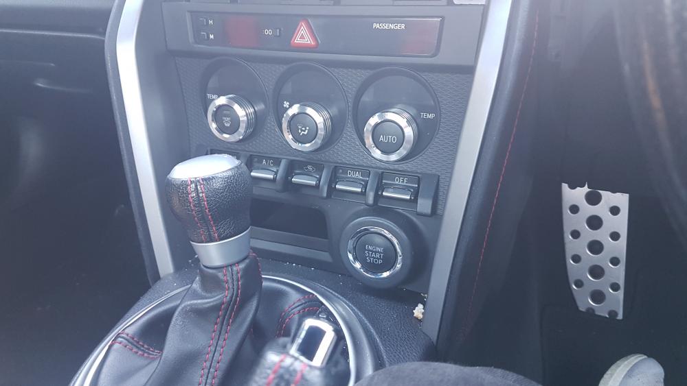

Tim86 24 Report post Posted May 9, 2017 April (continued): Interior bits! Now that the wheels and suspension is on it's time to add some subtle touches to the interior. Thanks to the taobao asian markets i settle for some brushed steel AC knobs & gauge trim, 'T-Carbon' flappy paddle extensions and steering wheel badge. The latter is discontinued but luckily some dude in asia was selling one that he had never installed. The gauge rings were the hardest to install due to a little bit of brute force being required to remove the top section of the dash. However, it was relatively simple, only requires a screwdriver and there are several videos on youtube. Although this is just the start for my interior, the result already transforms the feel inside the cabin. 1 Keethos reacted to this Share this post Link to post Share on other sites

Tareim 343 Report post Posted May 9, 2017 Those carbon paddles look much better than the ally ones I bought for mine and they look like they actually fit properly 1 Tim86 reacted to this Share this post Link to post Share on other sites
Cerastes 204 Report post Posted May 9, 2017 Nice good read, I read it all... test me go on I have the same air con controls on mine I also put a bit of Carbon fibre effect above them where the hazard light button is. I thought about the Gauge rings too; tempted on them. Agree on Fensport too, wonderful service. Keep us updated on the Meister R's, I'm really tempted by them even though I don't track the car (yet... however the £800 or so is a lot for me). 1 Tim86 reacted to this Share this post Link to post Share on other sites

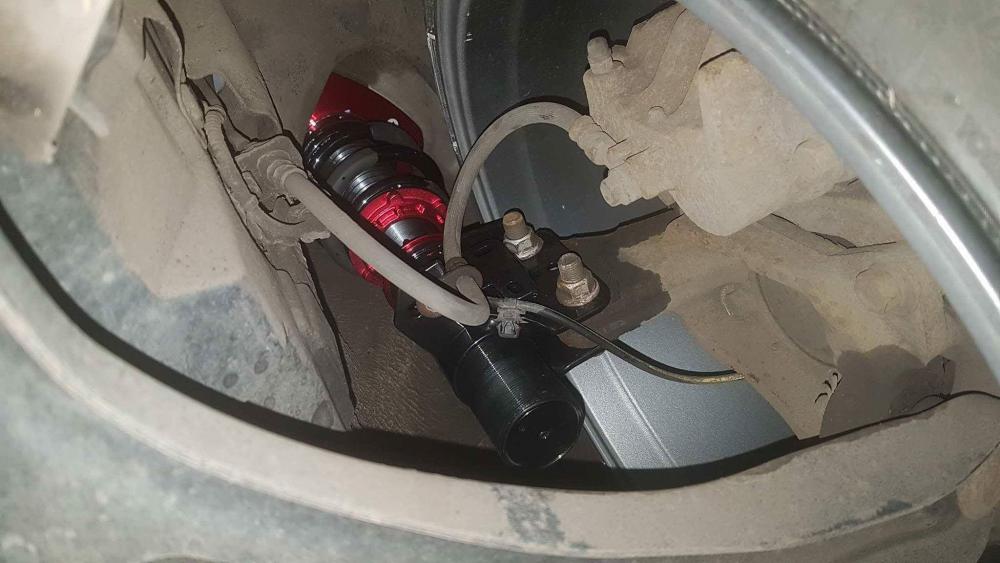

Deacon 1357 Report post Posted May 9, 2017 15 hours ago, Tim86 said: These are 32 stage damping adjustable mono-tube dampers (compression & rebound combined). The spring rates of the ZetaCRD+ come out at 5/4 is because of the vehicle dynamic calculation that they do. On the GT86, when you are on the low end of spring rates for fast road, a 5/5 setup is a bit too close between the front and the rear so you could hit a harmonic frequency. The choice then is either 5/4, or 6/5. So they opted for the 5/4 in the end because it suits the requirements of a balanced fast road & track car better. Car's looking very good and I'm looking forwards to reading your further updates. Just a couple of points on the suspension - the damping won't really do anything below 16 clicks from fully stiff - it's pretty much as soft as it'll get at this point (this comes from Black Art Designs who help design the Meister R stuff from when I had it on my car briefly). The spring rates they've used now will tend to make the car understeer quite a bit as the suspension design on the 86 means that the front spring rate has an effective rate of 0.925 on the front and 0.75 on the rear if I remember correctly (so front will equate to 4.23 and rear to 2.25). Stock (up to the 2017) is 2.3kg front and 3.8 rear (again, iirc) which equates to 1.97 front and 2.14 rear. So stock is slightly rear biased whereas the Meister R set up is quite front biased which will equate to understeer so a stiffer rear ARB would be a good idea to try to restore the stock balance. The main reason for the softer spring rate at the rear I'd suggest is road comfort rather than ride frequencies as the suspension at the rear is rather space limited. 3 Tim86, surrey86 and Cerastes reacted to this Share this post Link to post Share on other sites
Tim86 24 Report post Posted May 9, 2017 2 hours ago, Tareim said: Those carbon paddles look much better than the ally ones I bought for mine and they look like they actually fit properly They do! I had the same problem with those so I opted for these. In my opinion it was well worth it and I'm very satisfied with them. Being carbon they are a little more expensive, but entirely worth it imo as you'll stare at them all the time. Share this post Link to post Share on other sites
Cerastes 204 Report post Posted May 9, 2017 46 minutes ago, Deacon said: Car's looking very good and I'm looking forwards to reading your further updates. Just a couple of points on the suspension - the damping won't really do anything below 16 clicks from fully stiff - it's pretty much as soft as it'll get at this point (this comes from Black Art Designs who help design the Meister R stuff from when I had it on my car briefly). The spring rates they've used now will tend to make the car understeer quite a bit as the suspension design on the 86 means that the front spring rate has an effective rate of 0.95 on the front and 0.76 on the rear if I remember correctly (so front will equate to 4.75 and rear to 3.04). Stock (up to the 2017) is 2.3kg front and 3.8 rear (again, iirc) which equates to 2.2 front and 2.8 rear. So stock is slightly rear biased whereas the Meister R set up is quite front biased which will equate to understeer so a stiffer rear ARB would be a good idea to try to restore the stock balance. The main reason for the softer spring rate at the rear I'd suggest is road comfort rather than ride frequencies as the suspension at the rear is rather space limited. Maybe I don't want the Meister R's then Just keep it stock then, I like the back end coming out Share this post Link to post Share on other sites
Tim86 24 Report post Posted May 9, 2017 1 hour ago, Deacon said: Car's looking very good and I'm looking forwards to reading your further updates. Just a couple of points on the suspension - the damping won't really do anything below 16 clicks from fully stiff - it's pretty much as soft as it'll get at this point (this comes from Black Art Designs who help design the Meister R stuff from when I had it on my car briefly). The spring rates they've used now will tend to make the car understeer quite a bit as the suspension design on the 86 means that the front spring rate has an effective rate of 0.95 on the front and 0.76 on the rear if I remember correctly (so front will equate to 4.75 and rear to 3.04). Stock (up to the 2017) is 2.3kg front and 3.8 rear (again, iirc) which equates to 2.2 front and 2.8 rear. So stock is slightly rear biased whereas the Meister R set up is quite front biased which will equate to understeer so a stiffer rear ARB would be a good idea to try to restore the stock balance. The main reason for the softer spring rate at the rear I'd suggest is road comfort rather than ride frequencies as the suspension at the rear is rather space limited. You just pointed out a typo actually, I'm 18 clicks from soft, not stiff (doh). Although it's interesting to hear that anything on that side of 16 isn't going to do much. Thanks for the tips, looks like my next step will be a stiffer rear ARB. Assuming I'll have to get tracking done again on the rear once fitted. Just out of curiosity, what setup did you opt for when coming from MeisterR? And were you on Zetacrd, Zetacrd+ or their GTs? Share this post Link to post Share on other sites
Tim86 24 Report post Posted May 9, 2017 22 hours ago, Cerastes said: Maybe I don't want the Meister R's then Just keep it stock then, I like the back end coming out I'd actually go so far as to say that if you want comfort on British roads, this is still the setup to go for, as you can rely on a stiffer ARB to get the desired handling characteristics. Yes it's an old school rally style approach but you have to bear in mind that we have terrible roads in the UK whereas in places like the USA market (where the majority of performance coilovers are sold) the roads are mostly flat and smooth. Hence the tendency for insanely stiff rates on many 'fast road' coilover setups today. Share this post Link to post Share on other sites
Cerastes 204 Report post Posted May 9, 2017 More comfortable than the stock springs? I always thought coilovers were harder as they are aimed at semi racing/semi road or full racing. Share this post Link to post Share on other sites
Deacon 1357 Report post Posted May 9, 2017 6 minutes ago, Tim86 said: Just out of curiosity, what setup did you opt for when coming from MeisterR? And were you on Zetacrd, Zetacrd+ or their GTs? I was on the GT's and then the Zeta R's as a get me home suspension for a few weeks. I went to the Tein Flex A's afterwards which were a night and day improvement over the Meister R's. I think @don had a set of the CRD's fitted recently but is moving to the Flex A's too I believe (apologies if I'm mixing you up with someone else @don and you weren't who I was talking to at the TD meet!) Share this post Link to post Share on other sites
Tim86 24 Report post Posted May 9, 2017 Just now, Deacon said: I was on the GT's and then the Zeta R's as a get me home suspension for a few weeks. I went to the Tein Flex A's afterwards which were a night and day improvement over the Meister R's. I think @don had a set of the CRD's fitted recently but is moving to the Flex A's too I believe (apologies if I'm mixing you up with someone else @don and you weren't who I was talking to at the TD meet!) Interesting, as stated I too was interested in the flex A but they weren't mono tubes and £300 more expensive. I believe those are a 6k/6k setup? Share this post Link to post Share on other sites
Deacon 1357 Report post Posted May 9, 2017 Yes they are 6/6 as standard although it's better not to get hung up on spring rate as the damping has a massive role to play. They're twin tubes which is one of the reasons they ride so well (twin tubes have a better ride than monotubes usually) along with the hydraulic bump stop system they use. 1 Cerastes reacted to this Share this post Link to post Share on other sites
Deacon 1357 Report post Posted May 9, 2017 Apologies in that I'd forgotten to square the wheel rate figures so I've done that now. For reference the 6/6 set up gives 5.13 front and 3.34 rear so also front biased. 1 Tim86 reacted to this Share this post Link to post Share on other sites
Cerastes 204 Report post Posted May 9, 2017 @Deacon Are you a Tein salesman, I'm sold... *looks up prices of Flex A's* Share this post Link to post Share on other sites
Deacon 1357 Report post Posted May 9, 2017 Just now, Cerastes said: @Deacon Are you a Tein salesman, I'm sold... *looks up prices of Flex A's* Haha! No. I've just been through quite a few suspension set ups and of the ones I've tried the flex a seemed the best road biased set up. I've only tried 6 setups so this isn't conclusive by any means though and is just my experience and opinion! Share this post Link to post Share on other sites
DanJ 374 Report post Posted May 9, 2017 If you want to have a play about with spring and ARB rates this spreadsheet I made should come in handy: https://dl.dropboxusercontent.com/u/87478421/GT86 and BRZ Spring and ARB Rate Comparison.xlsx As Deacon pointed out you really need to convert spring rates in to wheel rates to understand the difference in steady-state cornering balance you get with different setups. Happy to answer any questions you might have about how the spreadsheet works. 2 Tim86 and Deacon reacted to this Share this post Link to post Share on other sites
Lauren 2259 Report post Posted May 9, 2017 2 hours ago, Cerastes said: Maybe I don't want the Meister R's then Just keep it stock then, I like the back end coming out Or go for 5/6kg spring rates as I did. Makes it a bit more pointy than stock and with negative camber and a slight reduction in rear toe, there is no understeer at all. I must admit, I don't get why some aftermarket coilovers thinking HKS and Meister R go for a softer rear. But I guess they err on the safe handling side which may be preferable for some, though I'm no fan of understeer myself. 1 TTR reacted to this Share this post Link to post Share on other sites
Tim86 24 Report post Posted May 9, 2017 1 hour ago, Deacon said: Yes they are 6/6 as standard although it's better not to get hung up on spring rate as the damping has a massive role to play. They're twin tubes which is one of the reasons they ride so well (twin tubes have a better ride than monotubes usually) along with the hydraulic bump stop system they use. I was told the hydraulic bump stops are not needed in those mono-tubes, that only benefits a twin tube design. I guess that's a reason why the flex A's are a fair bit more expensive. Fair play though, a great choice from what i've heard. Share this post Link to post Share on other sites
Lauren 2259 Report post Posted May 9, 2017 Hydro bump stops are a nice addition to the Flex A's. I have the older Flex (been on my car for over three years and 70K miles now). I'm guessing you were told they don't need them because they don't have them. It's a bit of a USP for the Flex A's. In regard to spring rates, I was able to spec my own spring rates and also had the rear dampers shimmed to increase the damping by 20%. It's the personalised touch I value. Share this post Link to post Share on other sites
