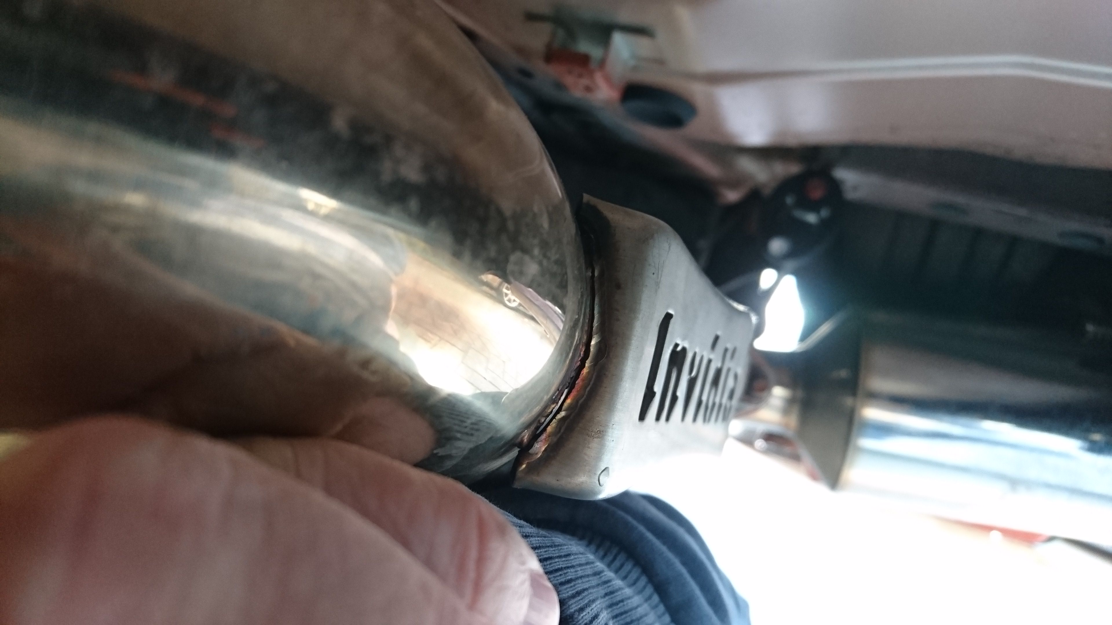

Nemo 24 Report post Posted November 13, 2016 I think i found the problem, or at least hope I have. The Invidia name plate that is welded on to the exhaust has broken its welds on one side. I have no welding tools, so some high temp epoxy weld is probably the best option at the moment as its not structural. Share this post Link to post Share on other sites
Simonnnn 2 Report post Posted November 13, 2016 you could jam a bit of tin foil in the gap to check if it makes a difference. 1 Nemo reacted to this Share this post Link to post Share on other sites

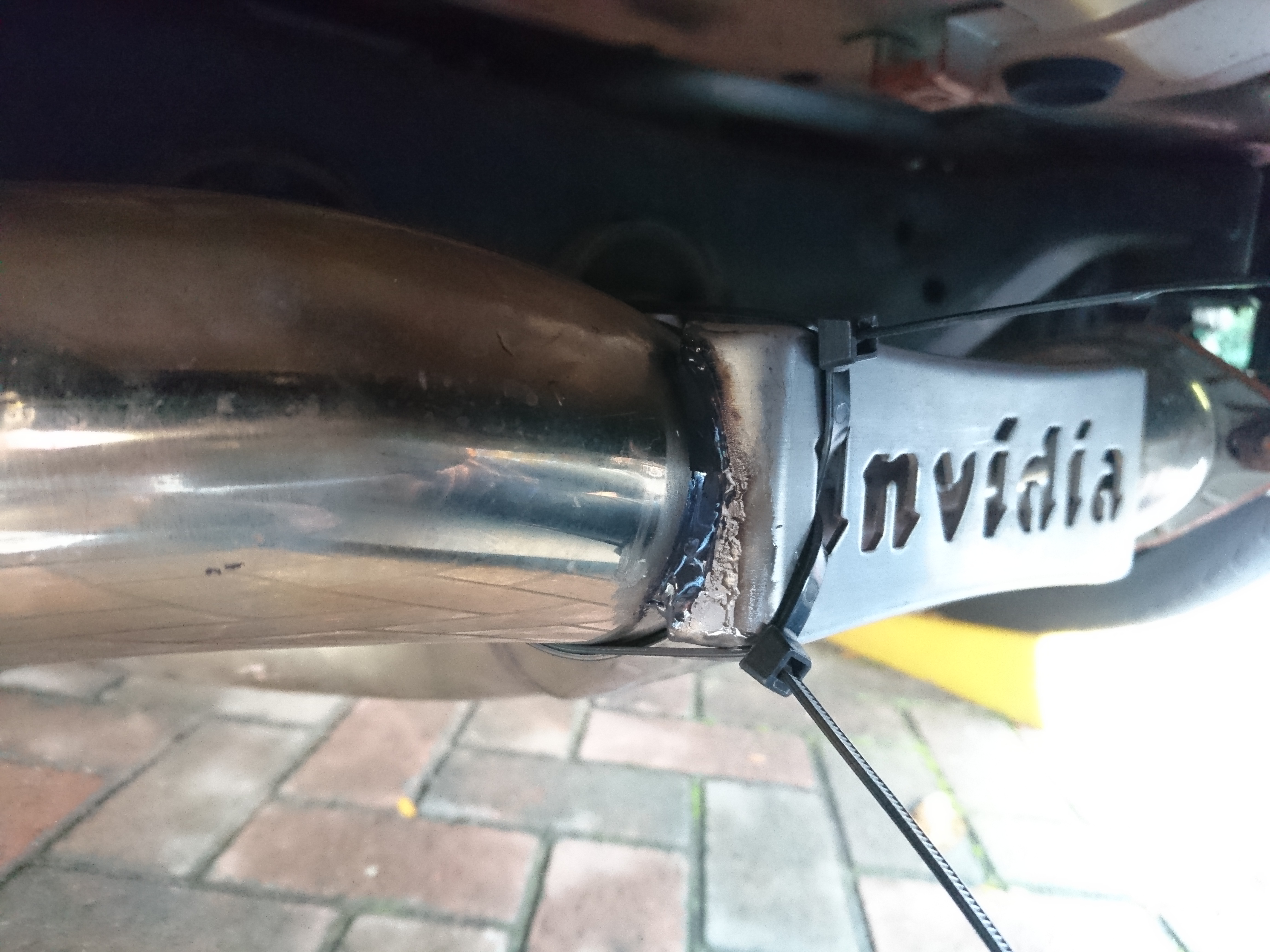

Nemo 24 Report post Posted November 13, 2016 1 hour ago, Simonnnn said: you could jam a bit of tin foil in the gap to check if it makes a difference. Thanks. I took a chance with Epoxy, and it seems to have solved the problem! Cable ties just whilst it cured. Good feeling being able to overtake people without sounding like my car is falling apart! (which technically it was...) Share this post Link to post Share on other sites
