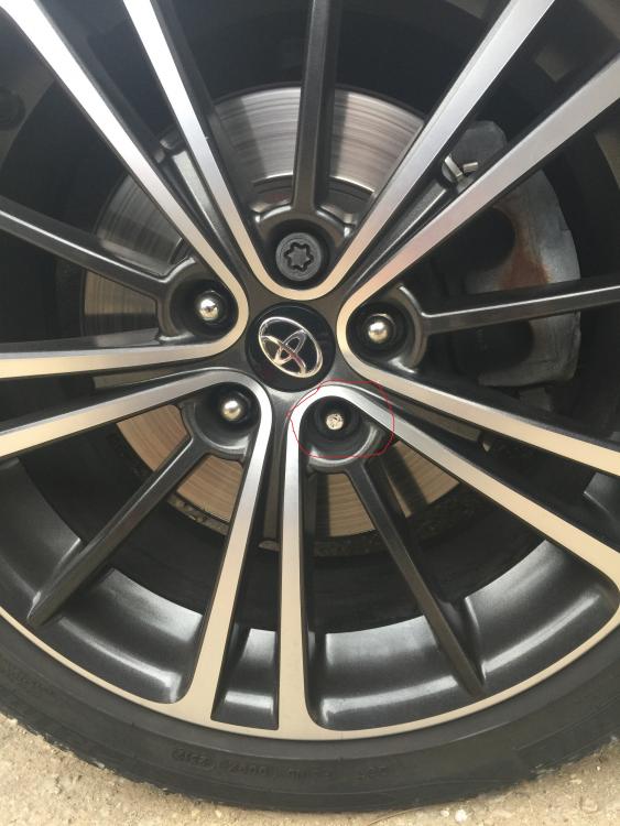

This morning i jump in the car, drive to the Train Station to pick Colleague up. Upon waiting for his train to arrive i go through the Invoice etc and pull the Log Book to check its been stamped....... Well what do you know no stamp, Ok no big deal i have the invoice and can pop it to get the book stamped. Today i had a business meeting in Wantage 34 miles each way, on my way home from Wantage about mid way my front right tire starts making this really weird knocking noise and the steering went all funny. I called Toyota to find out if i can bring the car right away due to the noise doesnt sound very safe. I was denied the option to do this due to the Mechanics leaving at 5pm, So i continued on home with the noise getting progressively worse. When i arrived home i pulled into my garage to use the handheld LED light to see if there is anything visible going on.
I have attached a picture with what i found....... Literally all the wheel nuts i unscrewed by hand!!!!!

Well first of all, log books don't need to be stamped as Toyota have a record on their system (If it's any consolation I haven't had mine stamped for any of mine yet even if they haven't been done at Toyota because I keep forgetting to take it with me haha.
Also you're meant to tighten your wheels after some miles if they have been off anyway, though if one is missing now? Sounds like they missed one, though I had a similar noise after putting my wheels back on and I could literally undo them with my hands but after tightening them they were fine.
@rob275 You are telling me less than 12 hours after a service i should be checking my wheel nuts?? Its not like i just did the nurburgring.
I would expect a higher quality of service from a dealership sorry....
@Nicebiscuit I have sent them an email and will follow up with a call tomorrow, there overall service has been pretty poor TBH.
Considering you're meant to tighten them 50 miles later and your journey was 34 miles and the issue occurred midway on the way back yeah, perhaps you should have. I'm not saying they have tightened them correctly or not though. Only you can tell that, your best course of action is to speak to them.
As above, check your wheel nuts ASAP after any mechanical work being carried out. It's one of the reasons I carry my breaker bar in my car at all times
Wheel nuts can come undone very easily, and yes it's more than likely that they just whizzed them on with the gun and forgot to tighten with a torque bar, but it's your responsibility to check in my opinion. I've learned the hard way when I was test fitting wheels on a car years ago, thought I'd done everything back up and had the wheel fall off on my just a mile down the road
Whenever the wheels are taken off, check them yourself ASAP

If that wheel has been driven loose it needs inspecting for any damage, eg elongation to  the stud holes and the hub studs. Not just torque it up with a new nut.
I agree that the wheel stud holes etc should be checked. I had the same thing happen on my GT4, banging when turning left, 2 nuts almost off and others so loose I could turn a couple of times! Other side were also loose but not as bad. Just had work done by garage, wheels put back on by trainees. I was advised to check wheel holes for elongation and luckily OK. I have always been advised when having tyres changed to check wheel nuts no later than 30 miles.
