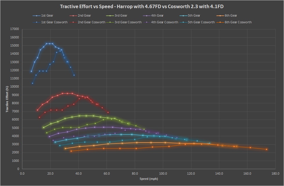

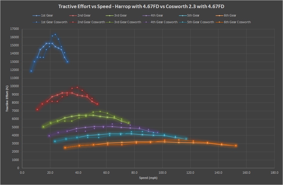

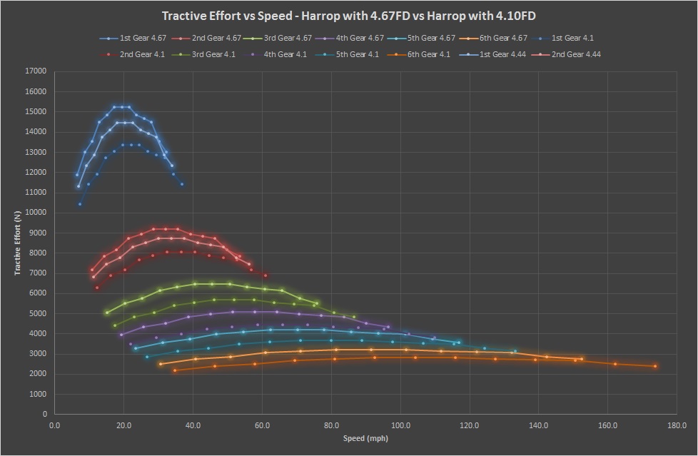

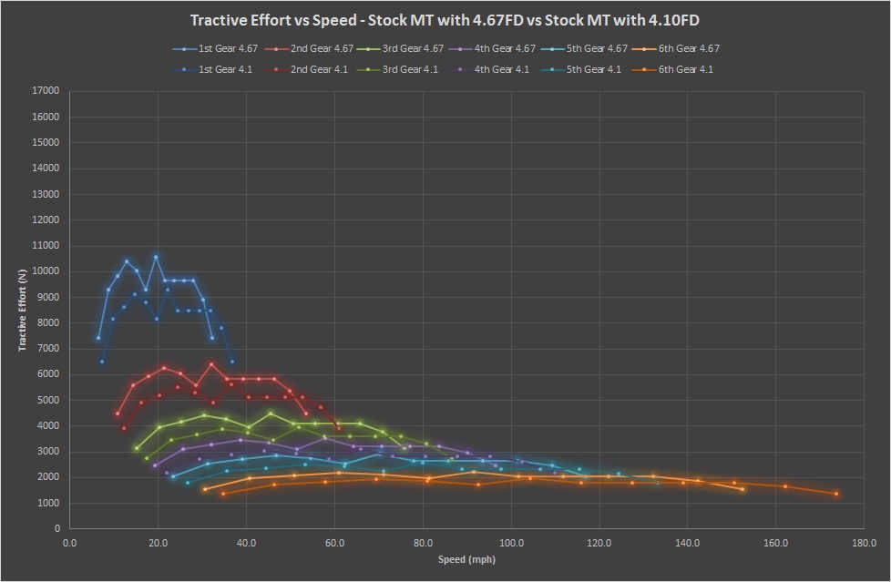

What I'd be interested in is seeing graphs of just the Harrop 4.1/4.44/4.67. The top graph suggests that 3rd-5th gear there is little in it between 4.1 and 4.67 but then the Cossie has a little extra torque at the top end based on the dyno plots.
As requested.....I've only added 1st and 2nd Gear for the 4.44 as the trend is obviously the same in all gears. I've also done a 4.1 vs 4.67 comparison for Stock NA with the same y-axis and a rescaled y-axis so we can't be accused of hijacking Mike's thread :)

Agreed, its all "horses for courses", I spent a lot of time playing about with my various spreadsheets before deciding that the 4.67 would be fine for how I use my car, but its definitely not a "no brainer" mod for everyone.

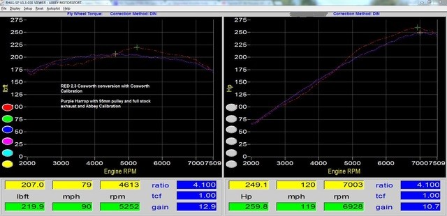

The two graphs are based on Abbey dyno plots for the Harrop and Cosworth with different final drive combos.
Mine will be about 10hp down on the full 2.3. Depending how good my engine is I could be similar to the Harrop. Cosworth has two engines which were 10hp different on their engine dyno.

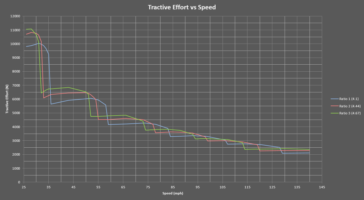

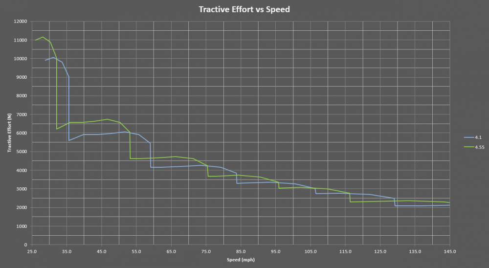

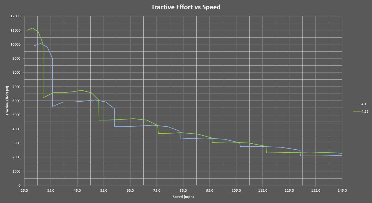

I'm considering final drives for my next year upgrade plans. Still not 100% sure on which (if any), So I knocked up some numbers based on @DanJ's spreadsheet above. The graphs show tractive effort vs speed for three different final drives on a stock MT car, where you shift at redline.
Some interesting things are evident. One is that a stock FD is much quicker 50-60 than a 4.67. The later upshift really helps out there. In fact there's a lot more ranges of speed where the stock FD is better than I'd anticipated. I was thinking 4.67 was the way to go, but I'm thinking 4.44 might be a better bet now.

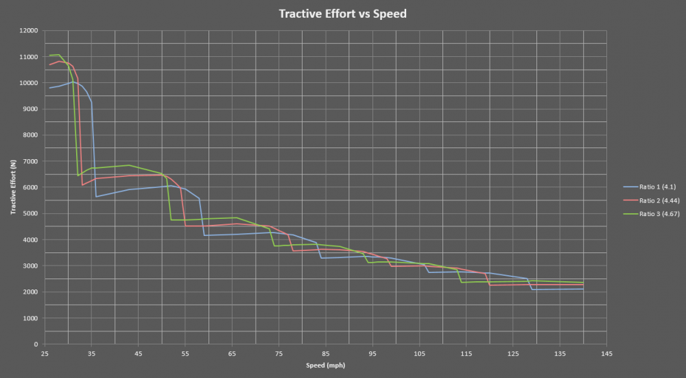

33 minutes ago, Varelco said:
Can you stick 4.56 on there? I'm thinking about getting the Weir Performance FD although its only obtainable from the states its half the price of the Mfactory.
I did have it on as well but it got a bit busy. It's between the red and green lines.
EDIT: Here's stock vs 4.55:
