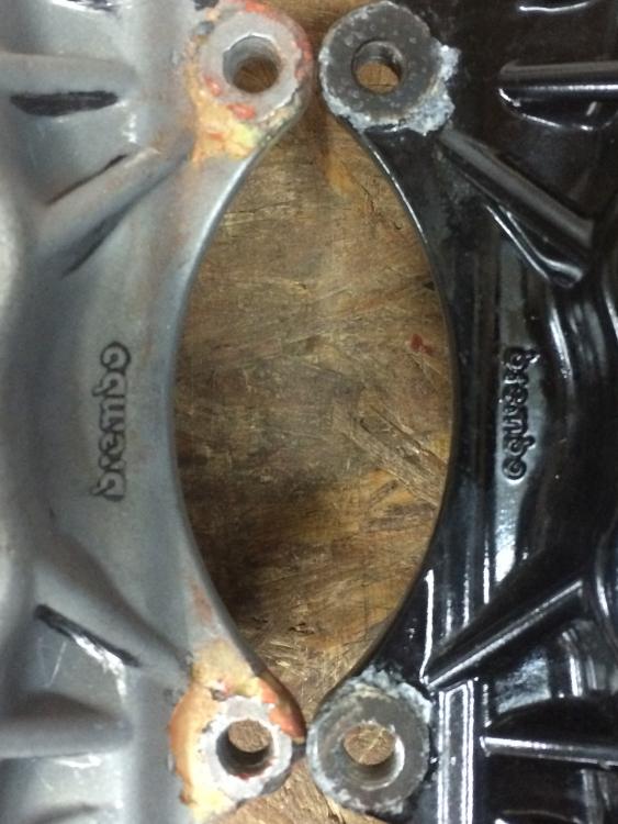

smudge 1020 Report post Posted February 10, 2016 @DanJ I don't think the front Brembo's will fit? The front hubs match Impreza's up to 2007 and the rear is 2008+ Have you checked to see if they fit? Or had new brackets made? Share this post Link to post Share on other sites
DanJ 374 Report post Posted February 11, 2016 @DanJ I don't think the front Brembo's will fit? The front hubs match Impreza's up to 2007 and the rear is 2008+ Have you checked to see if they fit? Or had new brackets made? You've got me worried now! From the web ferreting I did beforehand I was sure Fronts up to 2012 and Rears 2008 on fit without brackets. Will find out if I'm cursing myself for not trial fitting before sending them out for refurb, I'll just mill up some brackets at work if I'm wrong though. I am also having the bleed nipples swapped as part of the refurb, that one I've definitely got right! Sent from my Nexus 5 using Tapatalk 1 Jord104 reacted to this Share this post Link to post Share on other sites

smudge 1020 Report post Posted February 11, 2016 2 hours ago, DanJ said: You've got me worried now! From the web ferreting I did beforehand I was sure Fronts up to 2012 and Rears 2008 on fit without brackets. Will find out if I'm cursing myself for not trial fitting before sending them out for refurb, I'll just mill up some brackets at work if I'm wrong though. I am also having the bleed nipples swapped as part of the refurb, that one I've definitely got right! Sent from my Nexus 5 using Tapatalk Hey Dan, Sorry mate, but I'm almost certain the fronts are up to 07... Feel free to prove me wrong and I hope you do! But it's what I researched when I got my AP Racing's on the front and then the Brembo from the 08+ on the rear Share this post Link to post Share on other sites

DanJ 374 Report post Posted February 11, 2016 2 hours ago, DanJ said: You've got me worried now! From the web ferreting I did beforehand I was sure Fronts up to 2012 and Rears 2008 on fit without brackets. Will find out if I'm cursing myself for not trial fitting before sending them out for refurb, I'll just mill up some brackets at work if I'm wrong though. I am also having the bleed nipples swapped as part of the refurb, that one I've definitely got right! Sent from my Nexus 5 using Tapatalk Hey Dan, Sorry mate, but I'm almost certain the fronts are up to 07... Feel free to prove me wrong and I hope you do! But it's what I researched when I got my AP Racing's on the front and then the Brembo from the 08+ on the rear What do you think is different? I'm sure the refurb place will have plenty of other Brembos in so I can ask them to take some measurements and either make me happy or pissed off with myself for not trial fitting! Sent from my Nexus 5 using Tapatalk Share this post Link to post Share on other sites

smudge 1020 Report post Posted February 11, 2016 1 hour ago, DanJ said: What do you think is different? I'm sure the refurb place will have plenty of other Brembos in so I can ask them to take some measurements and either make me happy or pissed off with myself for not trial fitting! Sent from my Nexus 5 using Tapatalk The fitment on the brackets is different so they won't bolt onto the hub I might be wrong, but I'm 95% sure it's up to 07 before they changed it Share this post Link to post Share on other sites

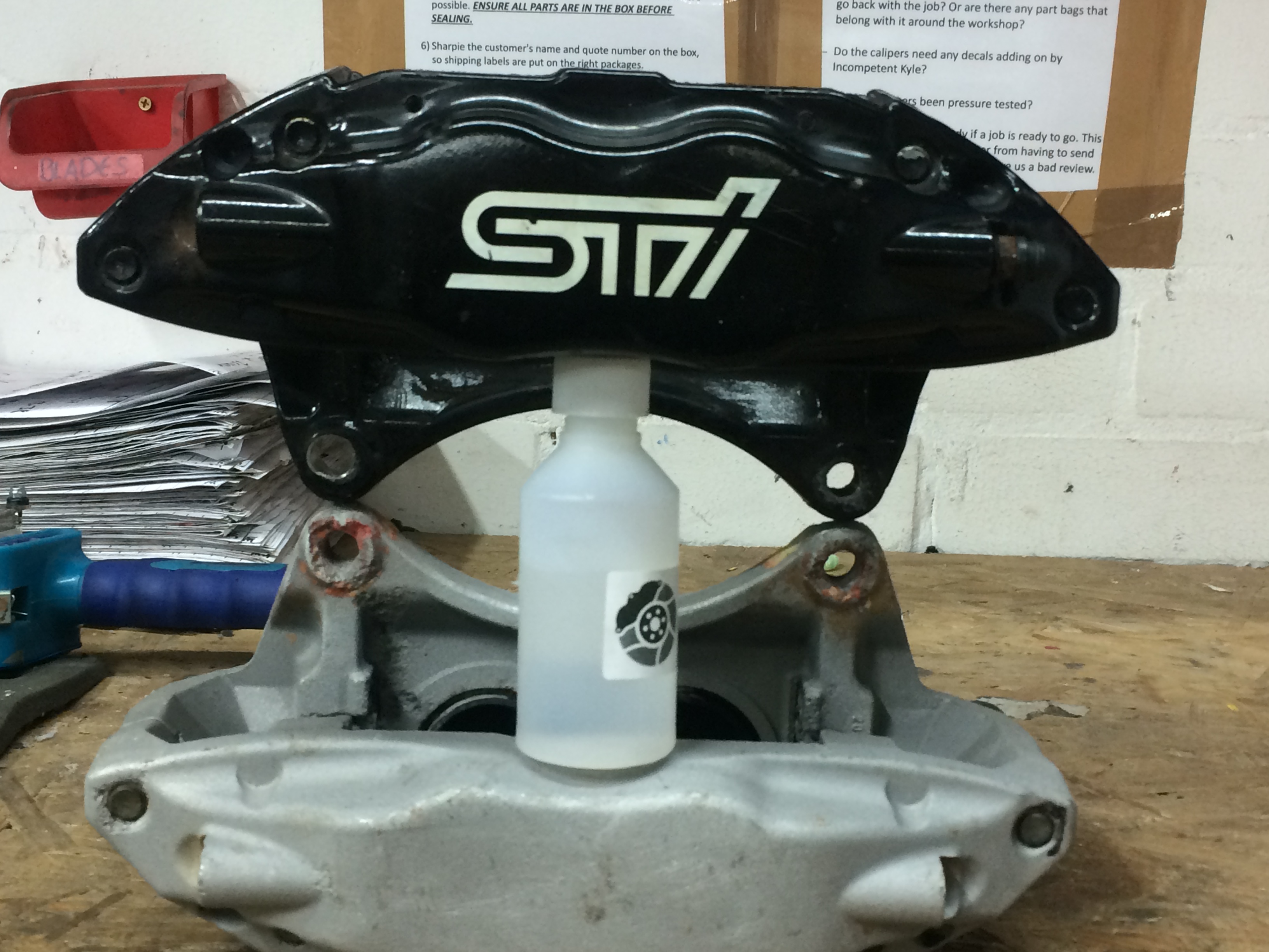

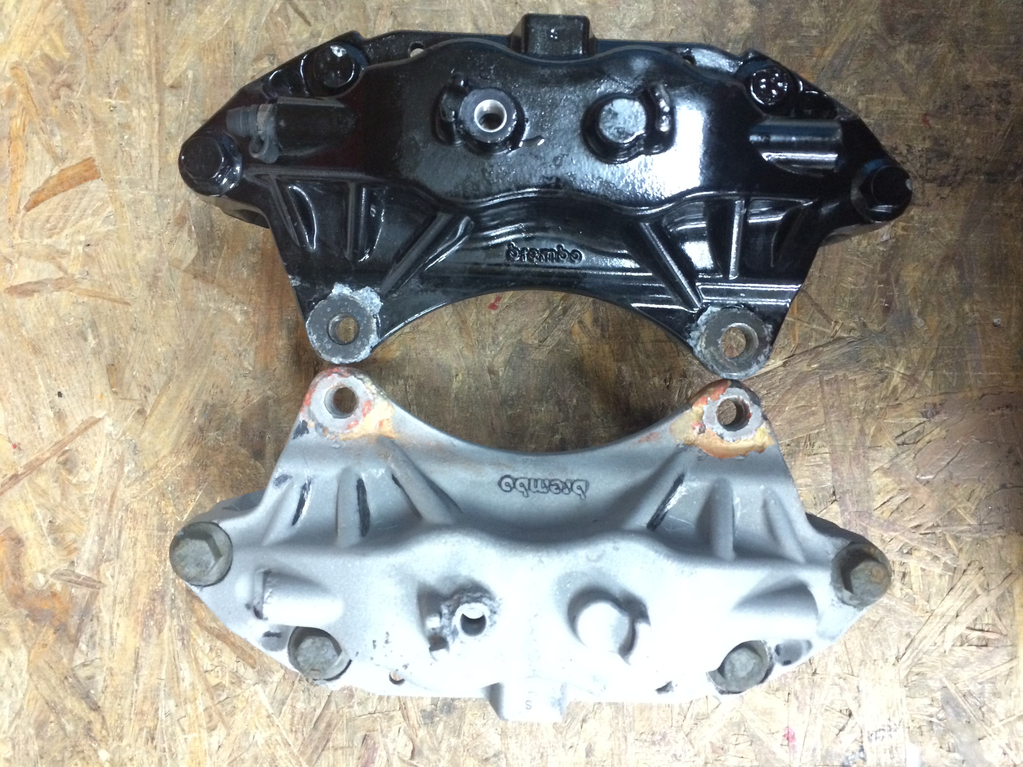

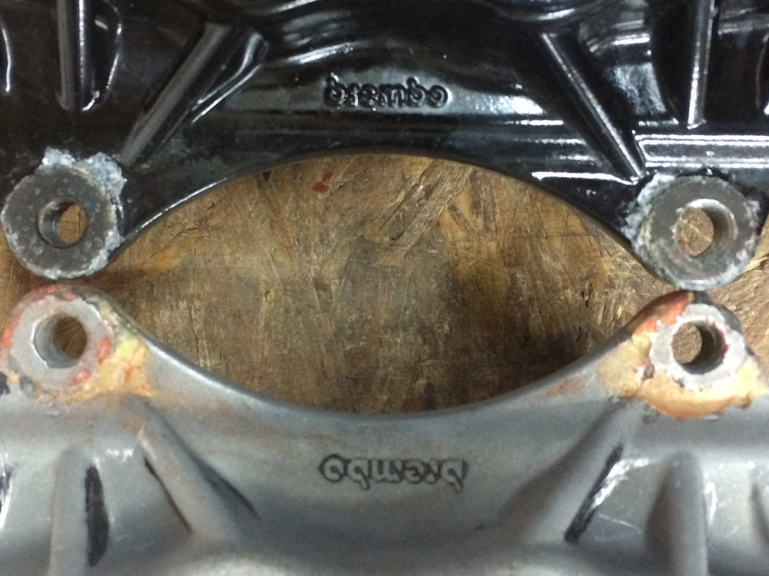

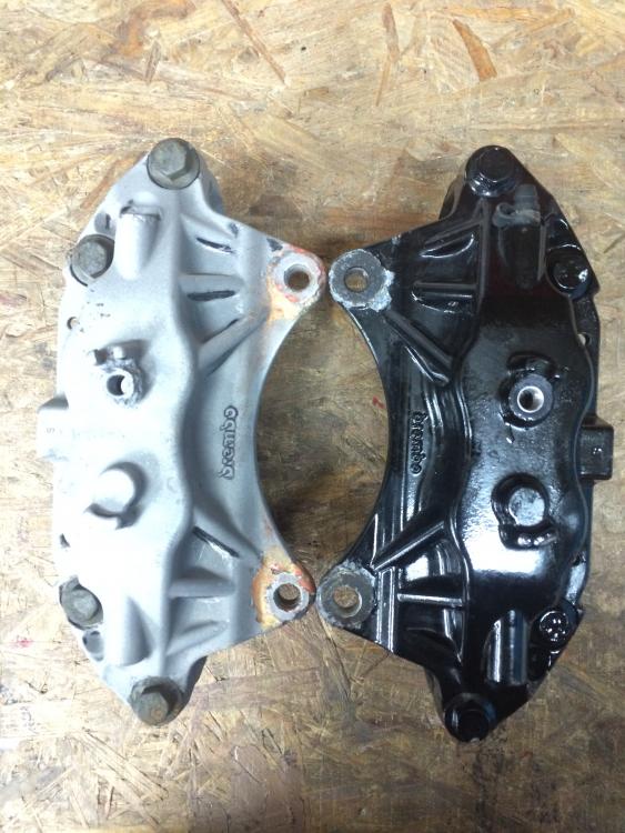

DanJ 374 Report post Posted February 12, 2016 Phew, I've just been sent some pics of my calipers next to ones from a 2004 Scoob they also have in for refurb......they're identical. Sent from my Nexus 5 using Tapatalk Share this post Link to post Share on other sites
smudge 1020 Report post Posted February 12, 2016 7 minutes ago, DanJ said: Phew, I've just been sent some pics of my calipers next to ones from a 2004 Sccob they also have in for refurb......they're identical. Sent from my Nexus 5 using Tapatalk Not on about the calipers bud, it's the mounting brackets you need to make sure will fit Share this post Link to post Share on other sites
DanJ 374 Report post Posted February 12, 2016 That's what I meant, the mounting lugs on the calipers are identical spacing and location, I'll post up some of the pics later when I'm not on my phone with a rubbish connection. Sent from my Nexus 5 using Tapatalk Share this post Link to post Share on other sites
DanJ 374 Report post Posted February 12, 2016 The already blasted caliper was originally gold with red logos and from a 2004 Impreza, the black one are my 2010 calipers. Share this post Link to post Share on other sites
smudge 1020 Report post Posted February 12, 2016 Fair enough! Share this post Link to post Share on other sites
