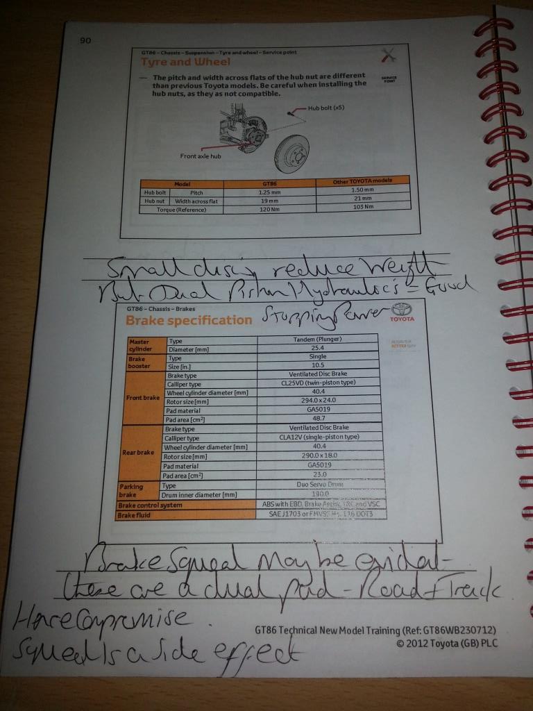

Attached are some notes from Toyota UK technical training given to UK technicians.
Sorry for the poor handwriting but is says:
"Brake squeal may be evident, these are a dual pad - road + track. Hence compromise, squeal is a side effect."
